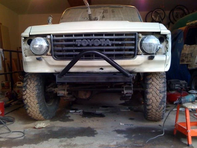

This is my cheap and simple front bumper solution. Nothing fancy by any means. 3x3 square and 1 1/2" tube.:)

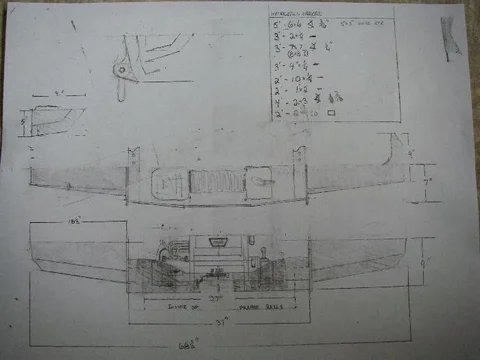

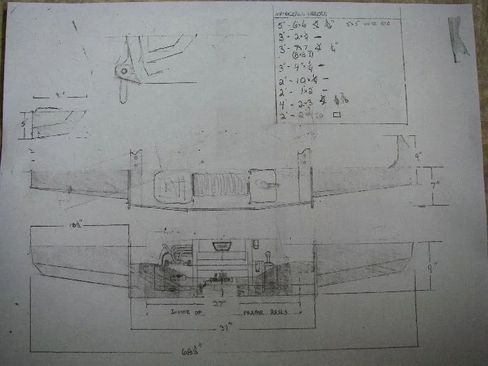

Here's a drawing of a bumper I plan on building for the 62. I havent acually built it yet so it more than likley needs some tweaking but it's something to look at:D:cheers:
Damn, batman's got some drafting skills. :cool: Looks nice, can't wait to see the built pics. :cheers:
