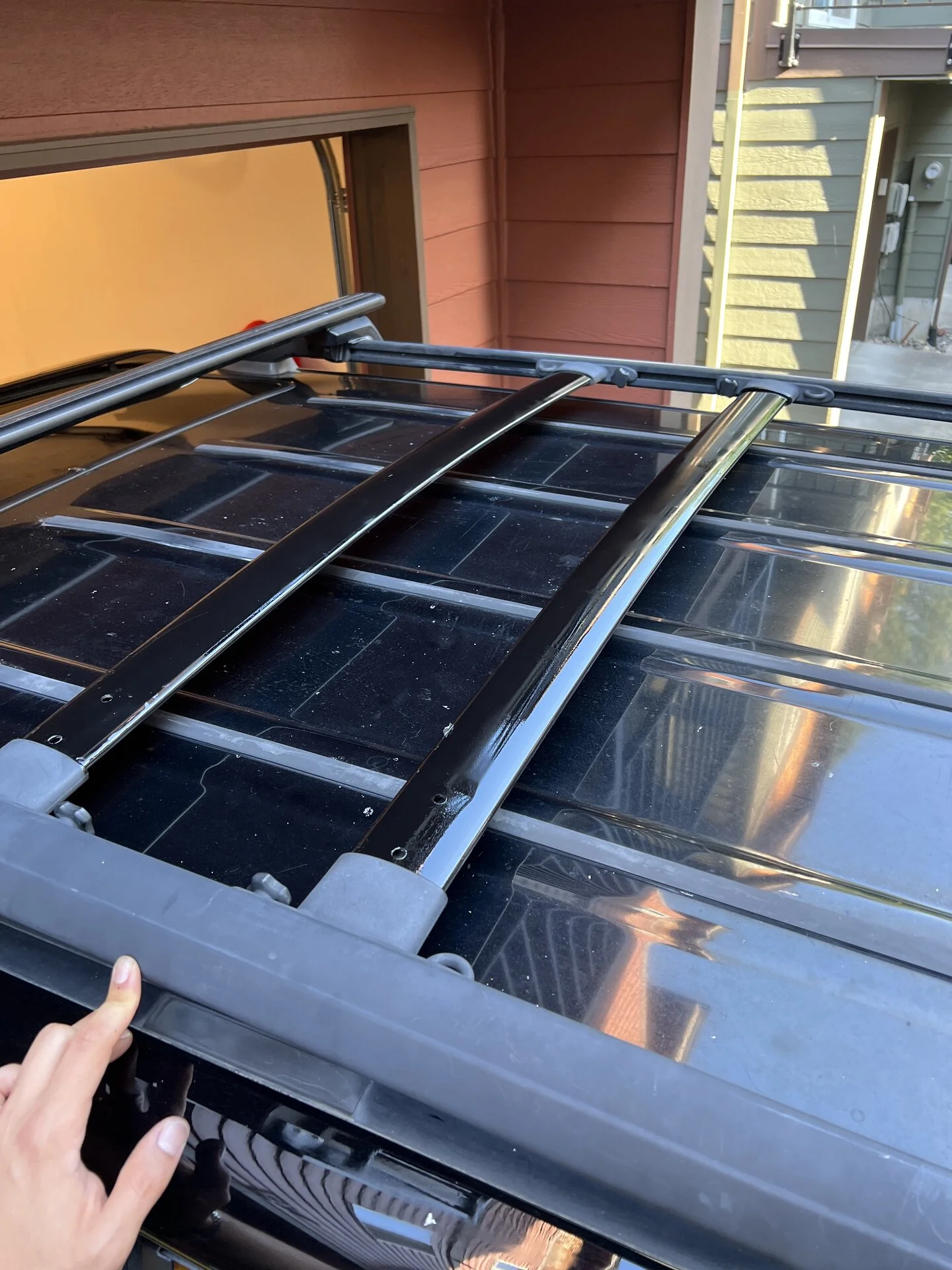

1. I wanted to keep the Thule Roof Racks - I think they are much more versatile (for my use case) than a full roof rack because I only have a rtt, kayak, or surfboard on there anyways.

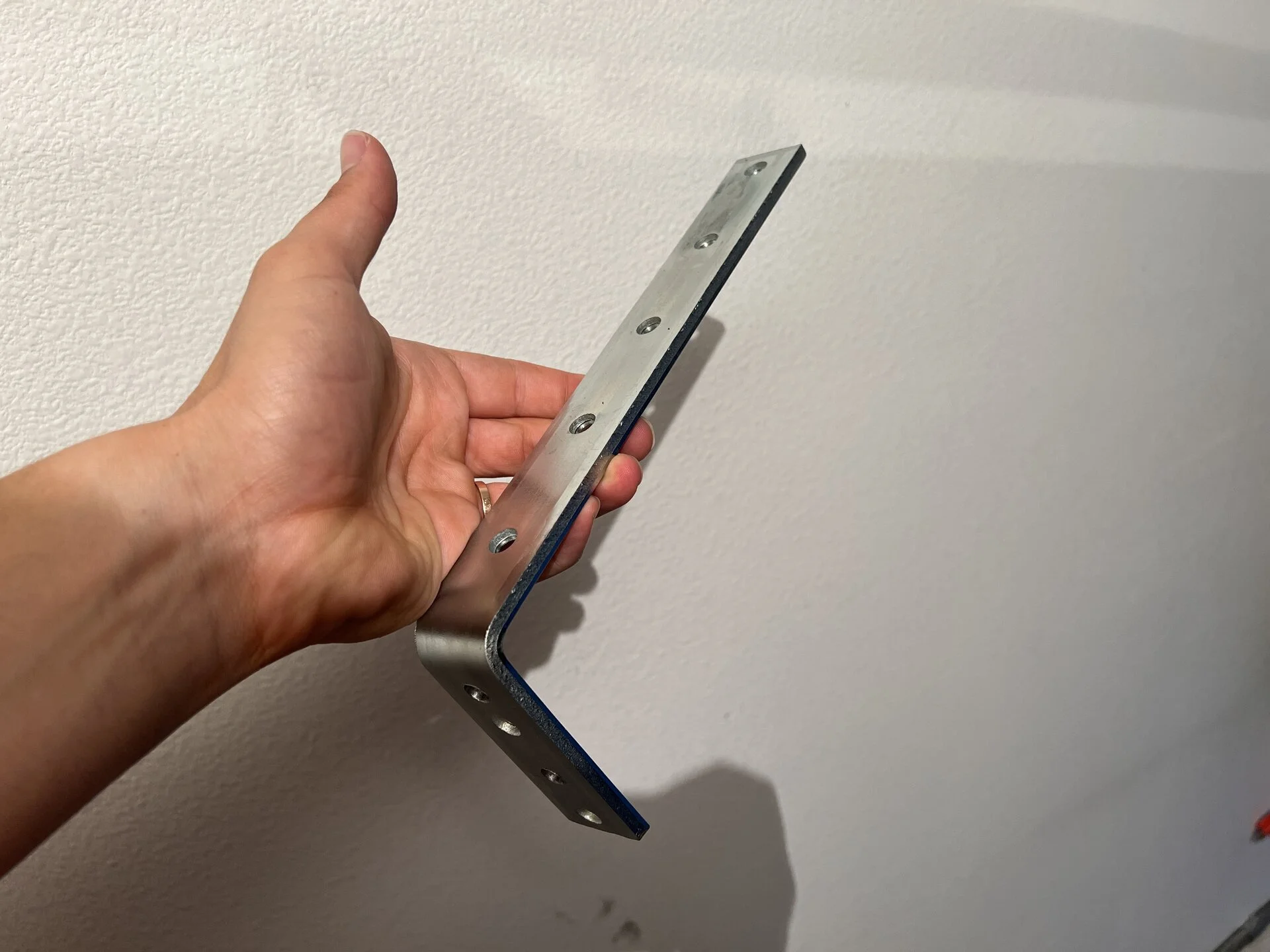

90 degree 3/8ths steel brackets (2) - $11 Each at Ace Hardware

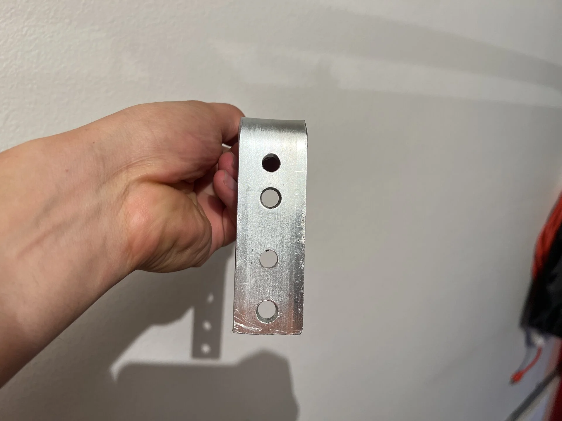

1. Measure what the holes will look like for your awning. You'll want to go as high up as you can to get as much clearance from the door. The standard holes that it already had didn't measure up.
2. Trim so you have .5 inches from the bottom of the lowest hole of your awning mount with the angle grinder. I ended up and going back and trimming more from when I took the pictures.

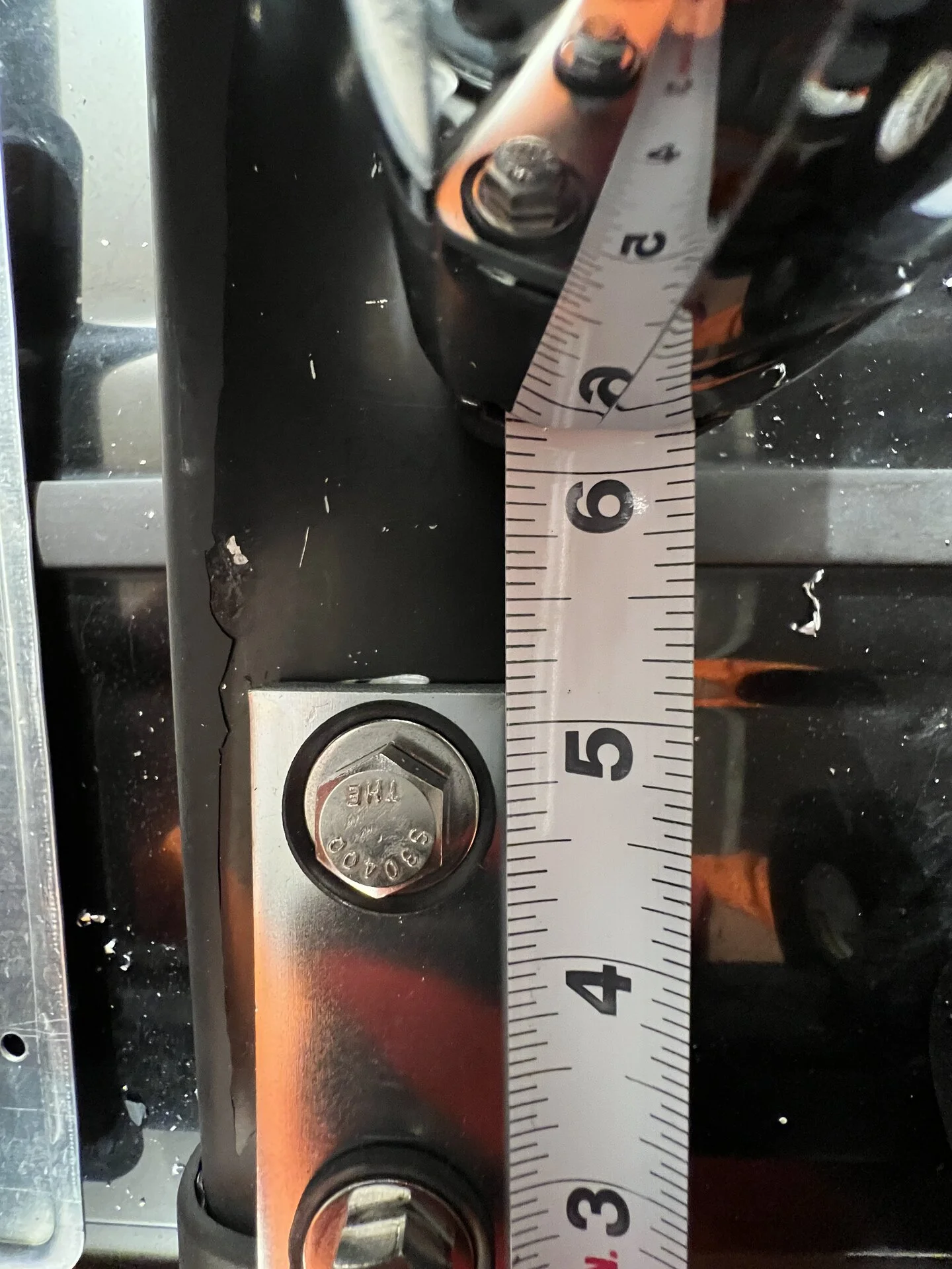

3. Clamp the bracket to the cross bar. Make sure to give enough space for the the awning to stick out. I measured 5 1/8" from the base of the cross bar

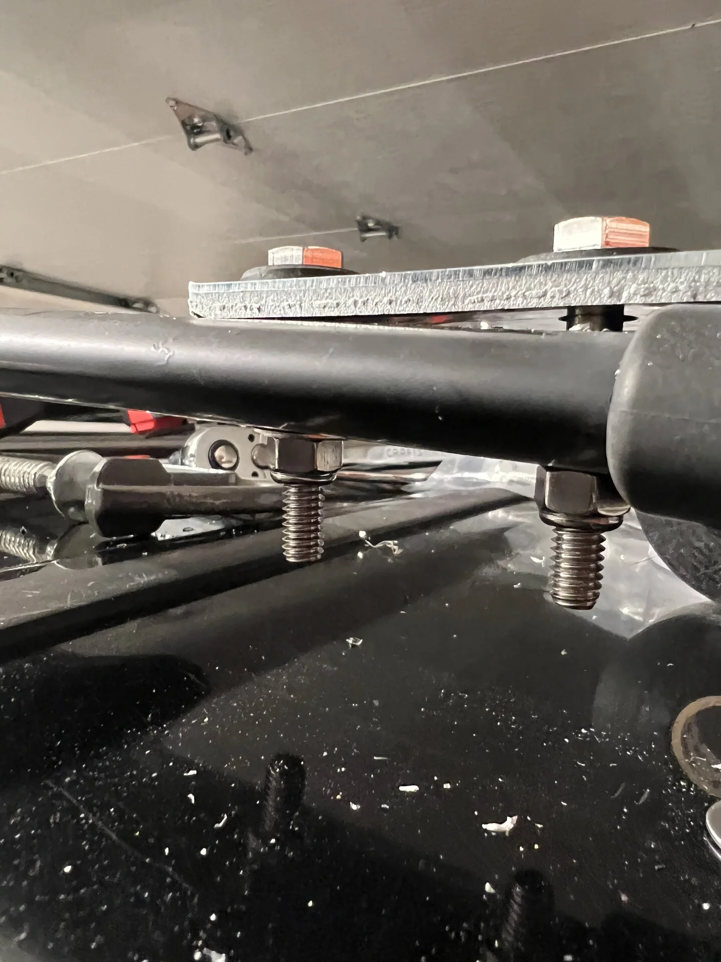

4. Start Drilling! I Made two holes. You'll want to be mind full that the bracket that holds the cross bar extends further than the top, so make sure you'll have space for the bolt to pass.
5. Install the bolts

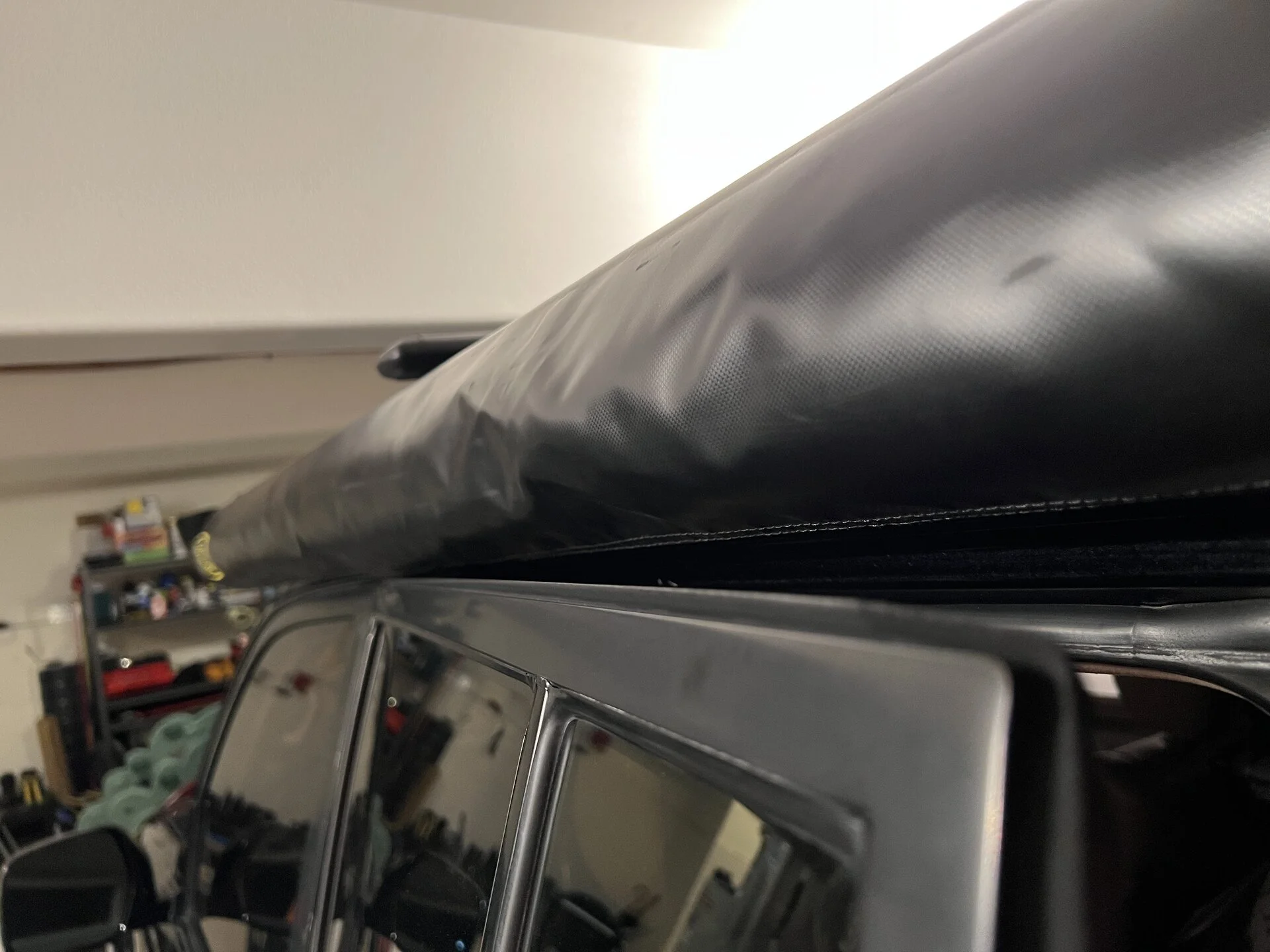

6. Measure up the awning to check fitment
