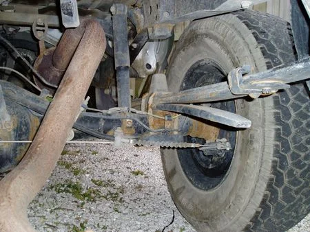

hey erin and lance how are you guys i believe we met at the nasty flat right? well my sister gave this to me and now i'm 400.00 into the frame man. i'm told that the right rear wheel has a wobble to it and looking to fix but haven't a clue yet where to start.
Were you at Flat Nasty also? In the 60? So is the wobble in the wheel (probably not as it looks like it was replaced)? Maybe the leaves have shifted (more likely), and the solution may be new leaves, or realign the rear. What does the rear shackle look like, and the front hanger for that leaf pack?
The other problems (which I would replace irregardless) are the rear wheel/axle bearings (semi floating rear) and both inner and outer axle seals. This would also give you an opportunity to check the right rear axle shaft and make sure it's not tweeked.

Lance says he thinks that the wobble could be because the axle flange is bent. Just a guess off the top of his head. Also, if you have any interest in selling it, let us know. Or if you want any parts, he's selling his '98 back to Toyota cause the frame's got a big hole in it. He's got fender flares and a locker that have just been sitting in the garage. Not going to put them on now....

Wow, pictures tell the story. So did they straighten the rear frame where it was tweeked? Can still see the buckle in the last pic. If they did straighten it, this would be the time to box as much of the area as possible because it's weakened, maybe add in a rear most crossmember. Looks like there's a little exhaust work also :D
well i cut the exhaust off just before the major bend and it sounds and smells just fine. i have to take it back when the newer springs and right size wheels are on for a tweaking. so says the frame man. the frame shop was recommended by a friend that only took $ and he dose all the work for this buddy of mine that only works on 30-50s rods that get shipped here.
thinking about going the old man emu route for the front using there springs and shocks any thing better out there for the price? i need all the help i can get.... thanks to lance i've got a set of deavers in the rear with a set of downey shackles and bilstein shocks... still waiting on a bushing from toyota for the shackles tho...
