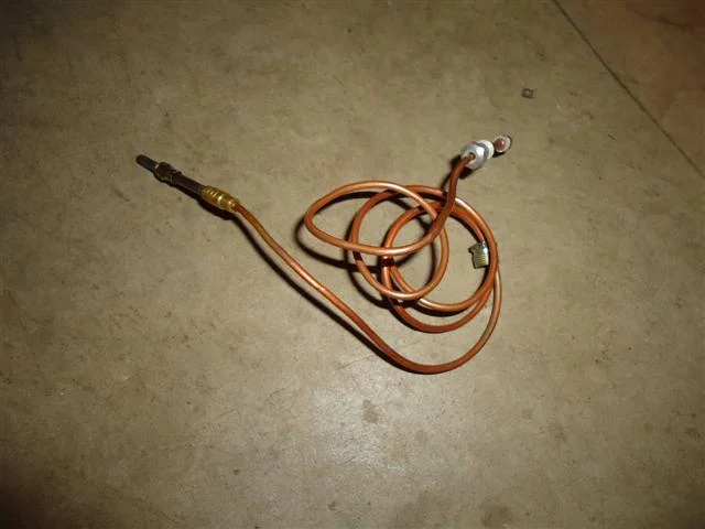

first pic is of the piece in question... thermocouple??

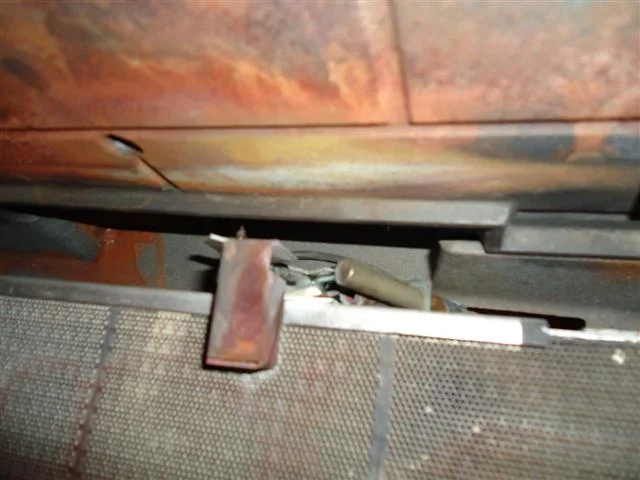

second pic is the pilot assembly... the other end of the copper piece was placed at an angle up from the left so the end would be right there in the pilot flame.

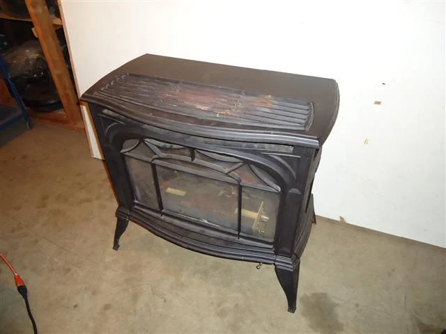

third pic is overview of what I'm working on... seems like a nice unit - solid cast iron and a heavy SOB

This piece is not shown in the manual for the stove... assuming someone added it, what is it and why? And can I run the thing without it?

I have something similar on my hot tub heater. It is a thermal couple that will automatically shut off the gas at the control head if the pilot light goes out.
It is a thermocouple. It generates a small electrical current when heated by a flame of a pilot light and/or main burner. If the pilot light goes out, the absence of electric current causes the valve to shut off the flow of gas.

curious though why the manual doesn't show or mention it... this appears to have been added later
maybe the stock one (still there in the pics - round cylindrical piece) stopped working and someone rigged this non-stock part to "fix" things

Your gas valve is a thermopile valve. It already has the thermopile attached (the silver and copper wire on the left side of the front and in the picture with the pilot assembly) Thermopile is like a thermocoupler but generates enough power to operate the gas valve unlike the thermocoupler that just runs the safety lockout. If the unit has a thermopile it won't have a thermocoupler and won't work with one, which is why there's no place to screw it in.
