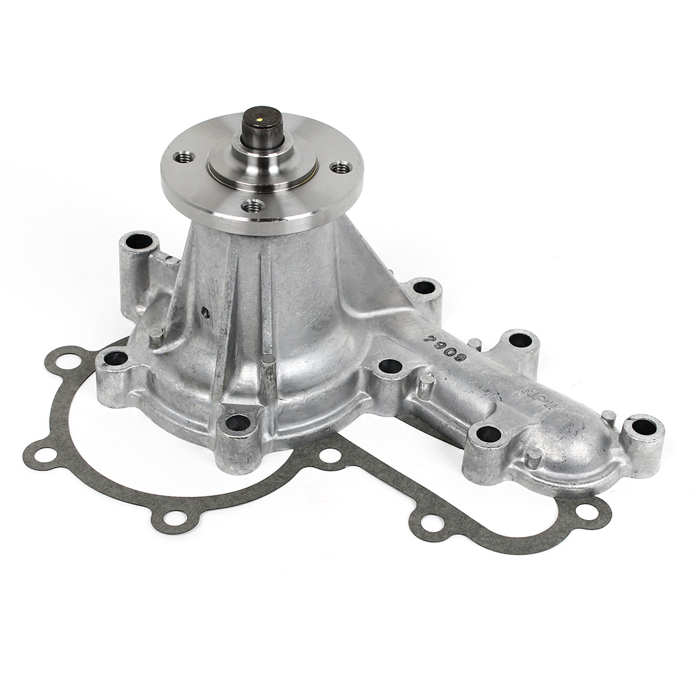

I dont believe an upgrade is necessary, the factory pump works well in the harshest of conditions. Usually the pumps start leaking at 250000-300000klms, Ive had 2 go around then and seen a few others as well. It usually leaks from the weep hole on the pump shaft. This is a type of warning that your pump has a problem. It will keep doing its job for a while, but the bush is worn and is allowing some coolant to escape.
The aftermarkets pump metal rotors have improved in quality but the I think the plastic rotors in the OEM pump look more efficient.
I also prefer the OEM crush gasket over the aftermarket paper gasket, the latter is an awful thing to position with sealant on your fingers and with the engine in the engine bay.
Torque all the bolts properly and use good quality sealant on the alloy bits.

Can you see the weep hole in the water pump? Its that small hole in the middle of the pump. It maybe have a channel to bring the coolant further forward. If they are leaking there is always a drop of coolant around the hole. To make sure wipe it clean and check it after a drive.
