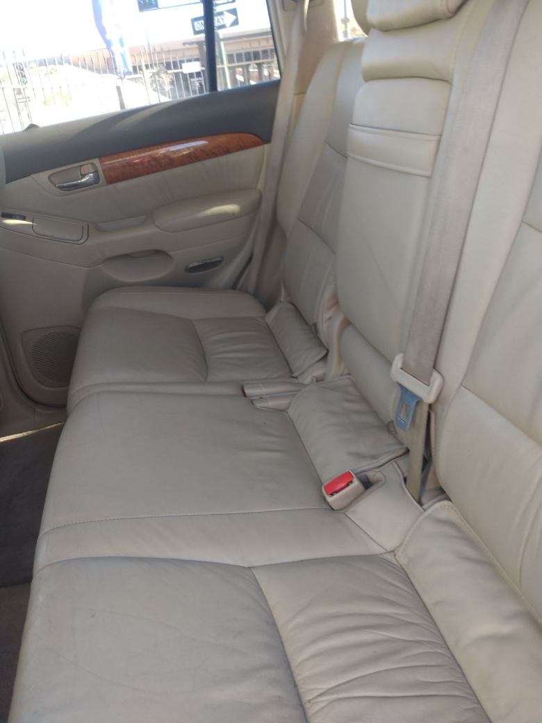

Hey I’m looking for a lil advice. I recently came across a used 2003 GX470 with 211k miles. The dealer is asking $5,500. What i found when test driving the GX airbags no longer function. will need front suspension wheel bearings, ball joints tie rods sway bar and tires I ran a carfax report the timing belt and water pump was last done at 95k. Will need timing belt and water pump. interior in fair condition no rips in leather just worn. Exterior not bad for a 20 year old car. will need a good detail buff and polish. In todays market I can’t find anything near that price but i know i will have to put in some work to get the gx road worthy. What are you thoughts thanks.

Going to be haggling with them today and see if I could get a better deal 😅. GX been a new mexico car it’s whole life no rust underneath or surface rust. 3 owners, 1st owner own till 125k. Been looking at parts for the GX on rock auto. Full suspension refresh around 1k not including modest lift kit 2”. Where can I can find OEM parts online besides going to the dealer. I’m my area i found 04 GX with 230k lift kit, rear locker, and new suspension for 14k. I think I would be making a good choice for 1/3 the price to purchase this GX even if I have to throw 3k into it. I’ll update with the final price. Thanks
