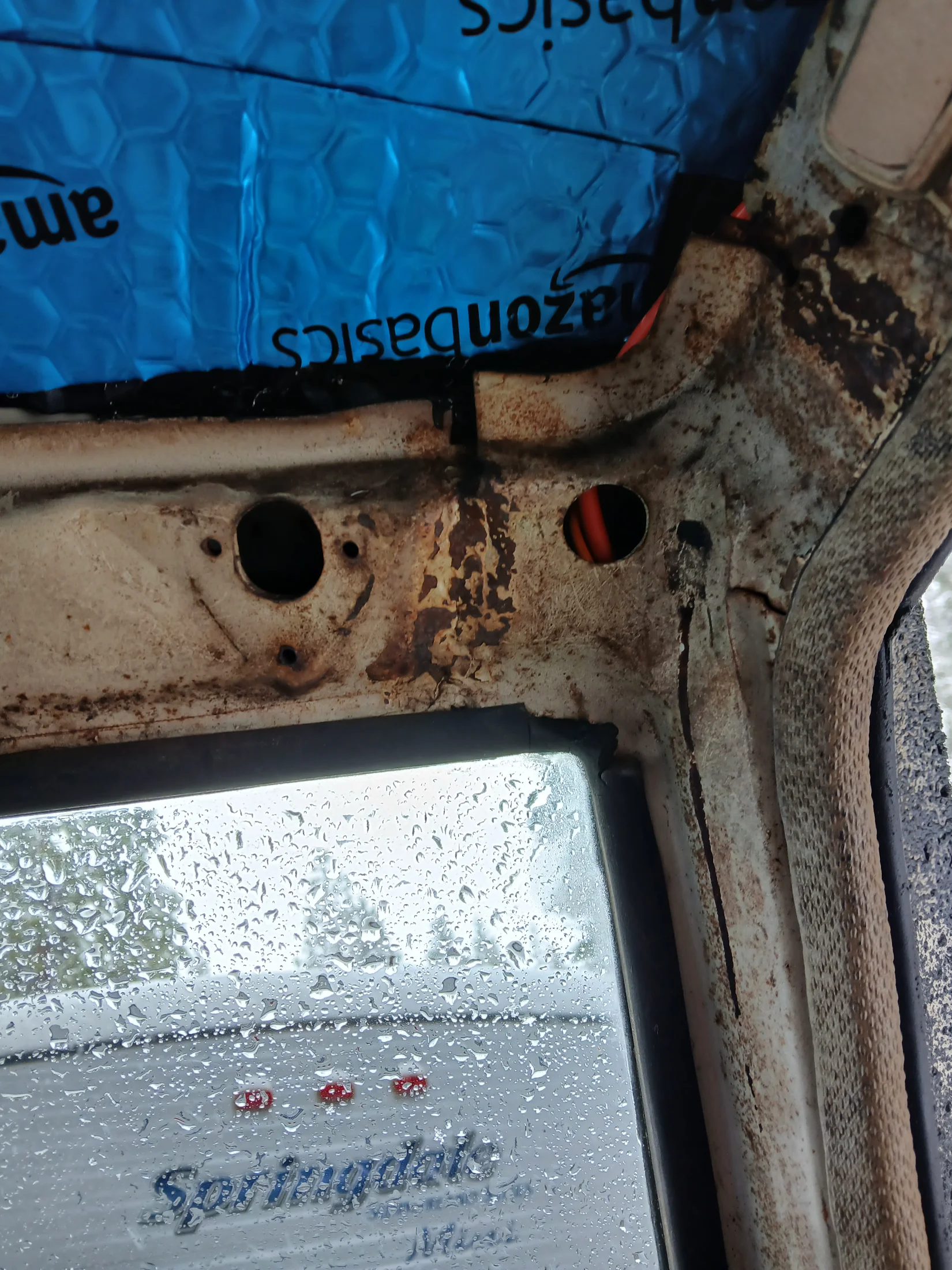

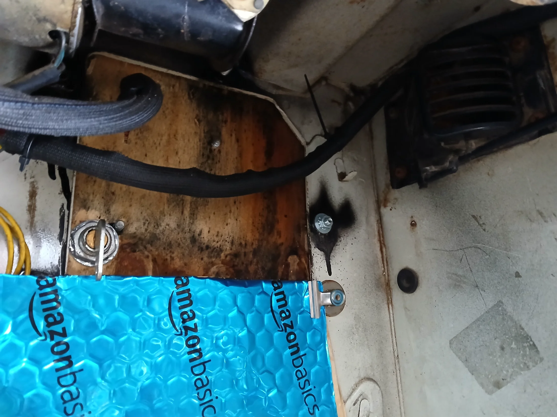

So then the question is - what is the best and most optimal wiring route to get voltage to the rear of the vehicle?
1) Through the firewall and down along the passenger side sill plates
2) Underneath along the bottom of the tub then back through one of the grommets leading into the passenger side rear quarter panel
3) Other?
3) Other; through the firewall, up the "A" pillar, along the roofline above the doors
