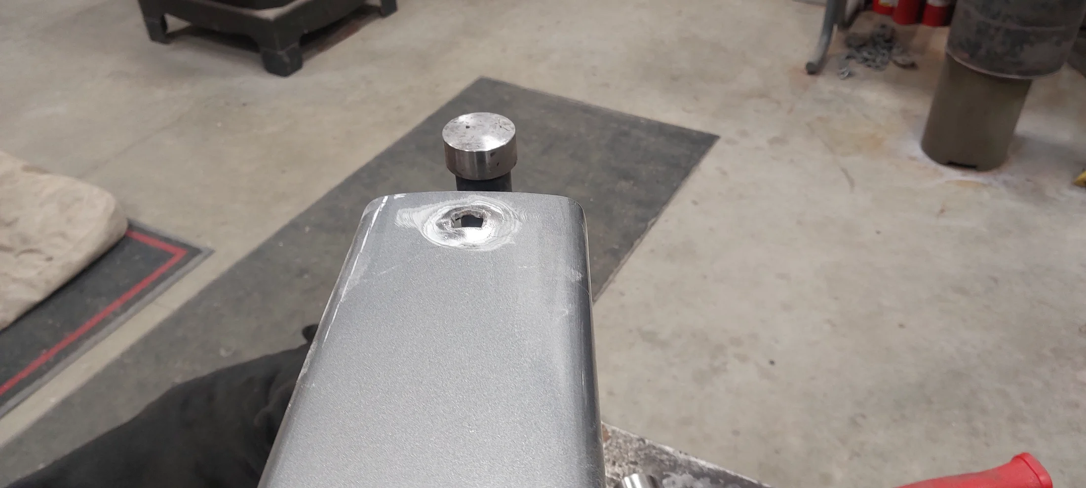

I’m starting out with some minor cosmetic issues while I wait for parts to start showing up. The rear bumper paint was bulging around all the bolt heads and the Pigeater asked me to address it.
I had originally thought the paint was applied a little thick and the bolts tighten a little too tight and this was going to be an easy fix….
But upon further inspection the bumper had been repaired with 1/4" of Bondo around the bolt holes and I was going to have to come up with a way to reduce the amount of compressible material at the holes or it was going to do the exact same thing to me.
You can see it already started rusting under the Bodno.
I made a simple tool out of a carriage bolt by grinding a bevel on the underside of the bolt head to “cone” the metal outward around the holes, I then flattened them down on a little anvil.
I then ground all that down so we’ll have minimal filler under the bolt heads now. I will also use a locking nut so we can tighten everything up just enough without over tightening to prevent the standard nuts from backing off.
