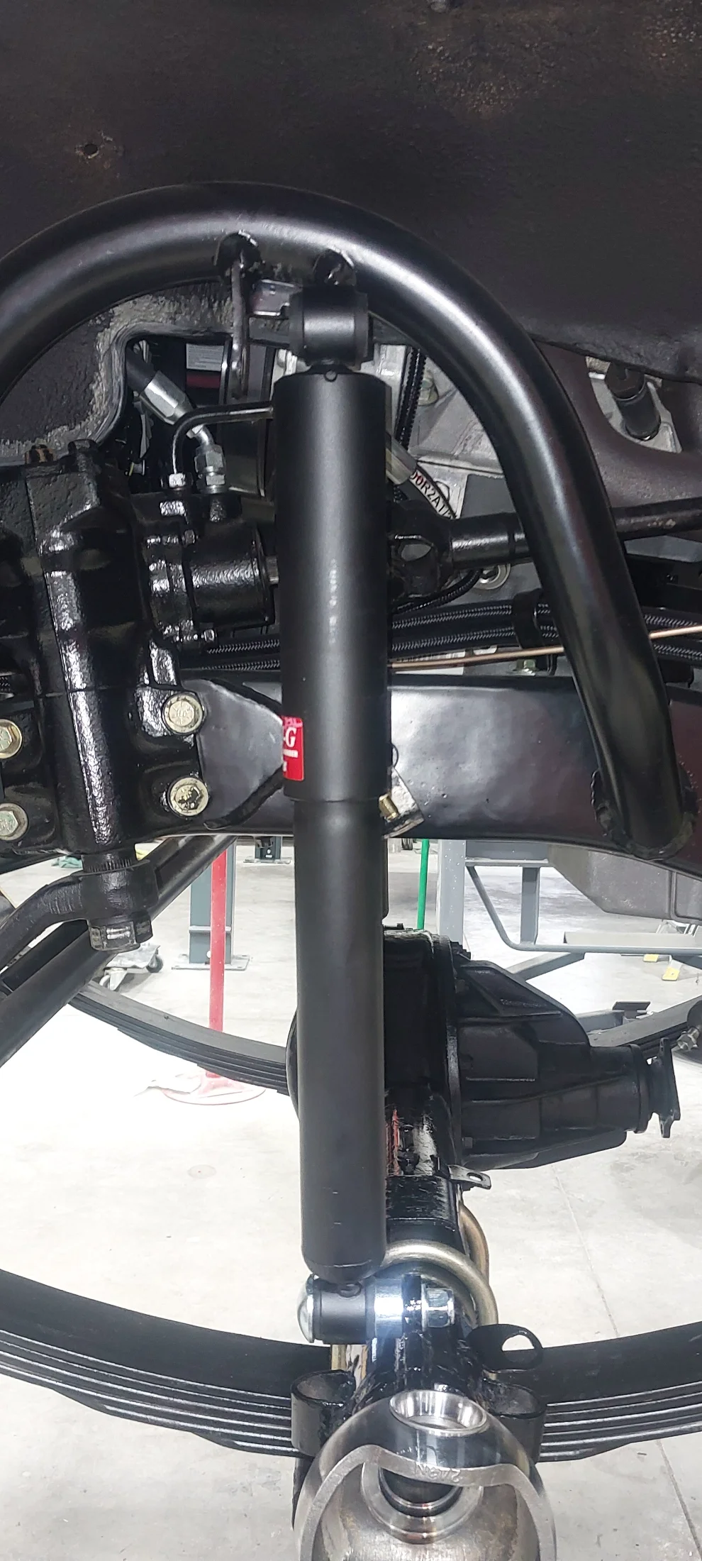

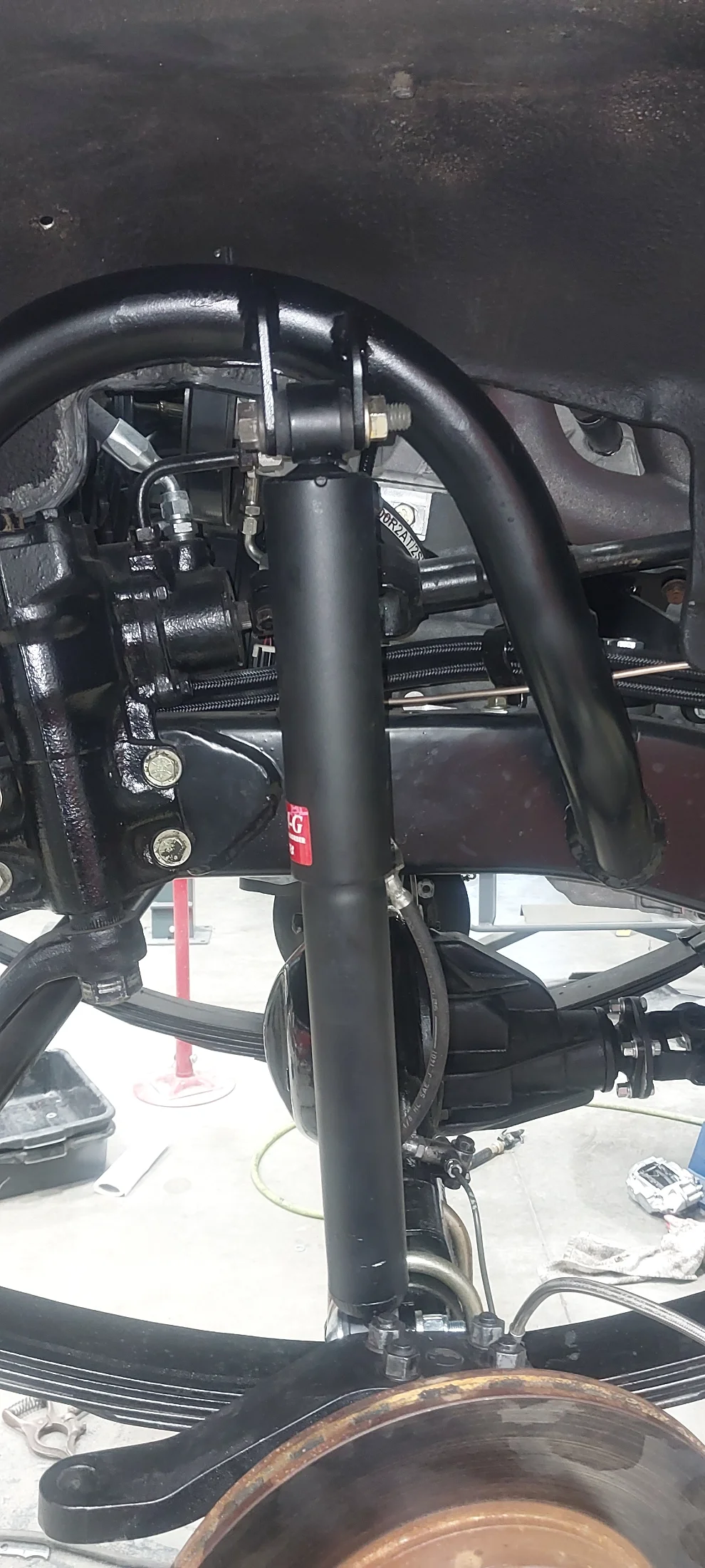

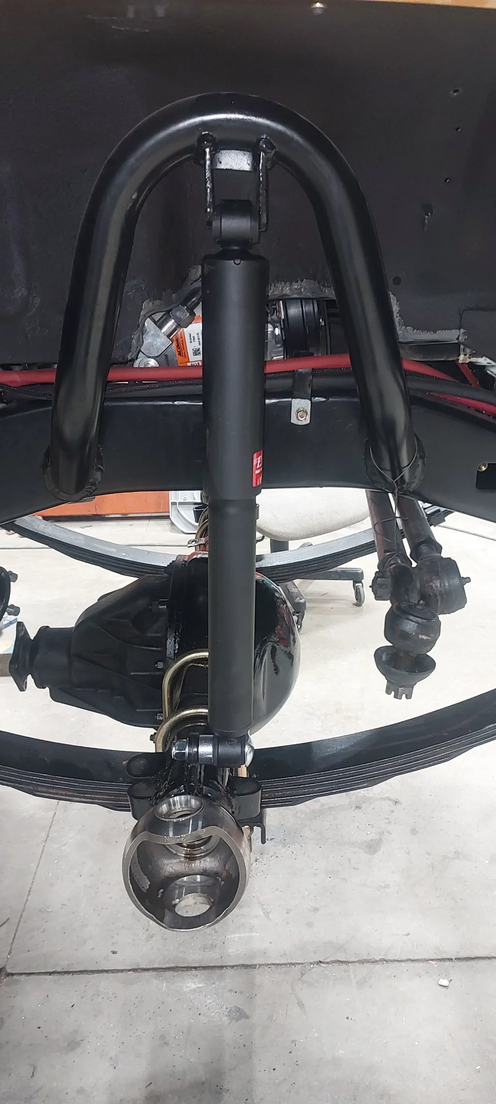

Shocks are mounted at the same angle (straight) and have the same amount of travel now..

7 try's to get the shock tab angles right, all four were completely different.
