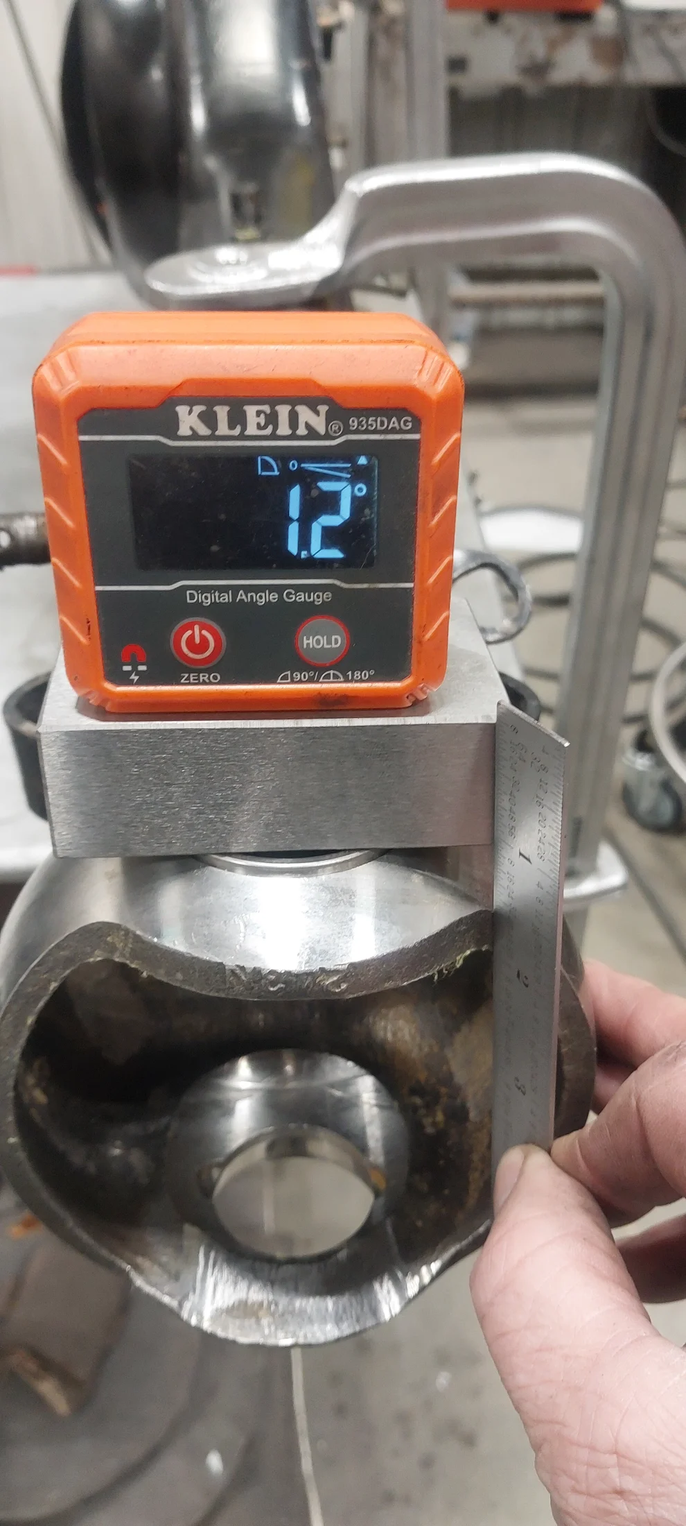

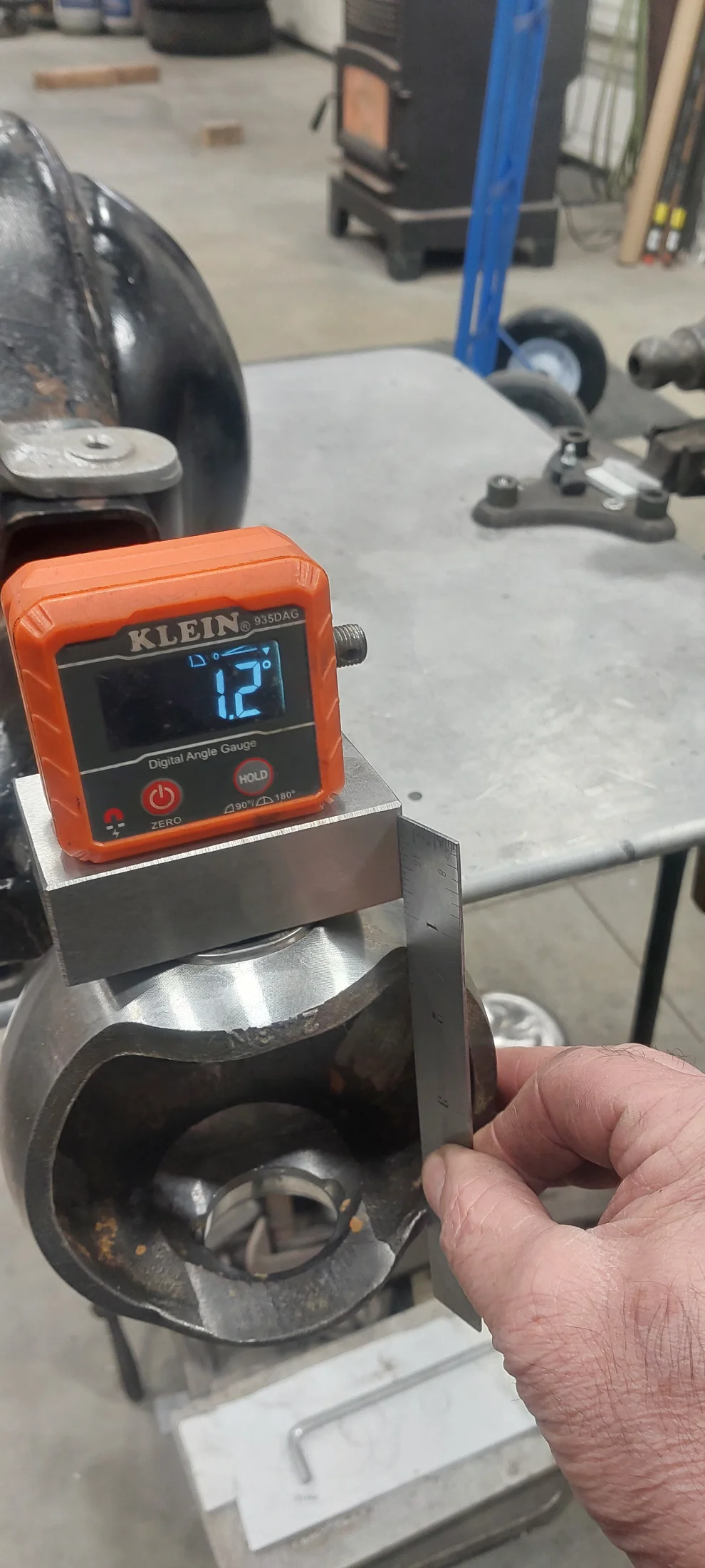

I clamped the housing to a level surface, cleaned a section of the center section mounting surface and noted that angle.
View attachment 4090428View attachment 4090429
I then came up with a way to repeatably confirm the angle that I currently have.

I remember a method that involved using a pipe cutter for changing caster angle, but when I look at those pictures, I can’t see how that would work.
