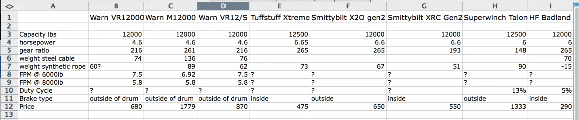

I hope this helps a little.
Maybe someone has some more info to fill in the unknown (to me) data.
