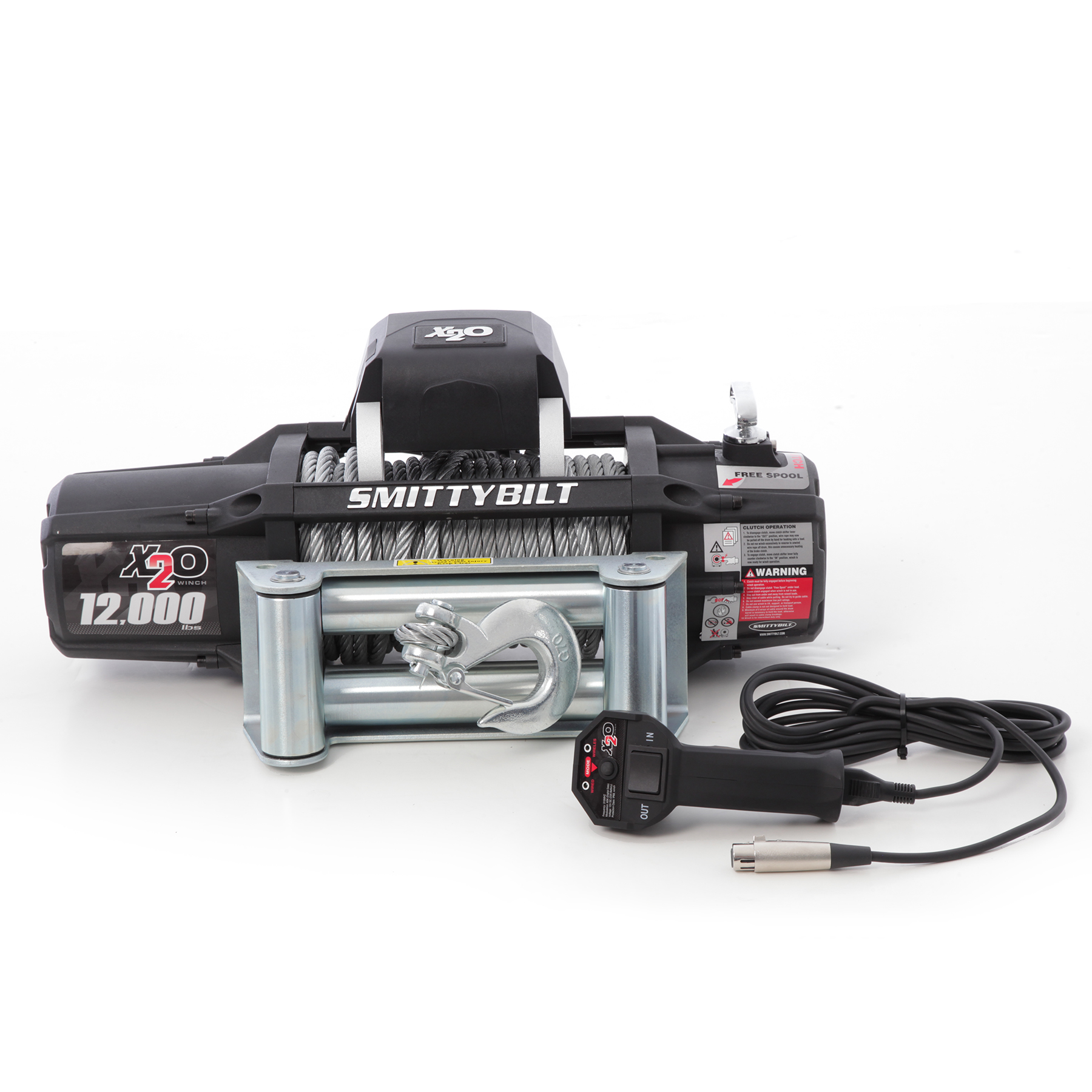

I bought the BADLANDS 12k, it didn't fit in the ARB due to the inability to clock the clutch handle.
I returned it today no issue to HF. I ordered the SmittyBilt 97512 which has great reviews and lifetime mechanical/5 year electrical warranty.
