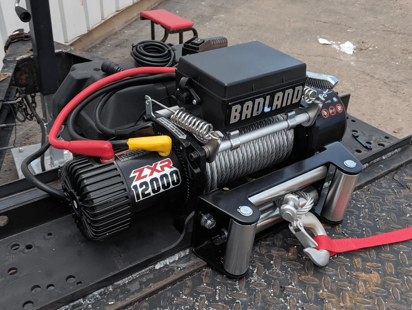

A buddy and I I've got a Badlands 12000 on a car hauler trailer. so far it's great. It's helped us get a few vehicles on the trailer and it's affordable. I would consider one on a Land cruiser because it's not something I would see myself using everyday but then again this is something that if you need to have it work you want to work 100% of the time so it's a tough decision at the end of the day. So far the Badlands hasn't let us down.
