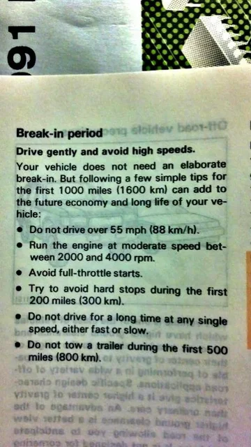

Honestly I think the break in period is a myth, sure don't be redlining the thing but the rings will seat quite quickly.
That came straight from
