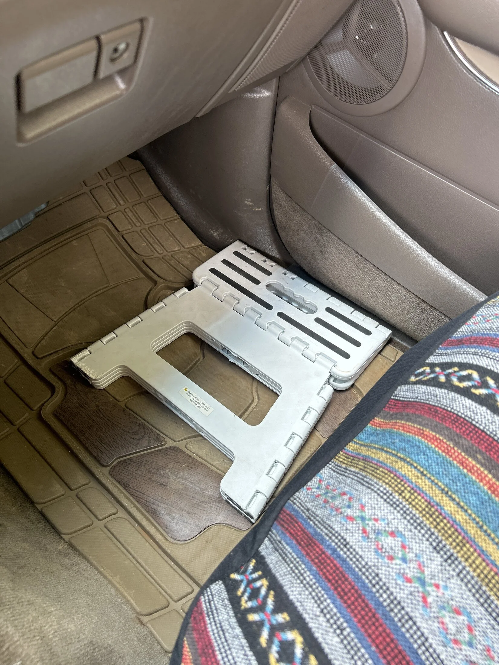

Is the step stool so you or the wife can get into the 80? :rofl: Back in the day, I had a truck that had a very mild lift and I had to carry a foldable step stool so my wife could get in and out. Needless to say she was never thrilled about going anywhere in that truck.
Lol that’s what’s this one is for

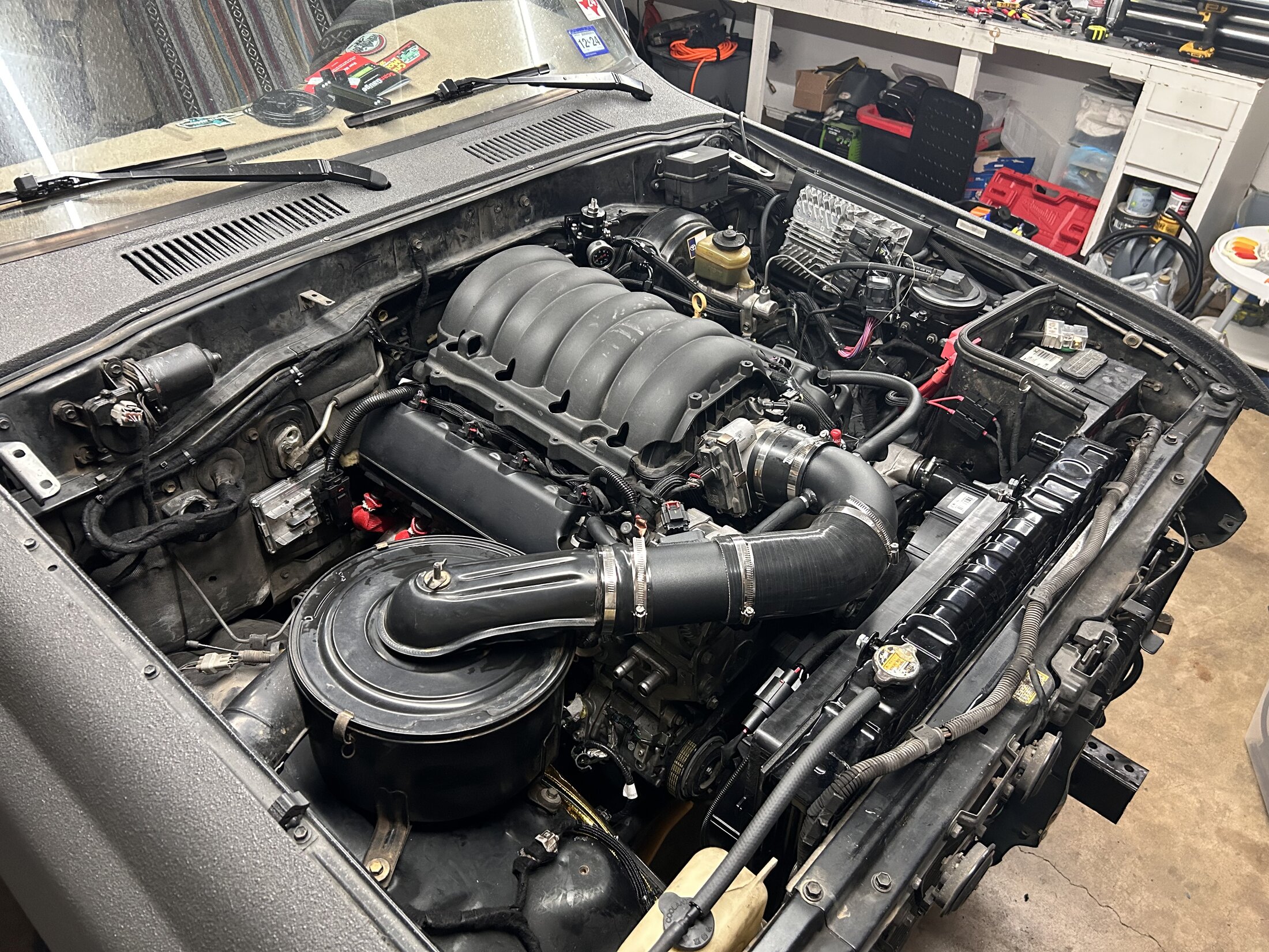

Doing the same project here as Matt (and drafting off him). I think trying to put the GM ECU behind the glovebox would be super painful. The GM plugs are much bigger than the Toyota ECU's as is the GM ECU. If you're operating with out the ABS unit, there is a bunch of room in the engine bay on the driver's side, but also you'll be removing the cruise control box and throttle, so freed up room there too.
I'm keeping the Toyota ECU back there just to essentially use it as a connector for the few wires on the Toyota harness that will still be operative.
You can see the ECU mounted on the driver fender, where the ABS use to be. The Harness from SWAPTIME did not have enough slack to do too much else with it and would have to be greatly extended to mount anywhere inside the cab. Plus like others have mentioned it’s rather large.
I put my GM ECM on the passengers' fender. I repurposed the rubber-isolated mount for the factory cruise-control, which provides a gap for the hood strut.
The GM ECM is tucked behind the relocated washer bottle to help with heat.
I can't see putting the GM ECM in where the old Toyota ECU was located due to the size of the GM connectors, and their location.

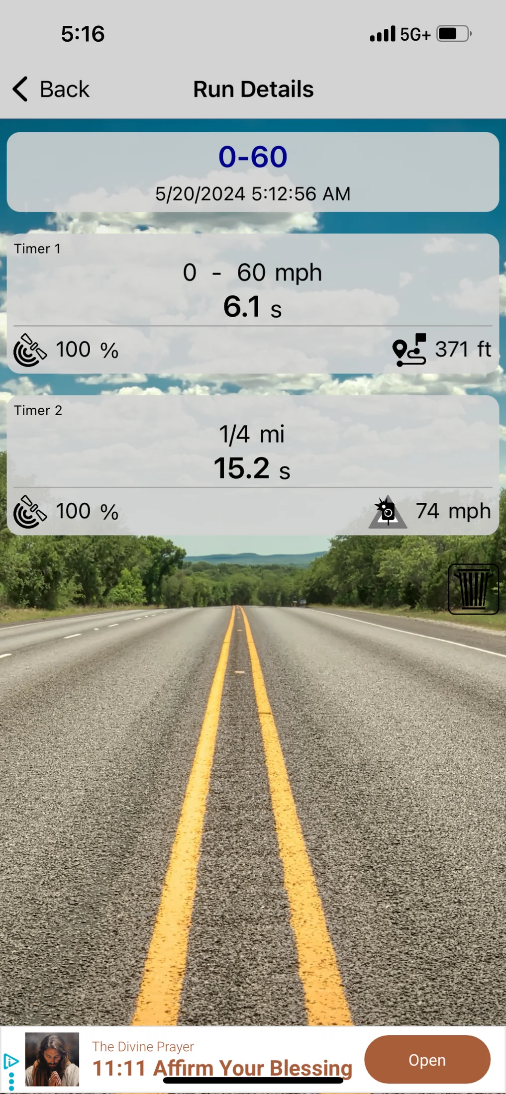

The tune setup by SwapTime has this trans dialed in. It loves to be hammered and shifts lightening quick. But also seems happy just lugging around town. From what I can tell even loaded down I’m not pushing this trans hard at all. I didn’t multiple 0-60 pulls and highway pulls from 40-90 (looking for rich/lein issues) in 90 degree weather and I never saw more than 150 degrees trans temp.
Yes the final drive is higher but the first gear is also lower at 4.70 compared to 4.56.
In 4low on 315/75/16 and stock axle gearing I can slow walk faster than the truck will
