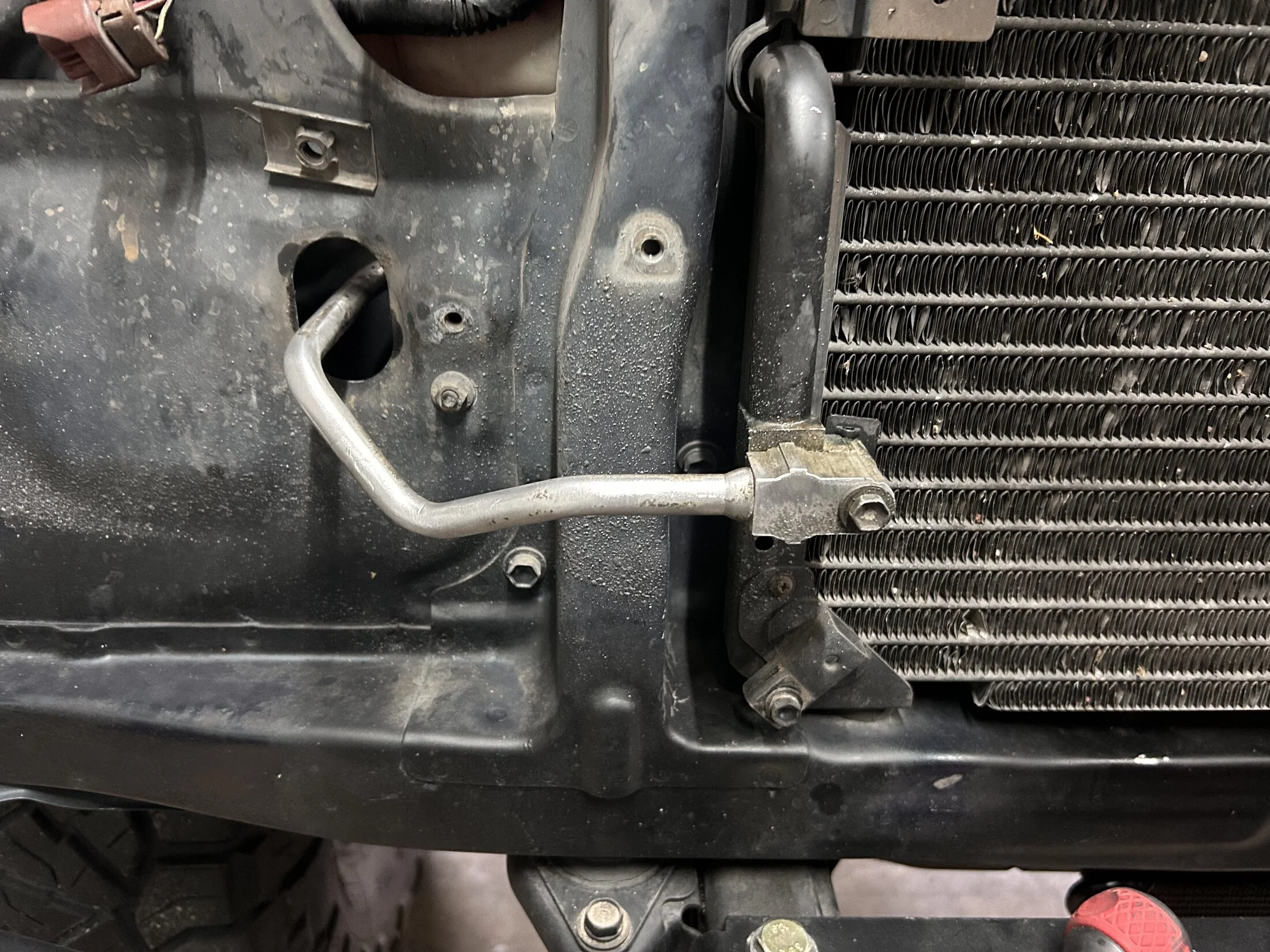

AC WIRING.
Video of how the wiring integrates with the SwapTime Conversion Harness.
Basically all you need is 1 wire and the factory Toyota pressure switch to remain intact.

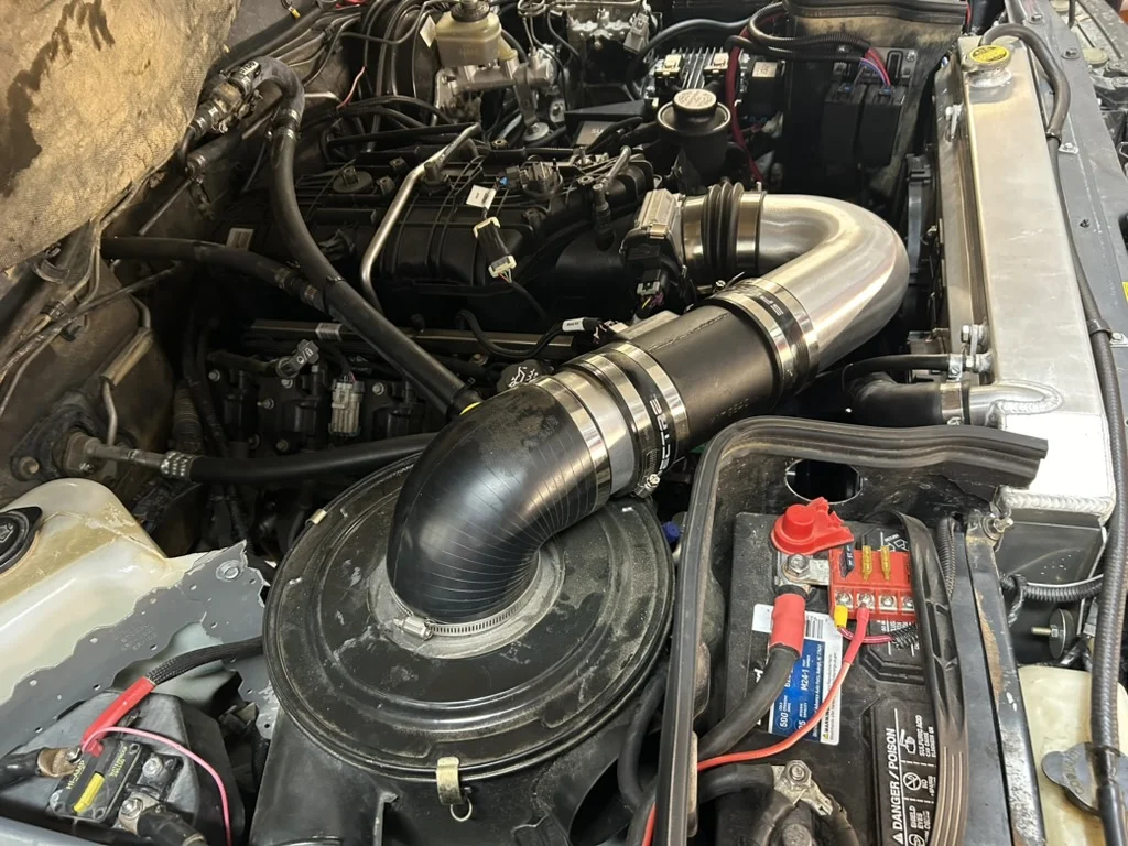

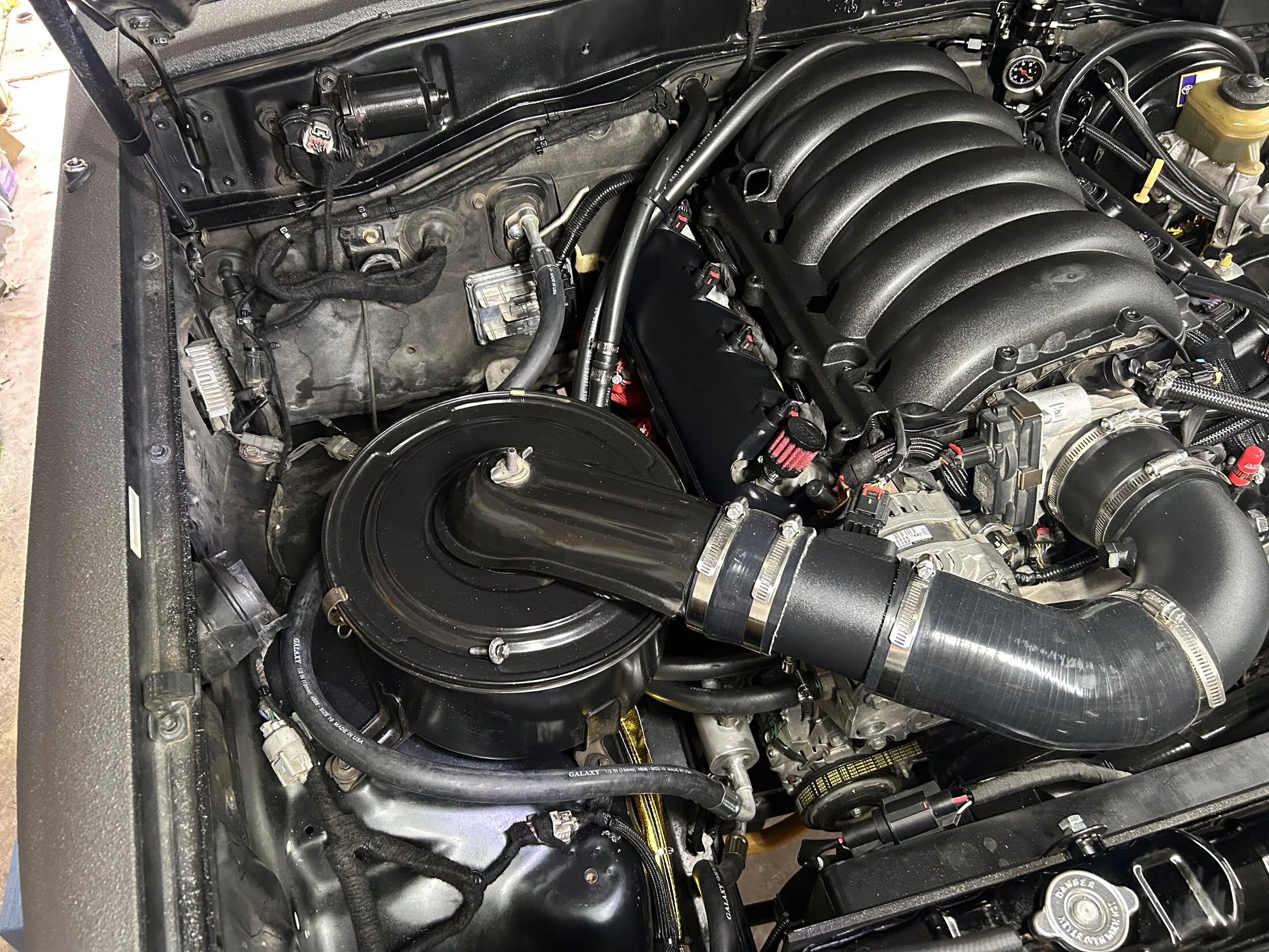

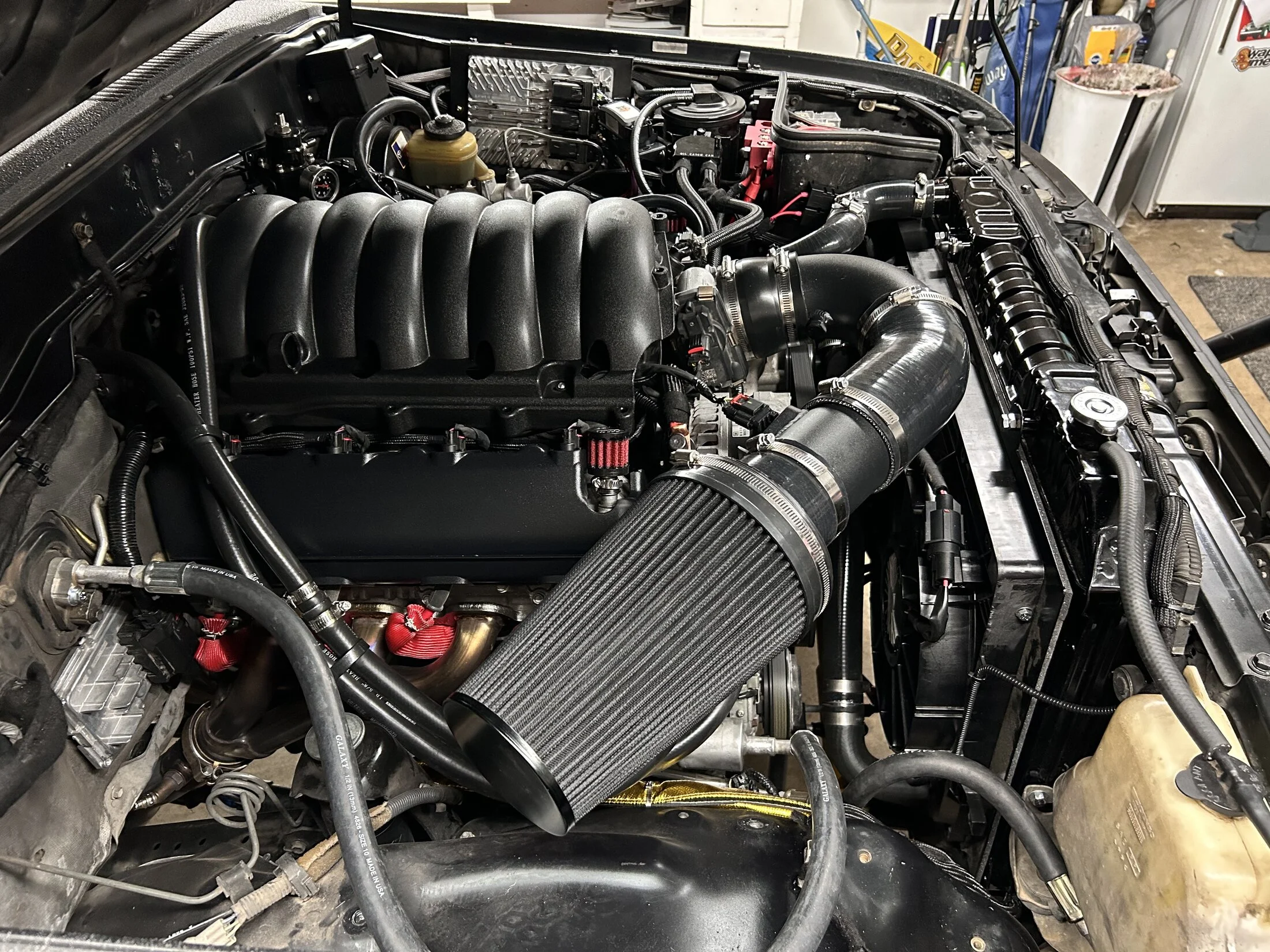

So I had noticed that the intake was very loud and sounded like the LT was really trying to pull some air through it especially down low in the RPMs.
I changed out the factory airbox for a large cone style filter and made a simple support bracket off of the alternator. (That way it moves with the engine as it flexes the motor mounts). The results were a much happier sounding engine that “feels” like it runs better.
I loved the way the stock airbox looked but it simply doesn’t allow enough flow.

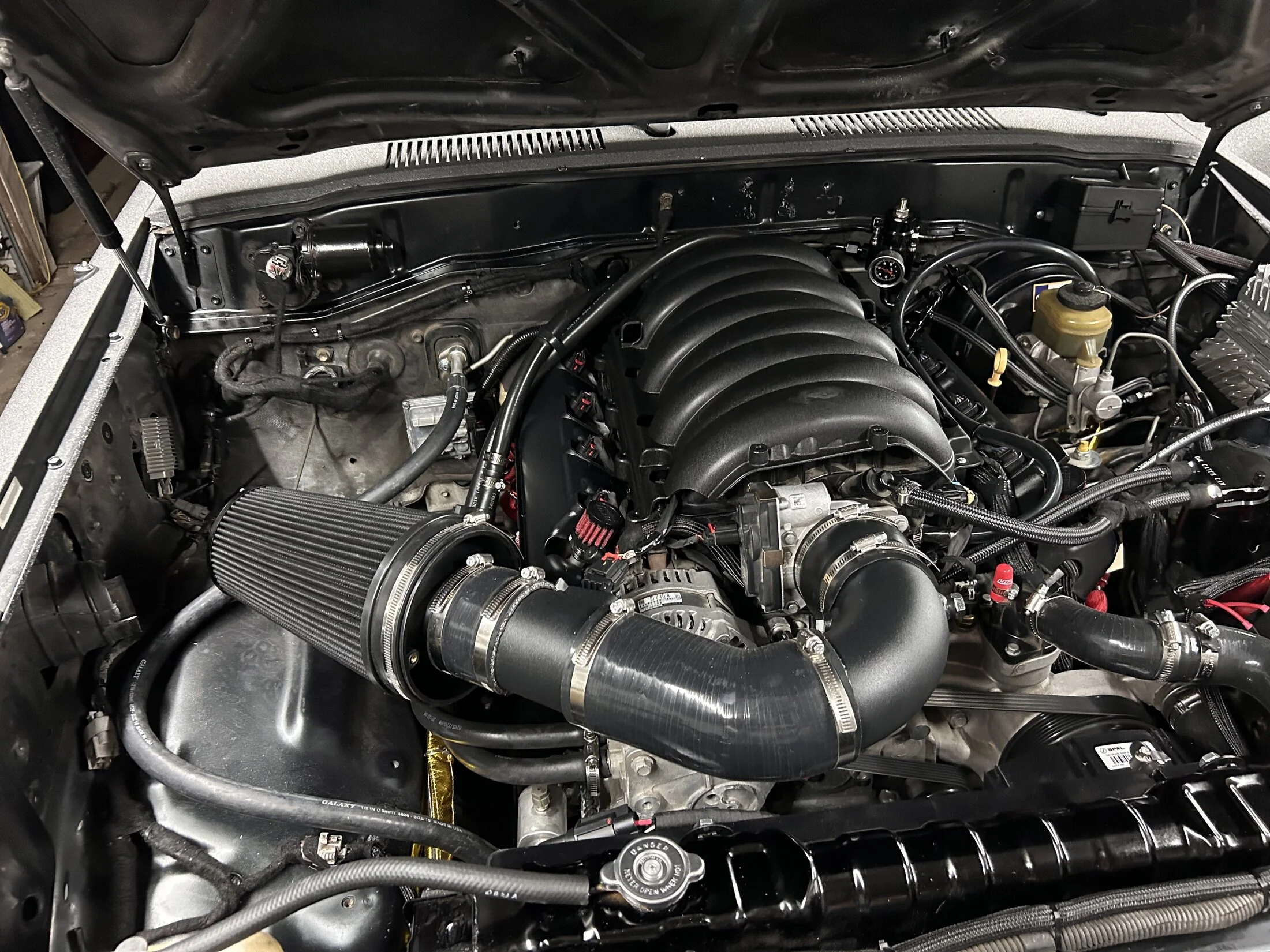

View attachment 3648455View attachment 3648456
Here is how I got my engine to breath extra air. I have a plug for the 4 inch inlet in the side of the airbox if I need to do any big watercrossings.

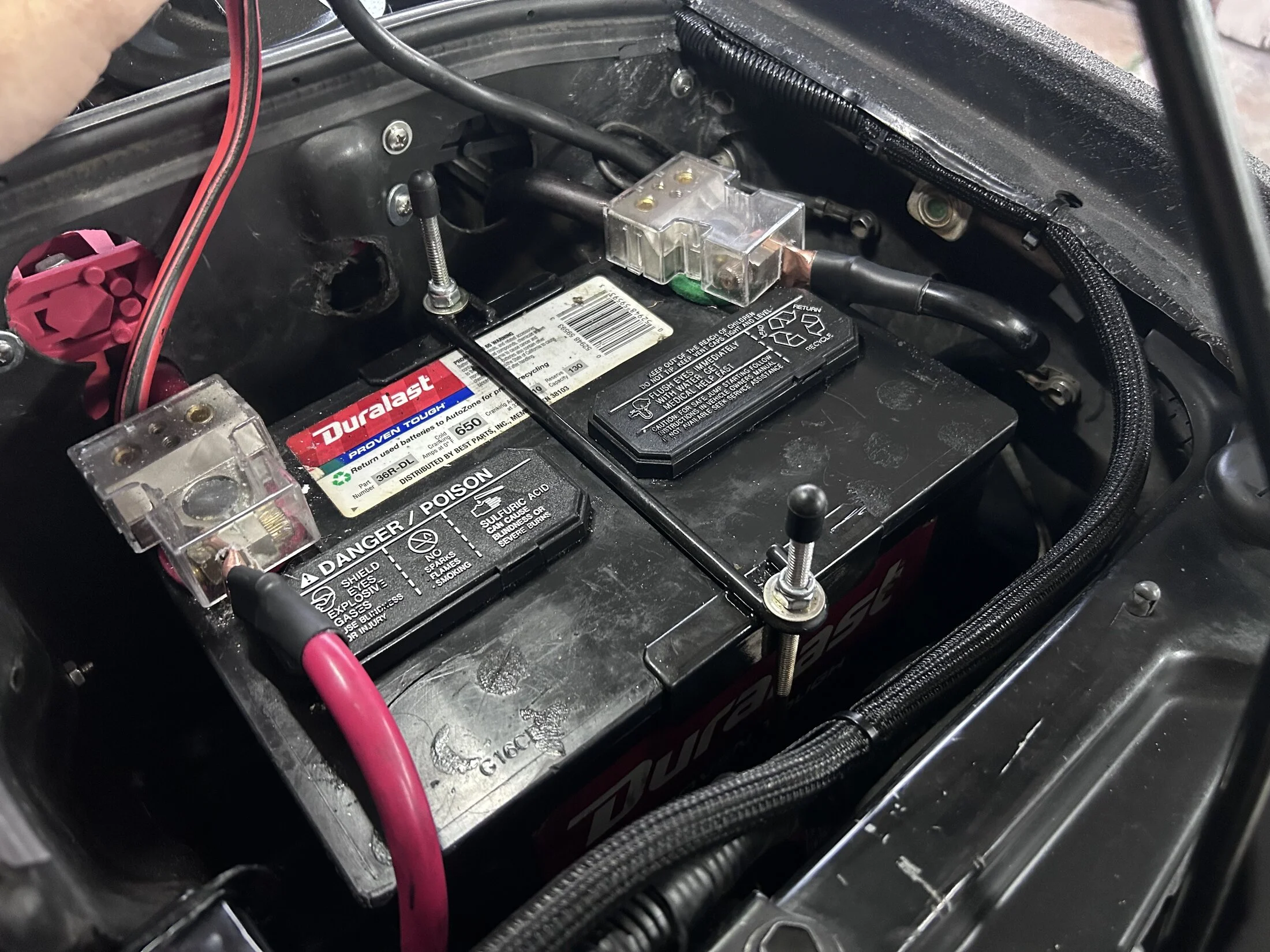

This evening I am installed Land Cruiser Products battery tie down.
It’s a well made product, all rubber coated and fits a stock side battery perfectly. A little finicky and I’m not a huge fan of how small the “hooks” are but, for what’s out there it’s a good solution to replace the tires spark prone factory tie down.

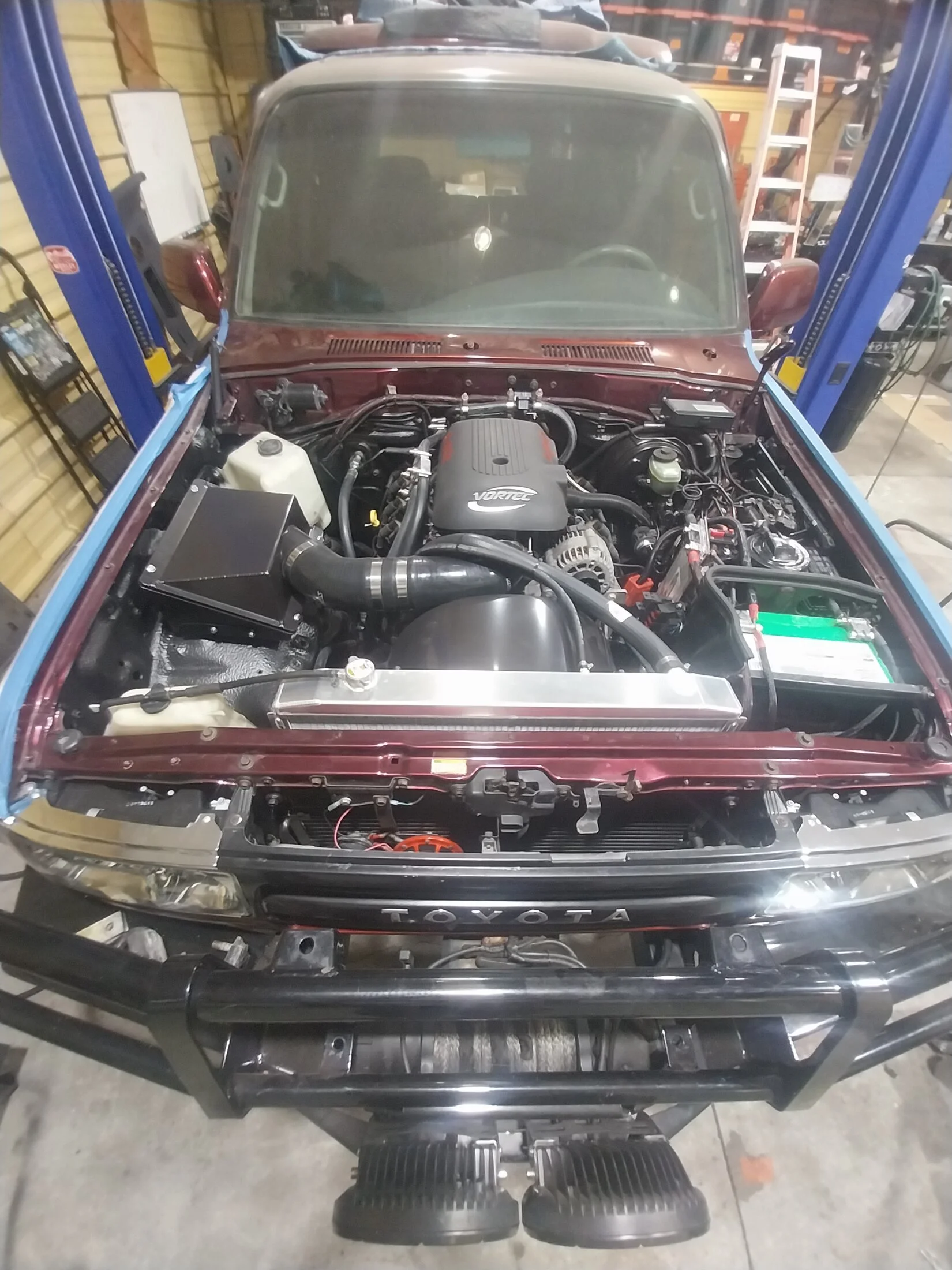

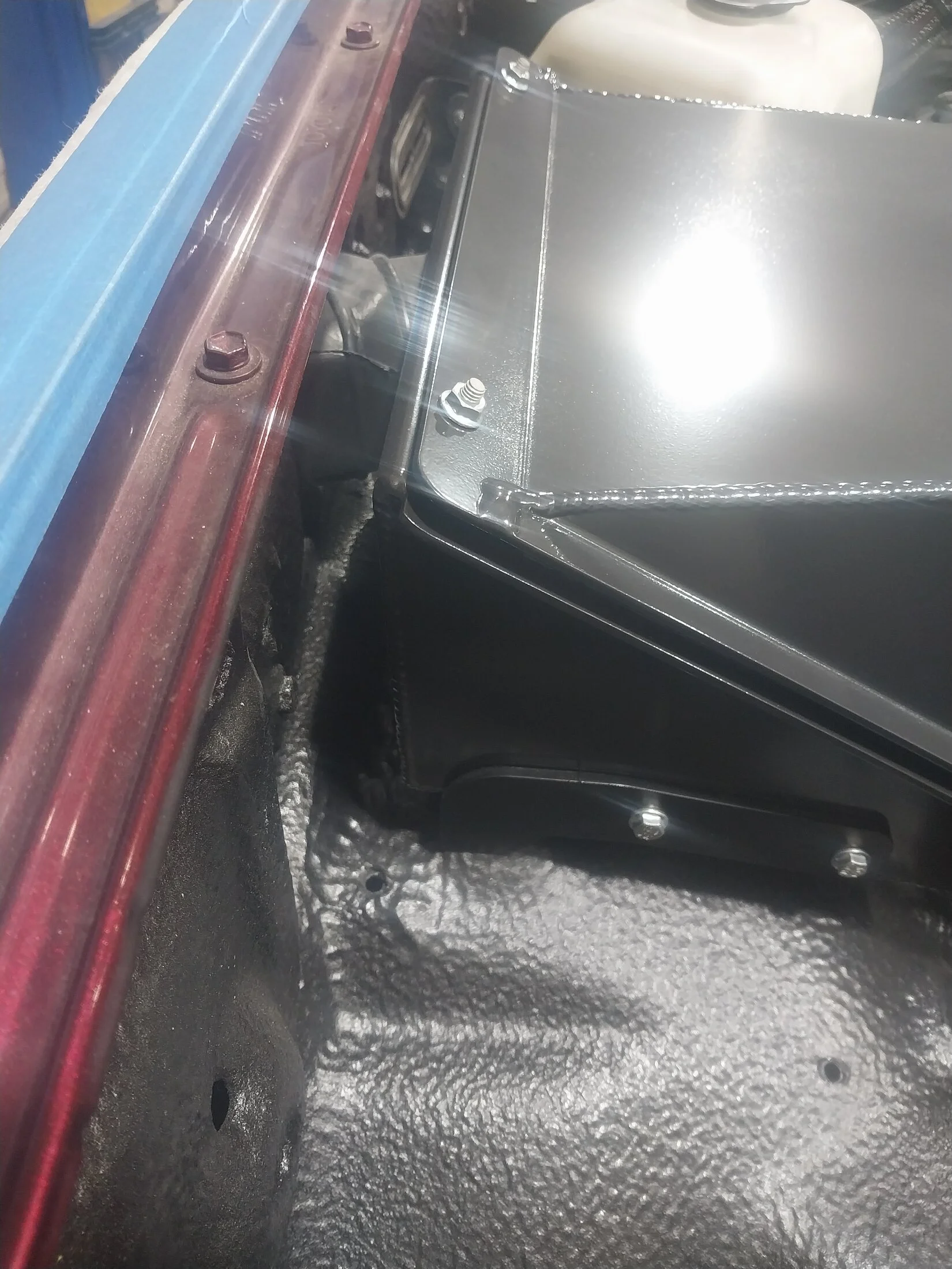

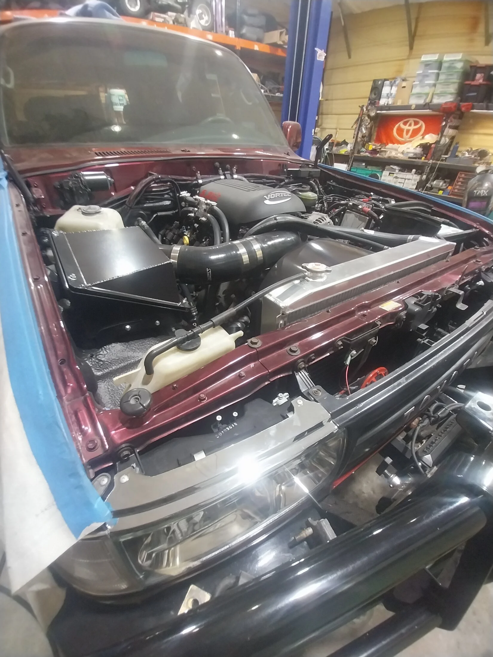

Have you looked into the Torfab air box?
Here it is on a customer's 80 only thing about is they don't offer anything to fill the gap from box to fender.
Tommy
Great looking, very expensive and frankly I’m out of money for now lol
