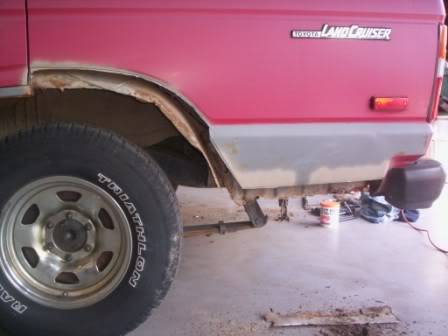

Started the rust abatement in earnest today by making a cardboard template of the rear quarters, and then cutting them. While at it, I cut the lower quarters ala TheFerg, and will fab up some protection down there when I get around to bumpers. For the time being, it's cut out the cancer.
I'm going to attempt to maintain the contour of the original metal with the sheet that I weld in...not sure how long that idea will last once I start trying to shape sheetmetal. The back-up plan is to get it straight and seal it, then Durabak or similar textured finish along the lower contour line, and tan or brown Krylon upwards.
