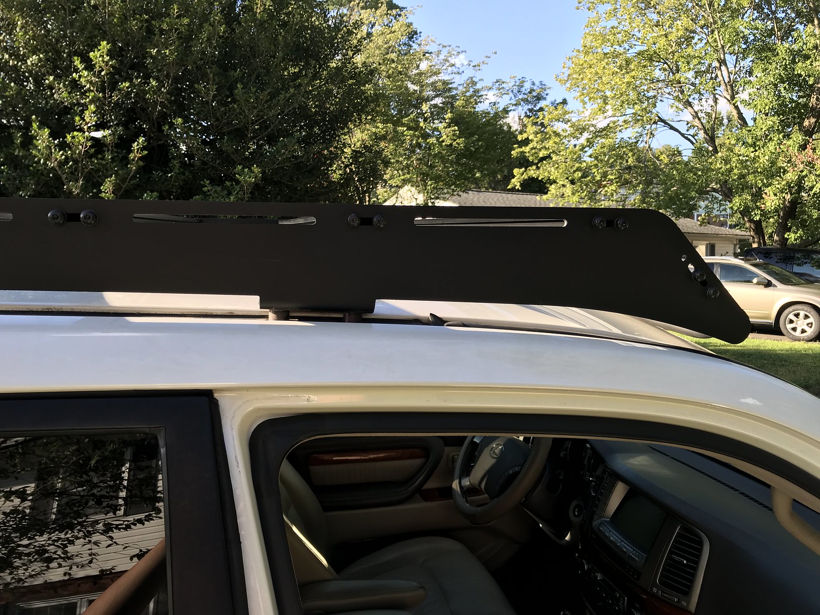

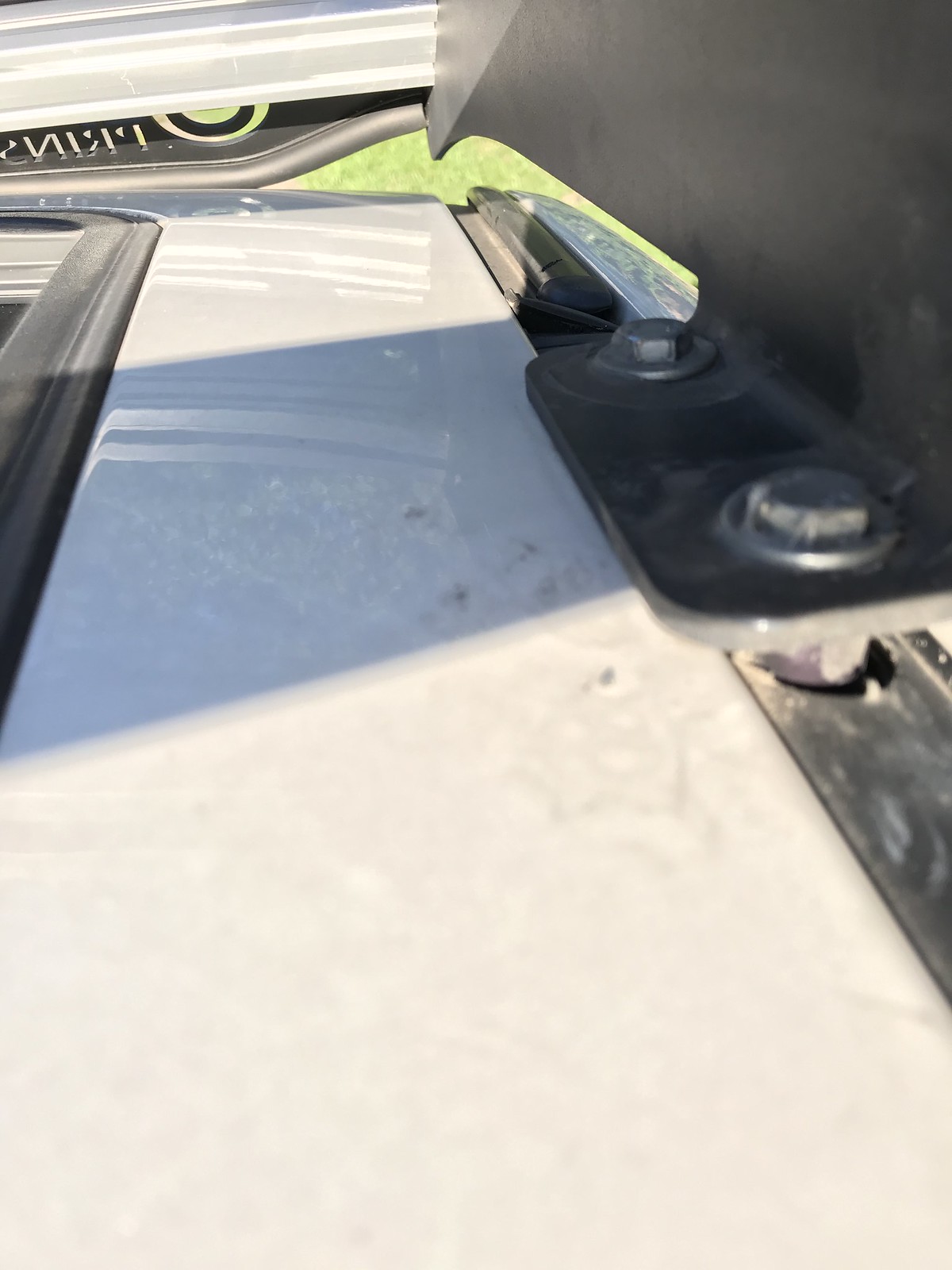

The front mounting point is just behind where your finger is pointing. Careful though and try to slide it out rather than lifting it straight up and bending it, it's made of aluminum and once it folds, it'll be hard to get it back straight. look at my pic and gauge where the mounting point is, it's like right above the B pillar. But you gotta remove the entire strip to access everything, because the current front most point on your stock rack, will not be used, just plug it up with bolts and then use the middle one also covered under that trip piece. Remove it and you'll see.
