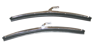

Found a great replacement to the oem ones and were grayish as well... newer style j hook but in the smaller 9x3 size
I will do a write up about what I used and where I got them at some point ... they are from a 70’s era beetle

Peter I did see the silver Porsche ones ... same size I think as well ... but two arms ... two blades and rubber grommets... all for about $32 Usd couldn’t Find a better deal :)
Porsche stuff in USA is pricy ... however alil bit beefier than the blades it looks
And I’m all about making things cheap :meh:

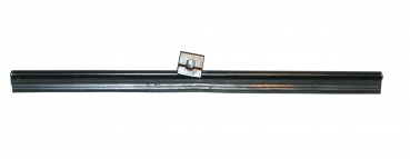

Btw - I used these for my replacement wipers:
TRICO Classic™ Wiper Blades | TRICO® Windshield Wipers
