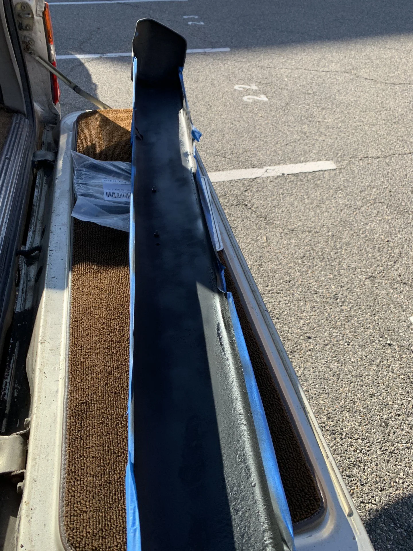

Did a bunch of little stuff I had been putting off to prepare for the drive from DC to Hyannis then ferry to Nantucket. Oil change, took it to Krown in PA for undercoating, etc.

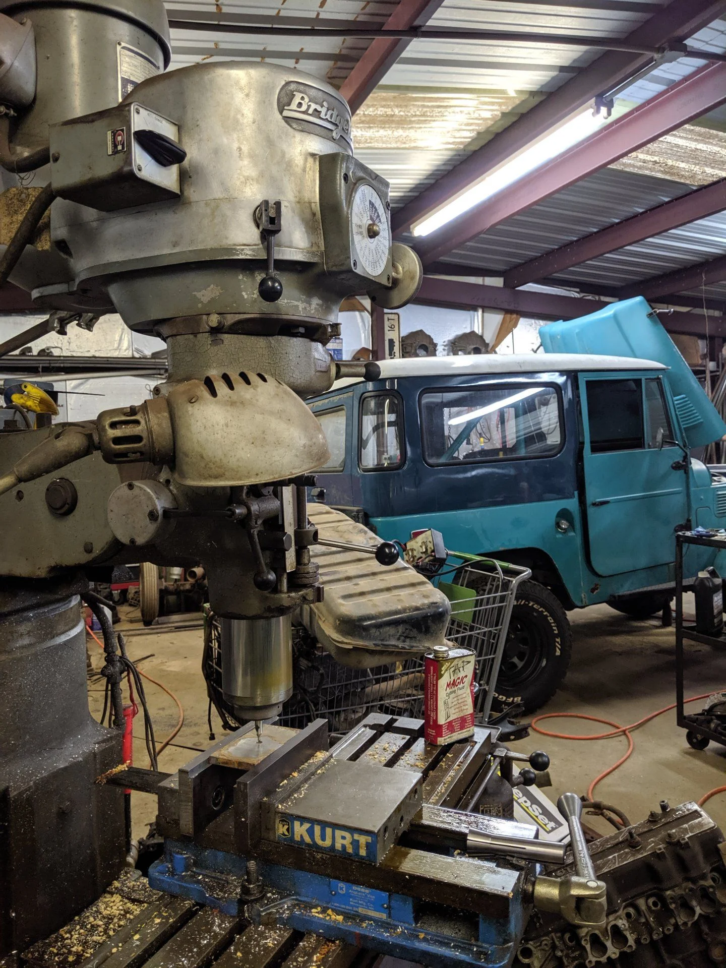

Okay so I've been quiet (mostly due to school and work), but I do still own land cruisers and I did a bit of work on my 40 this past week when I was down in Georgia. I posted on my 40 thread, but I'll post here as well. Here is a little eye candy of my friend's shop.

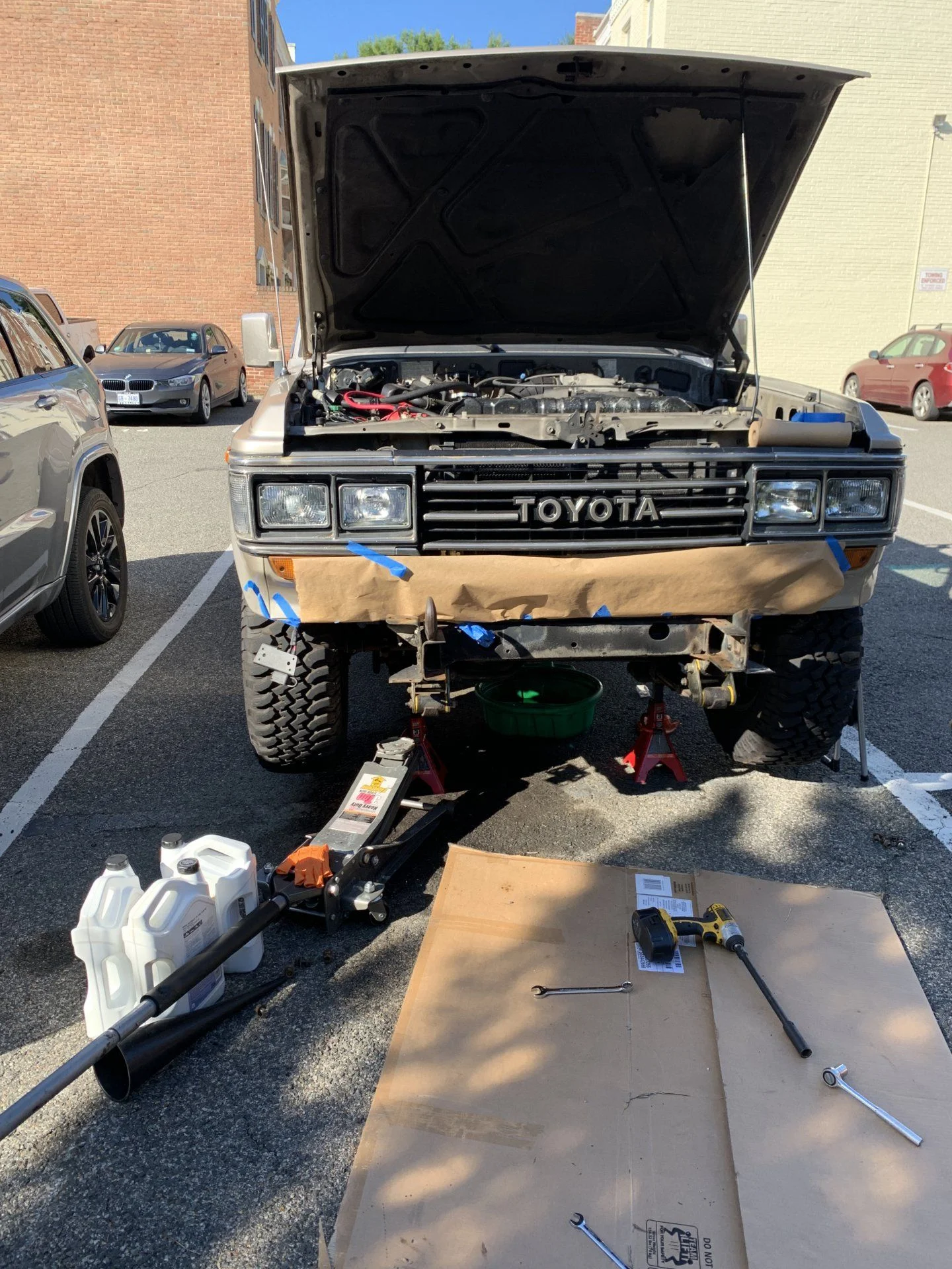

Doing my oil change and looks like I need to remove the skids to get the rest of URE out
