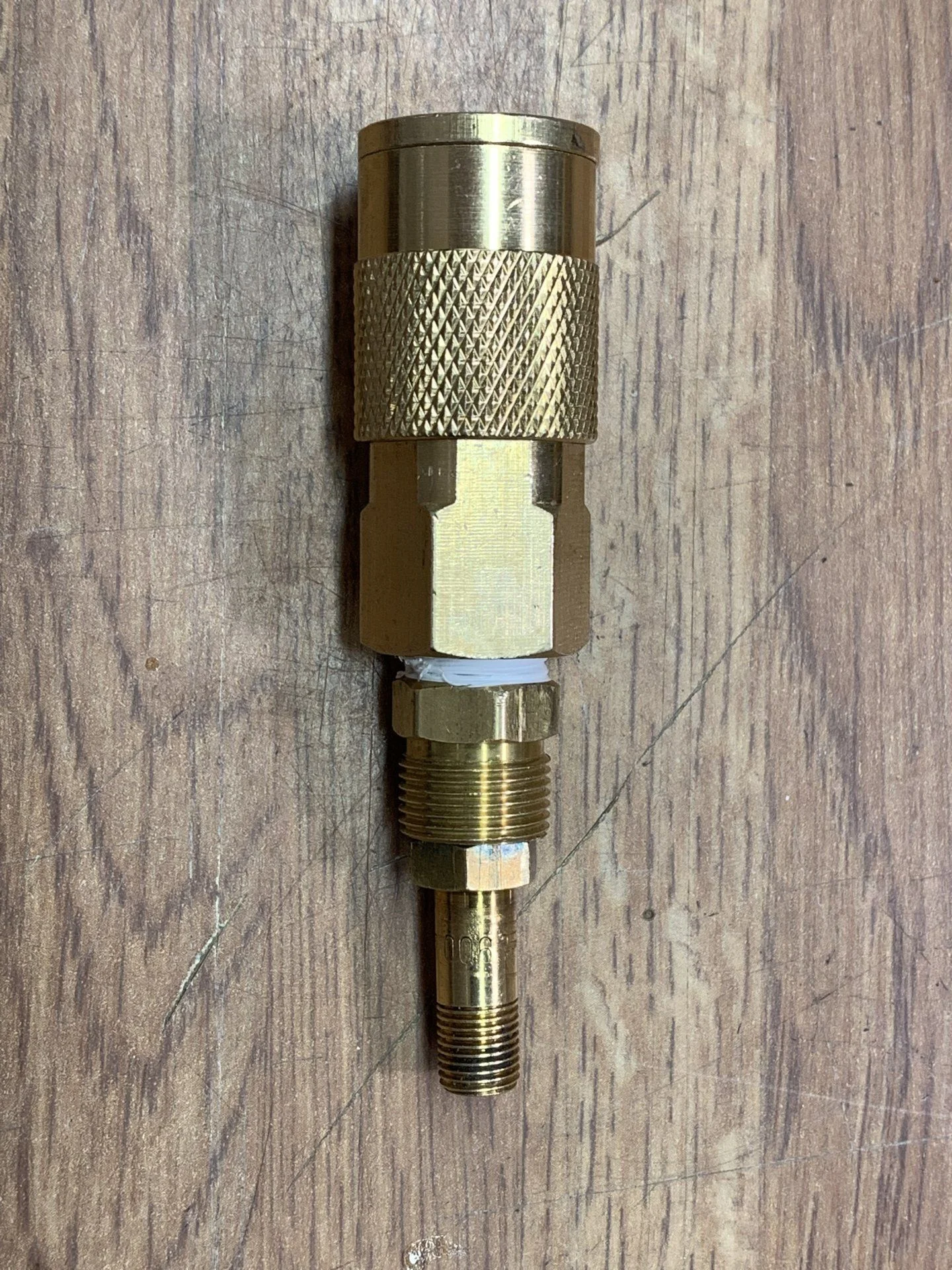

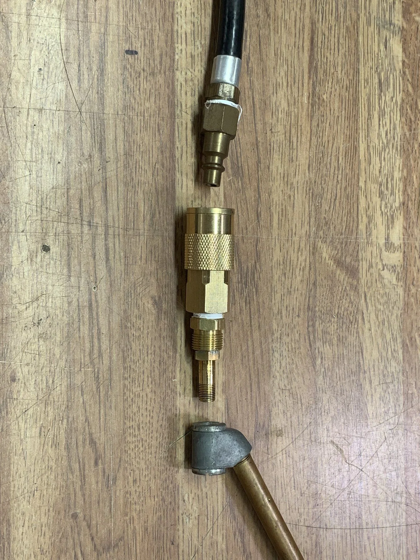

Stopped to air up at a gas station. Hose was too short. I had my own chuck and an extension hose with couplers at each end but no way to connect to the chuck on the gas station’s hose. Had to use my little compressor which took forever.
So, from that experience, I made an adapter. Brass replacement schrader valve with the valve part removed, soldered into a pipe thread adapter (had to drill out the inside of the adapter a little bit), screwed the adapter into a FM air hose coupler. Done! Now I can go from gas station chuck to my hose to anything I have that needs air.

took me a few seconds to figure out how that would work...

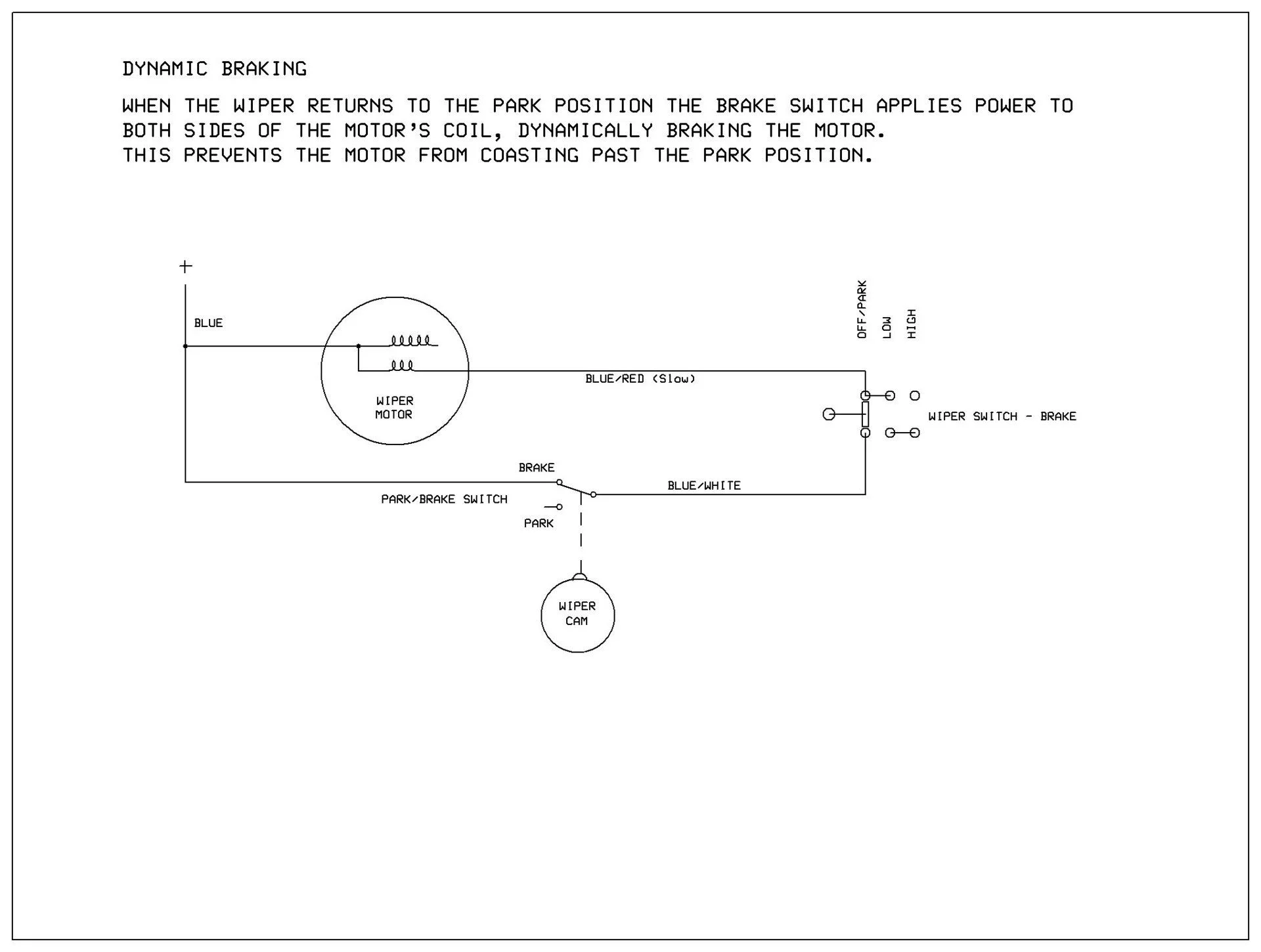

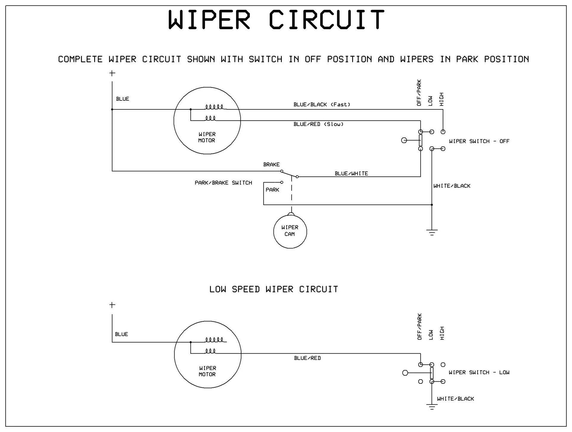

Interested in taking a look at mine? Was running slowwww now it runs not at all.
I’ve never seen one run “fast”
I always thought he windshield wipers on 40's were just a suggestion for the water/ mud to move off the windshield.
Electrically yes. Mechanically no.
I can help with the mechanical. I've done some exploratory and modification surgery to mine.
Sure. If you are driving it to the meeting next week we can do some triage in the parking lot.
This might help. These are the schematics for the various parts of the wiper circuit that are used for the different functions.
