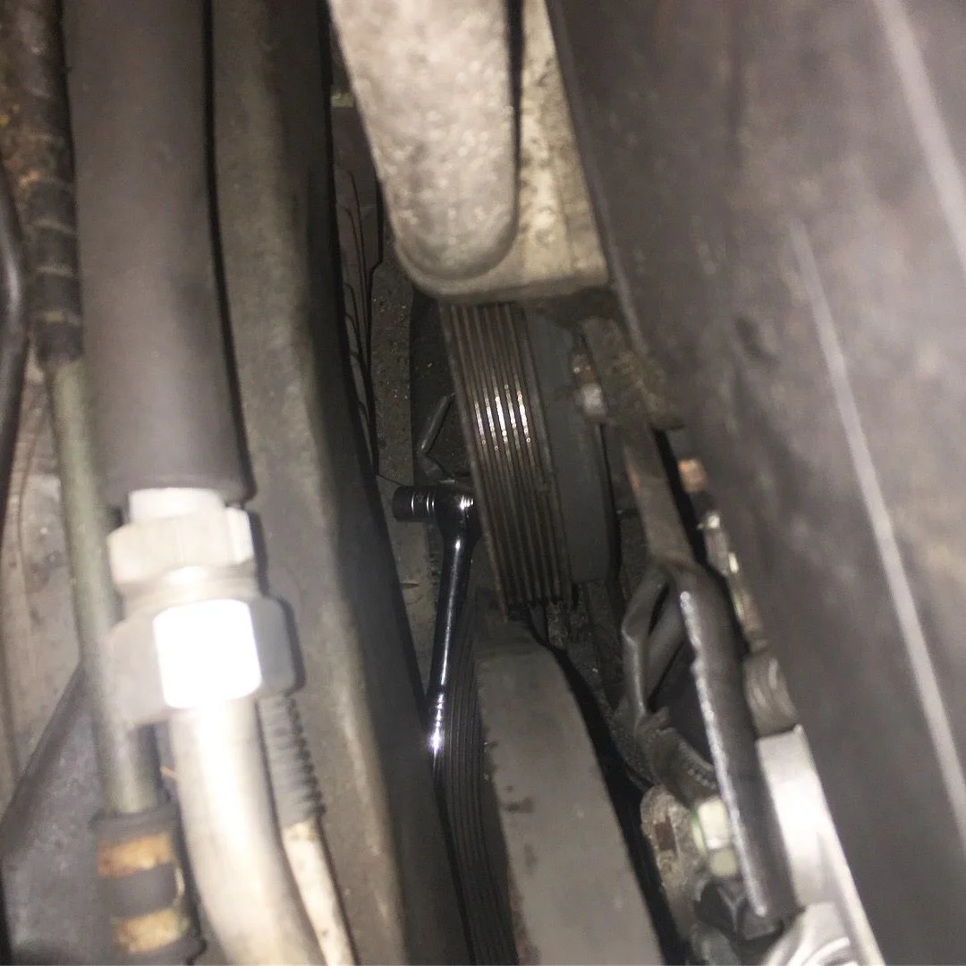

Managed to do this too. Most annoying this is how conventional socket wrenches are too short so very tediously done by hand until enough clearance to squeeze air ratchet to get in there. Note that I don't mean down to crank, in this pic the wrench had slipped due to me barely holding the tail of it.
A rare earth magnet washer from HD or amazon looped onto a coat hanger or copper house wire is a great tool to keep handy.
Also, Amazon has a Gear Wrench set of long handle ratchets.
