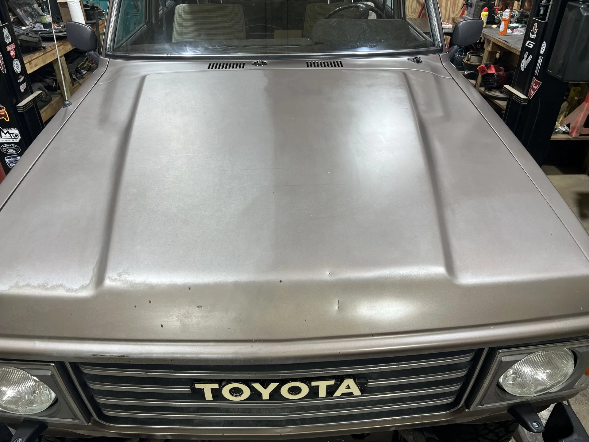

Old faded ass 60 getting some love.

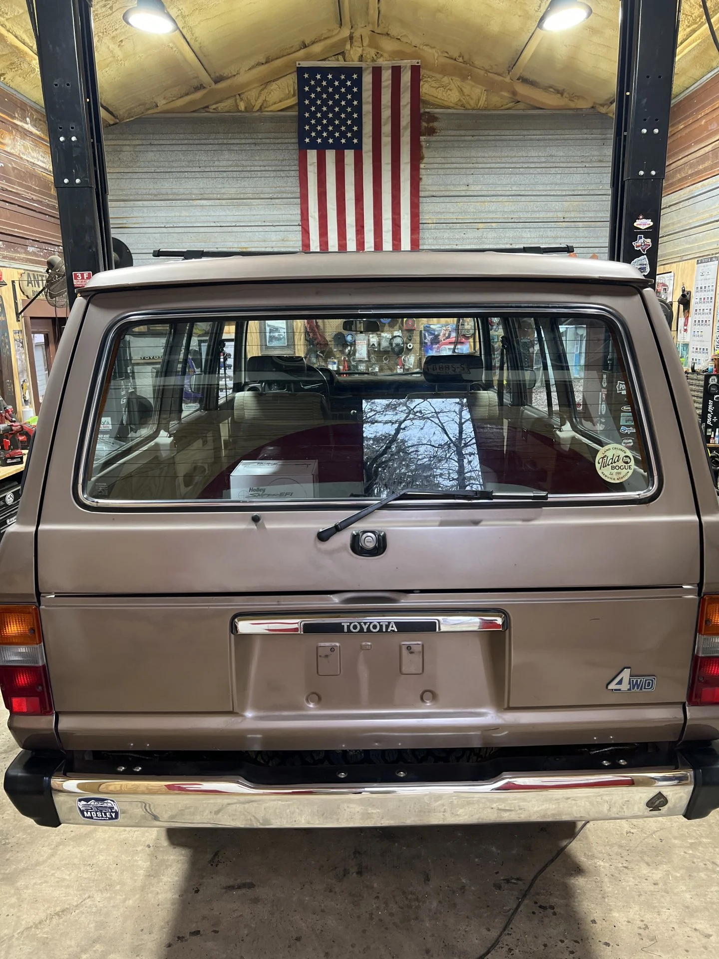

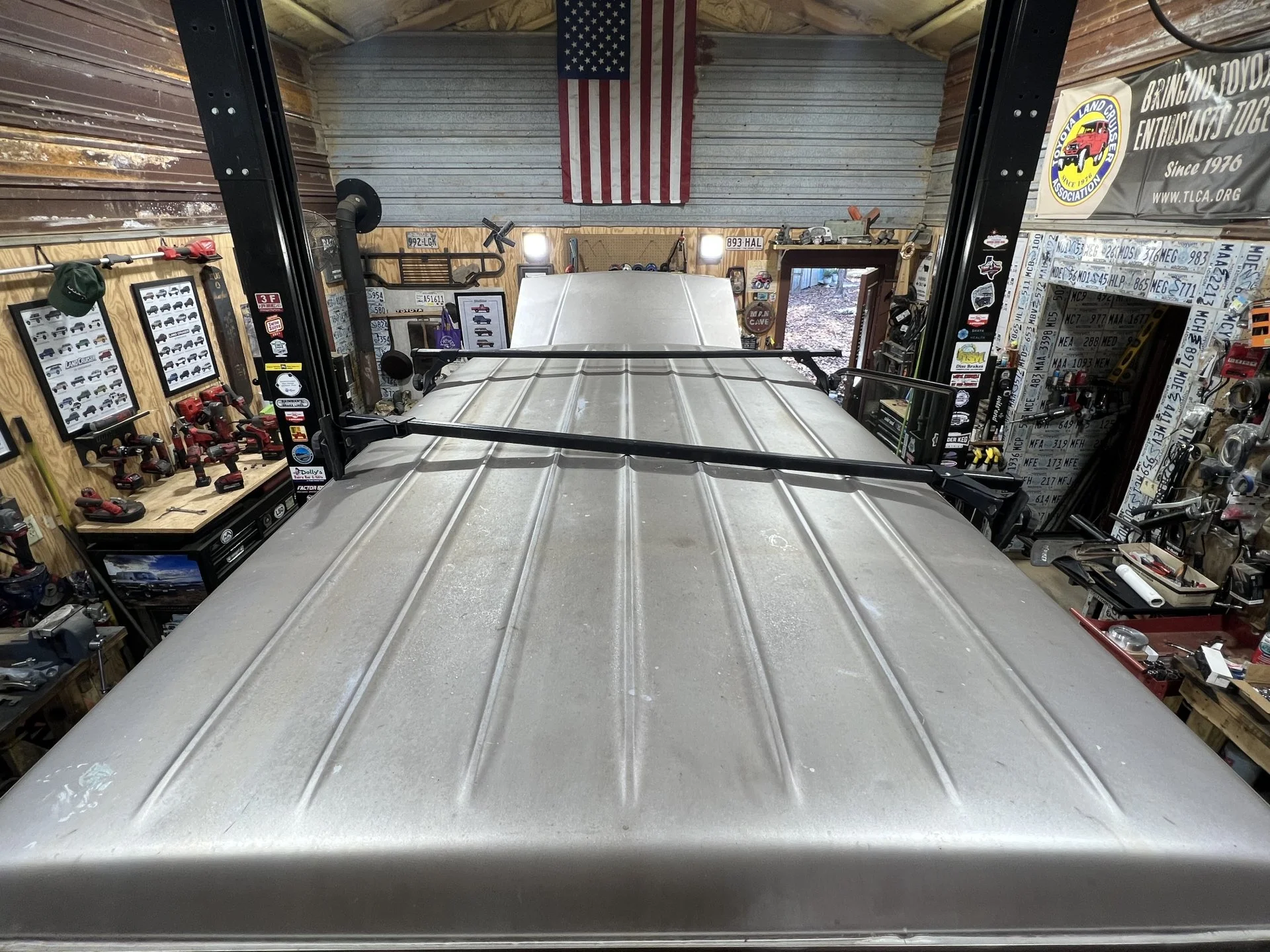

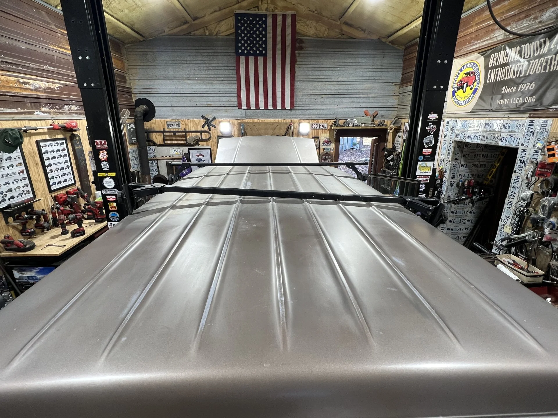

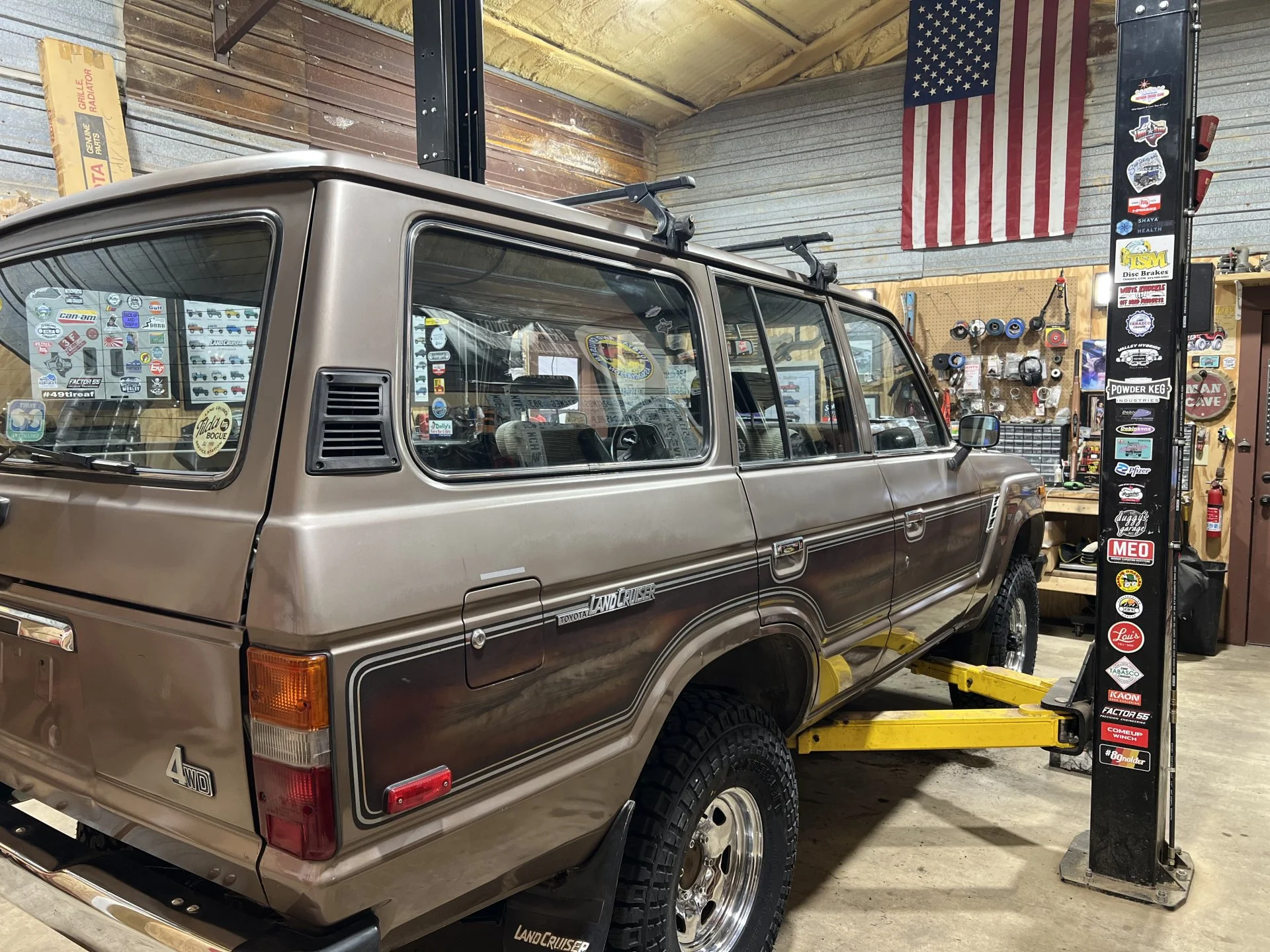

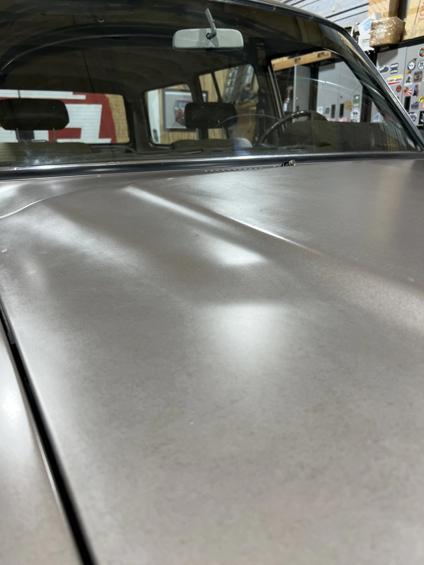

Looking for advice. My 60 has a cheap re-spray over the original brown paint. This thread has inspired me to bring it back, rather than re-paint the truck. I attempted Goof Off with 00 steel wool. It takes off the respray, but is also taking off some of the base coat. What do you think? Too much pressure? 00 is too coarse? Try a different product? CLR with steel wool wouldn't touch the paint. Thanks for your help.
Before:
After:

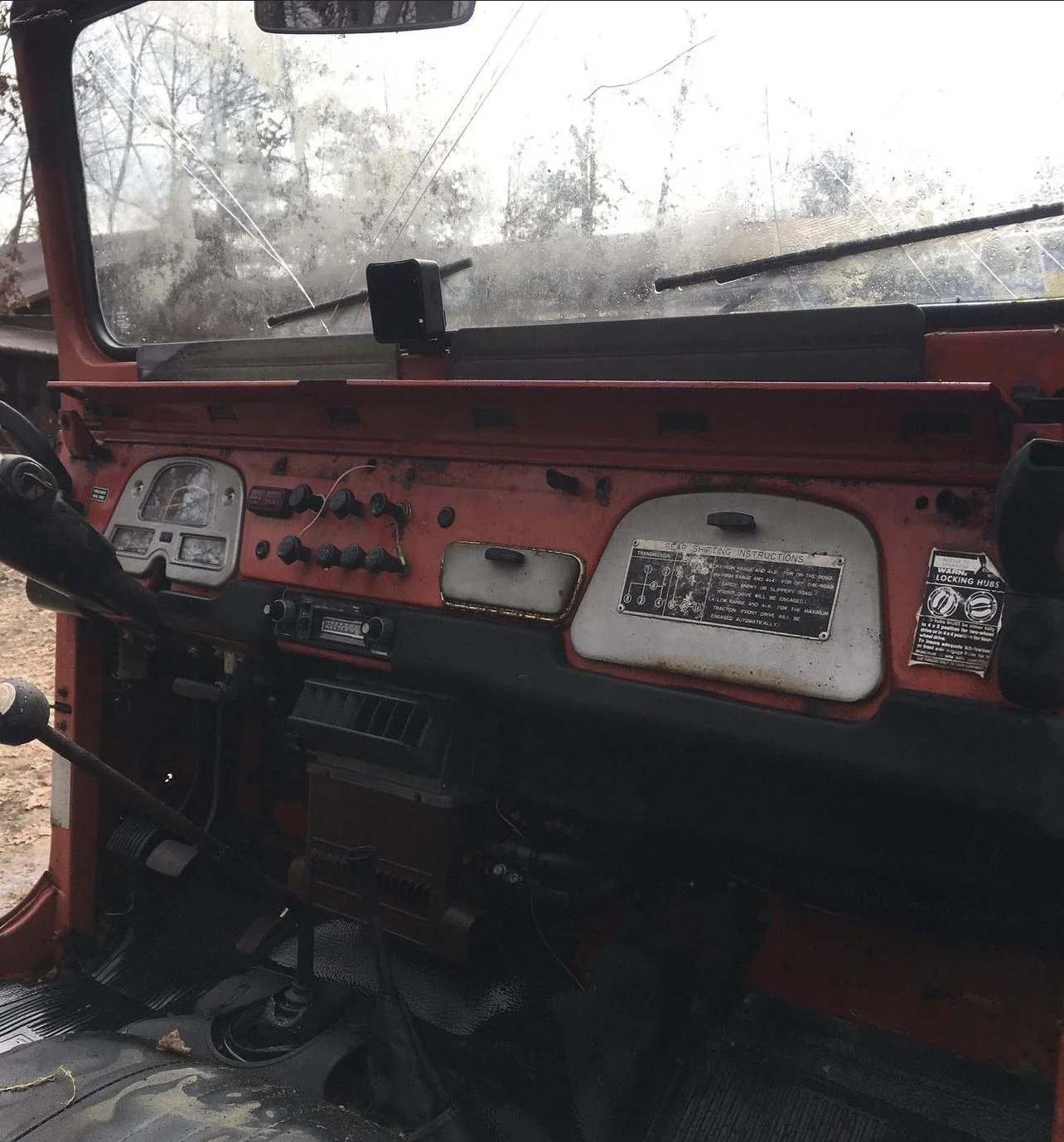

I have a set of head light guards like the ones pictured on the 40 above. Only other set I have seen. I had thought they were someone’s home built deals.
