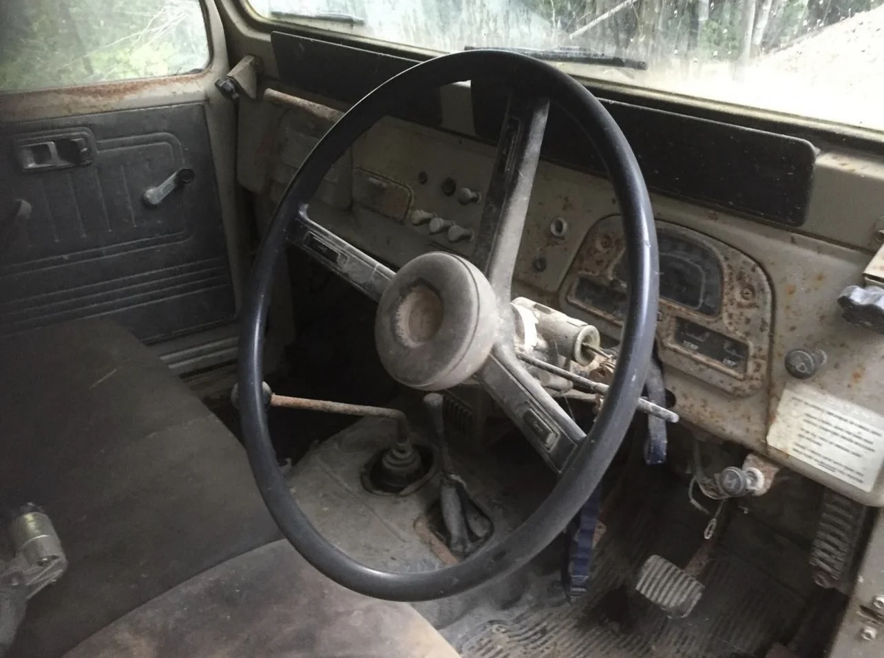

Original interior is cleaning up nicely. Actually tempted to leave the old original Toyota mat out to avoid covering up the transmission tunnel! Forgot to ask - what is your go to converter?

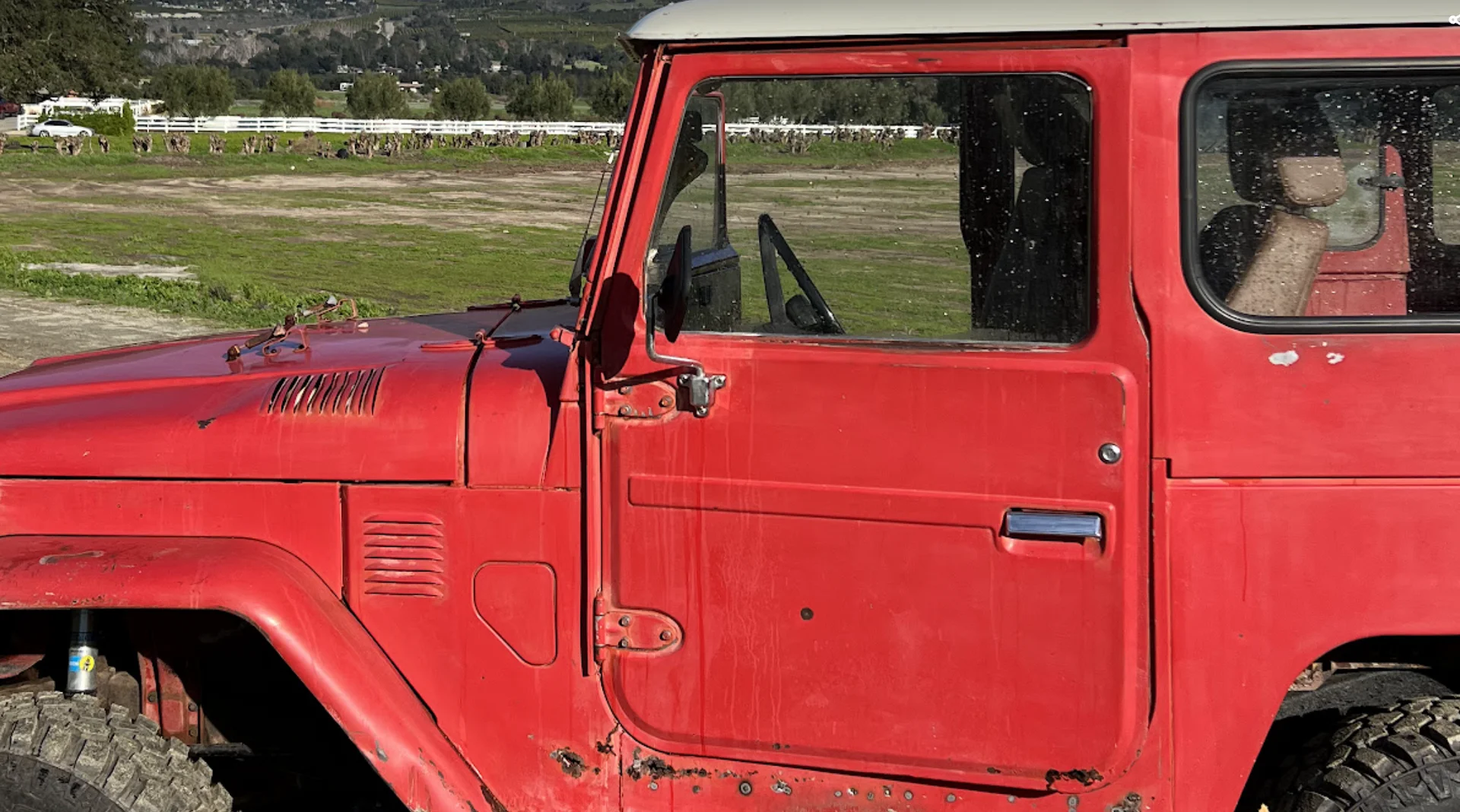

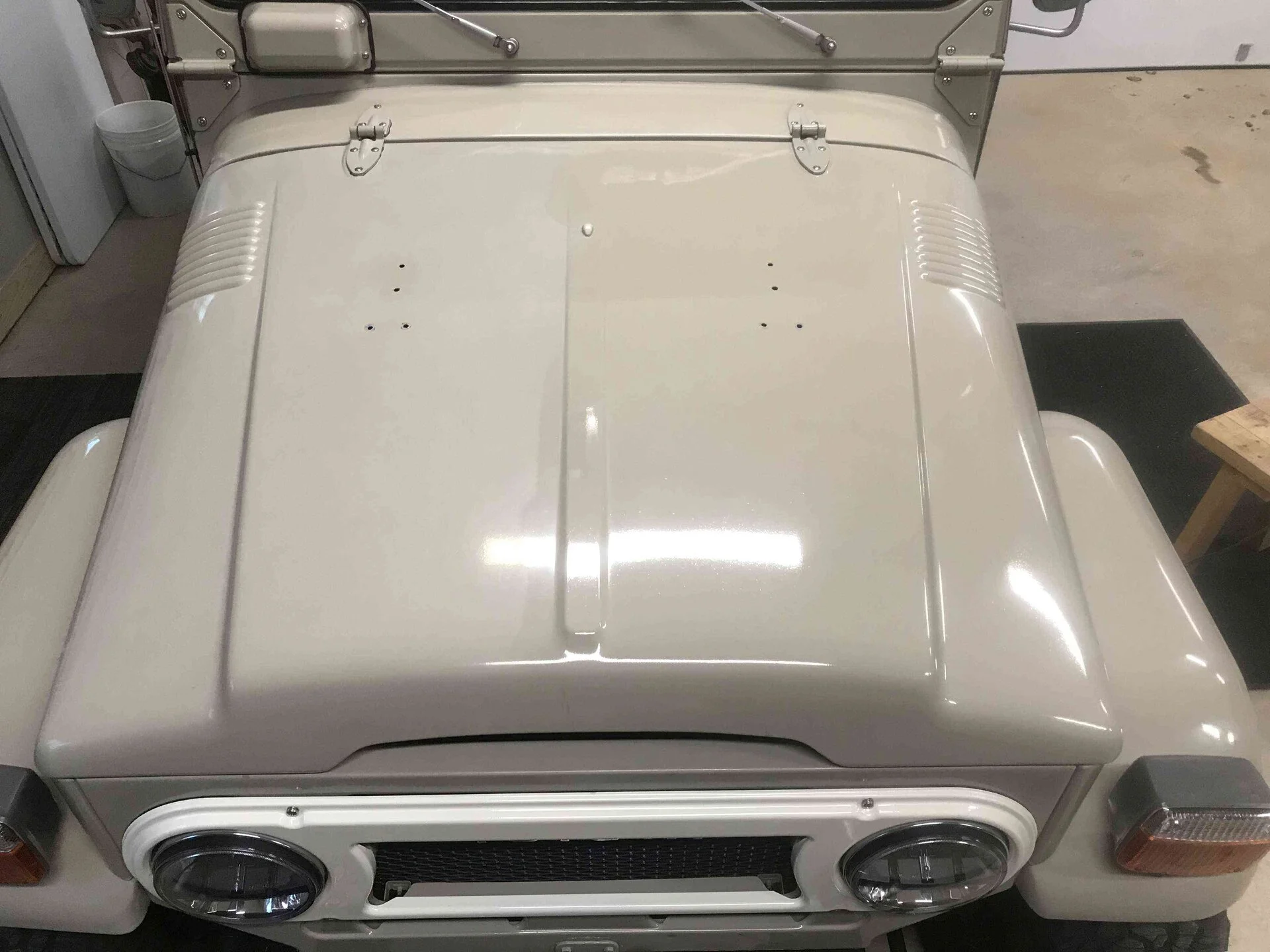

Well, did half the car today with clr. No one talks about how much work it is. Holy moly. Very happy with the results though, really astonishing.
After scotch bright, I noticed that it removed oxidation but there was more potential, so I switched to 0000 steel wool.

Which ended up like this - note that only the side and hood are done and that it is covered in water, having just been rinsed. I’m hoping the penetrol will make it pop like the water does.

Looks great. Yeah it's a helluva forearm workout shinning these things up.

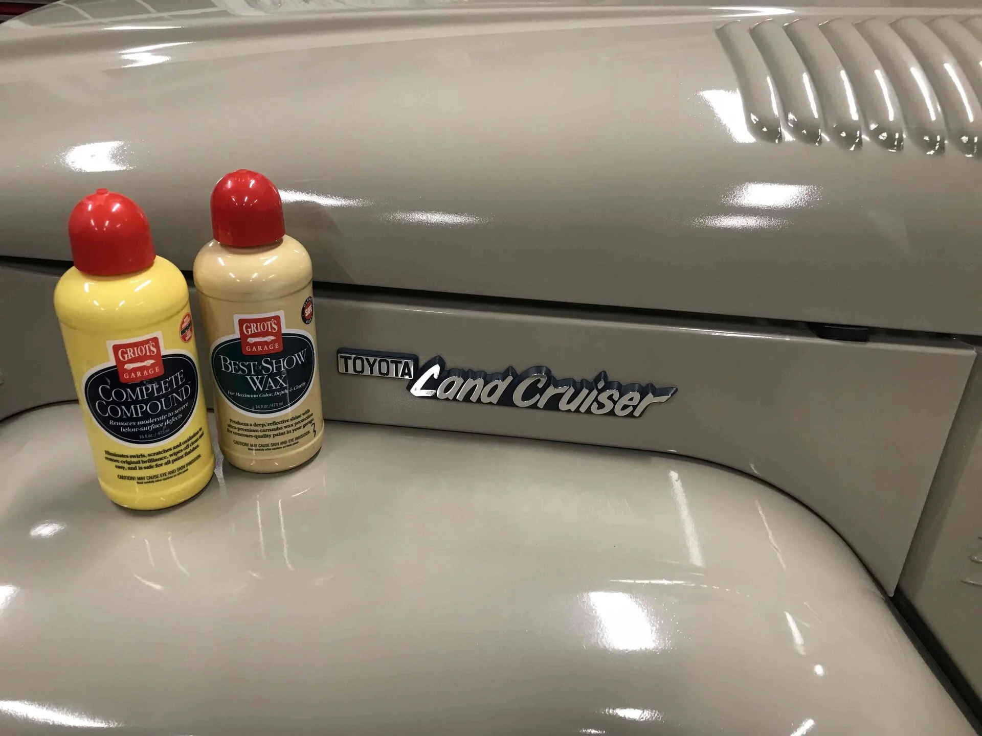

Quick question for everyone/follow up to previous post. I finished up the clr process, before I move onto penetrol or fluid film (currently leaning towards the penetrol route), should I do anything else to try and clean up the paint?
I washed it down, I think I need to wash it a few more times, as there is still residue. Should I be concerned with removing streaks or water marks before penetrol, or will that be nonexistant once applied? Sorry if this is a silly question..

I would compound and polish the paint instead of penetrol. You will get better results IMO.

FWIW - Maybe try this stuff in the yellow bottle with an orbital.
YMMV
Wow thanks for the feedback everyone, makes me excited to think I can get that pop! I’ll look into the griots stuff!
