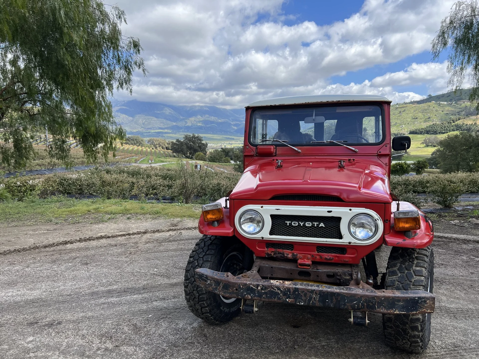

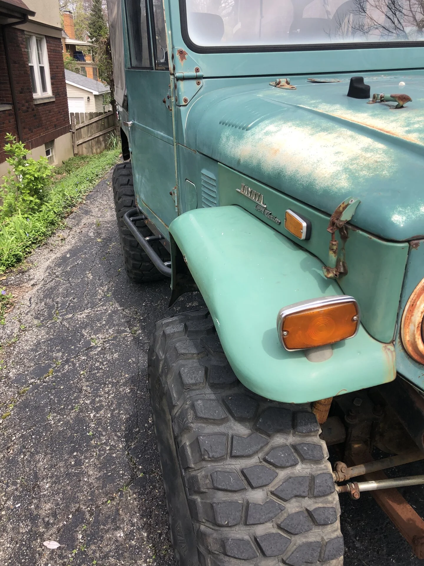

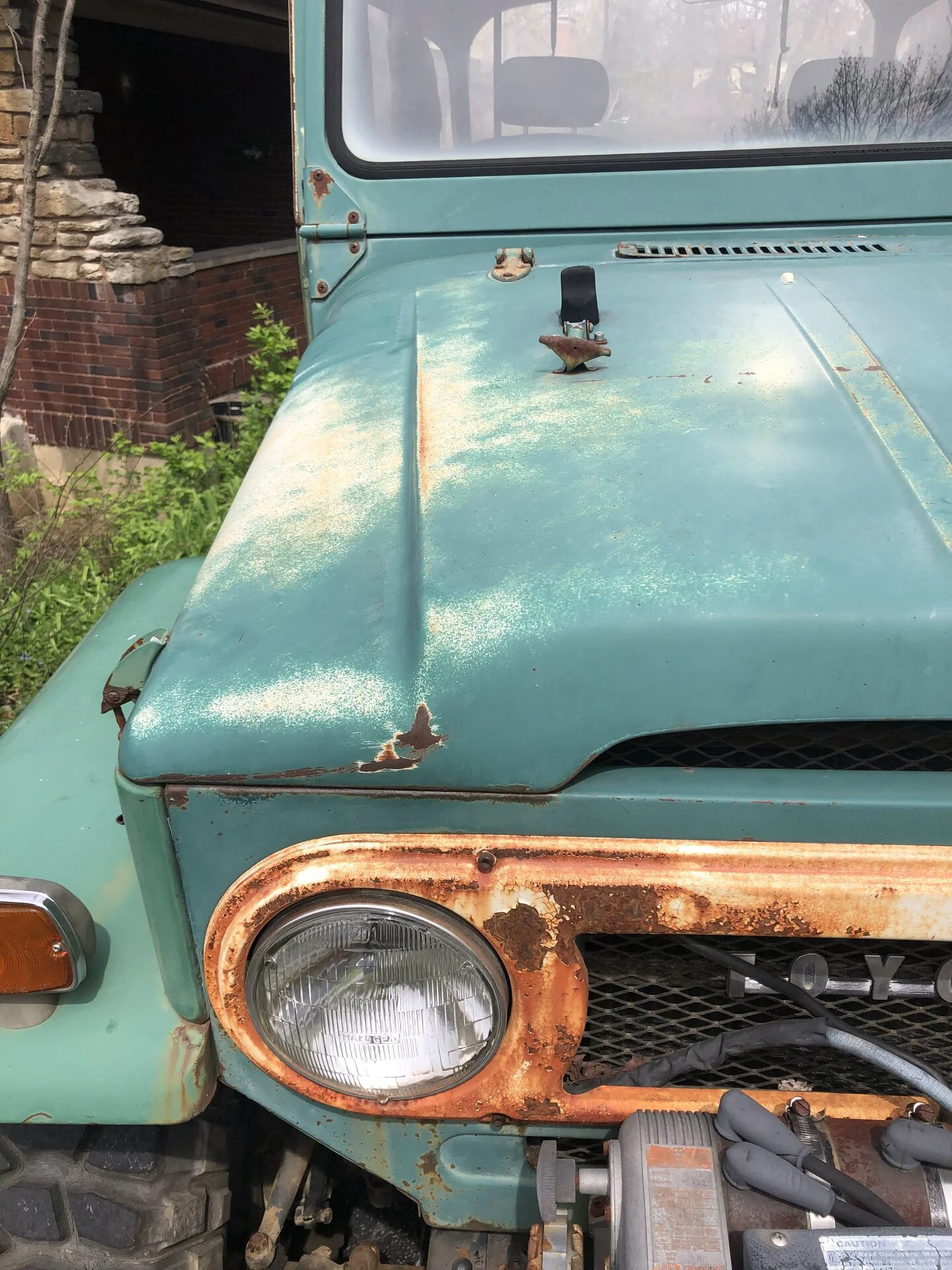

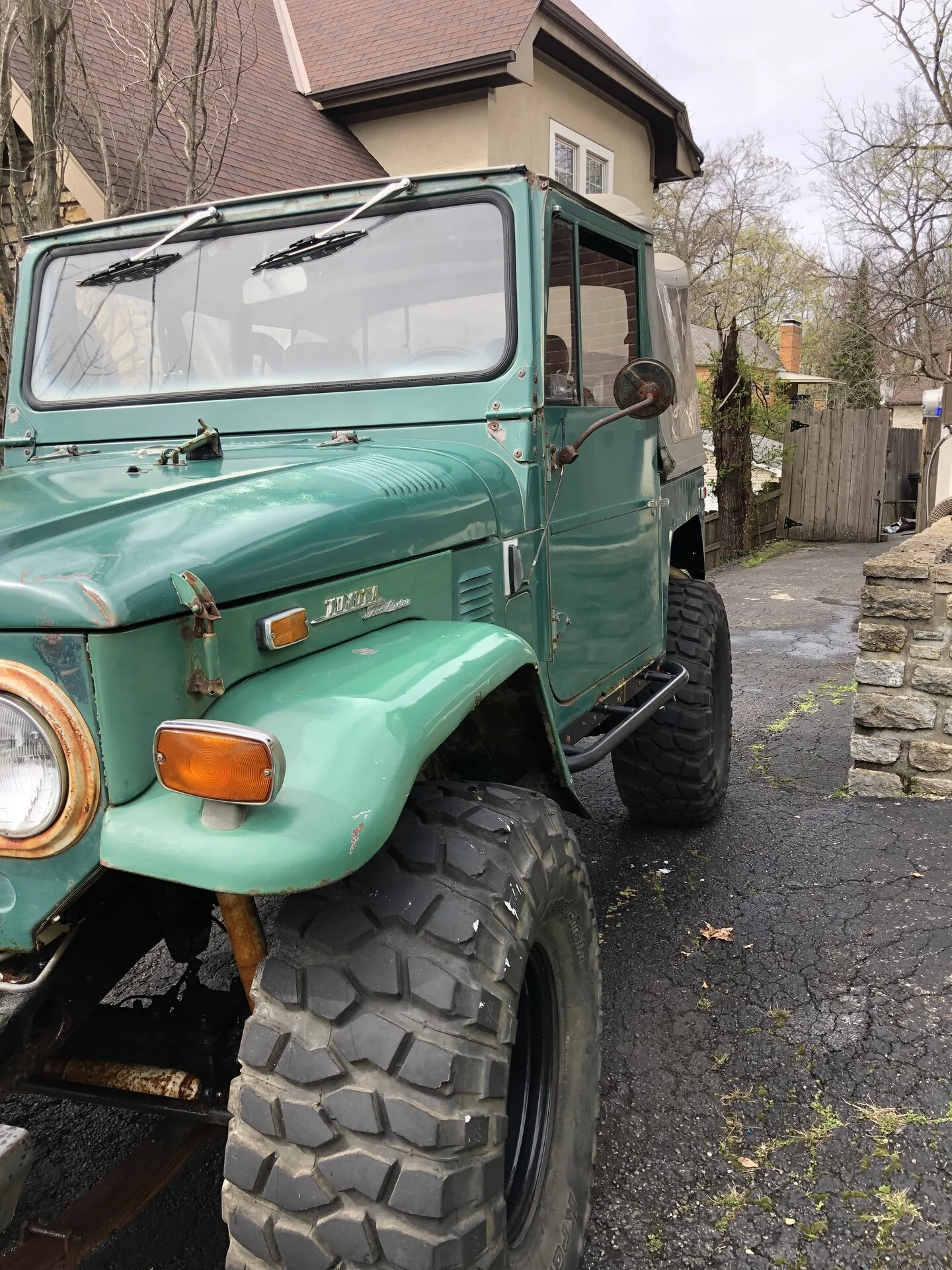

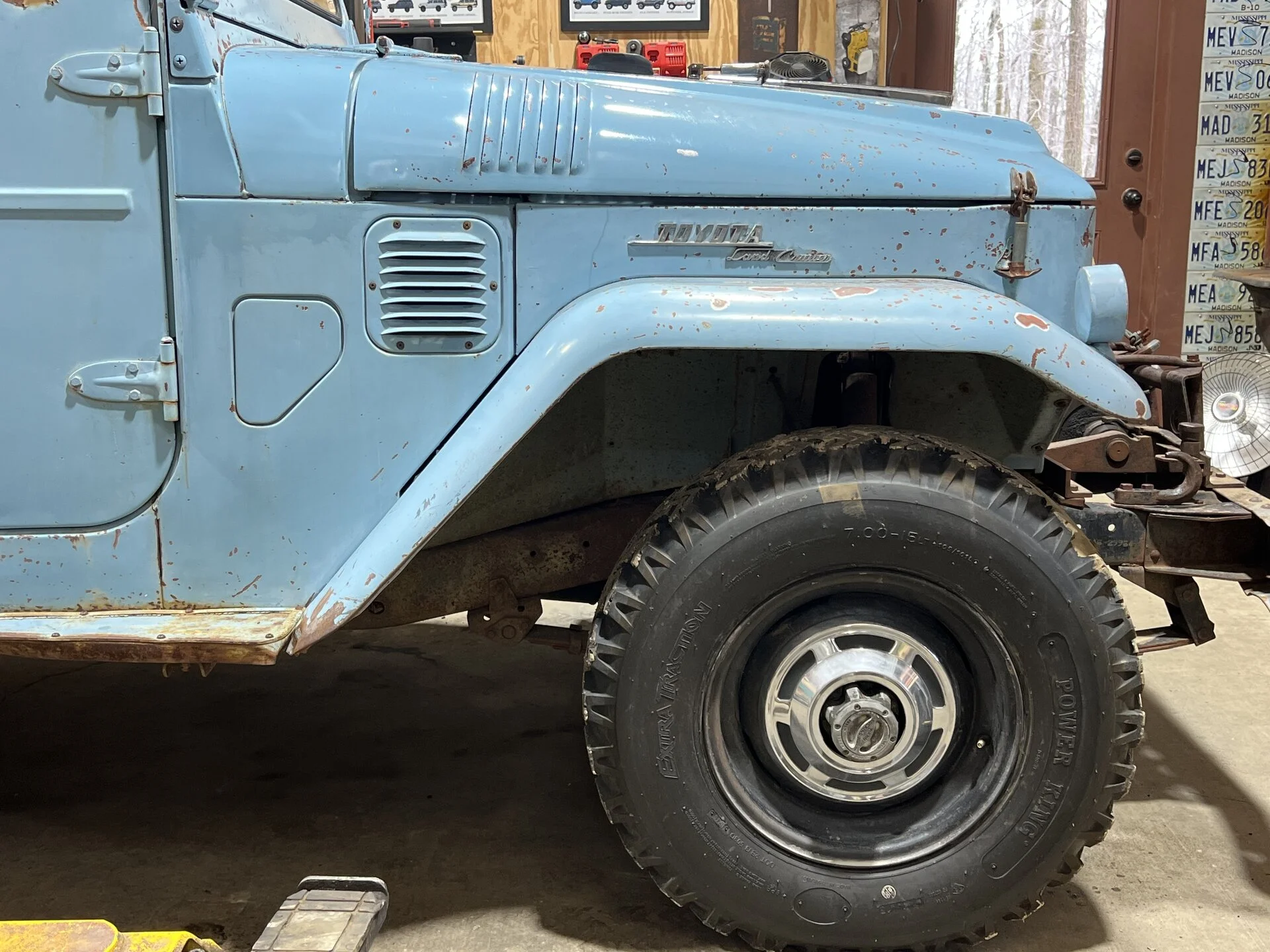

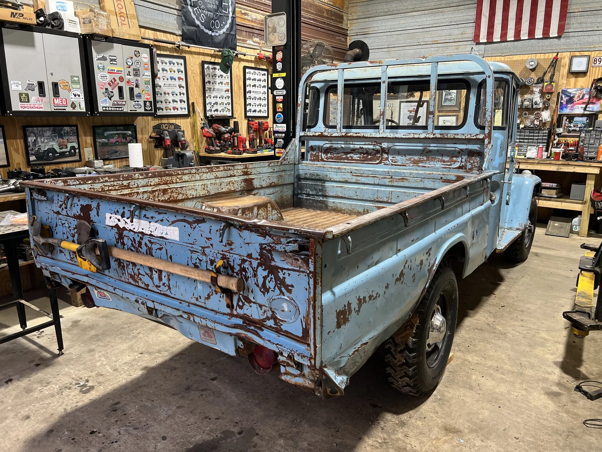

This truck has presented an interesting angle. .3/4 of it had good enough paint for CLR then polish and wax. The other 1/4 I did CLR and fluid film. It’s turning out great. It’s a dented mess but there is no chaos.

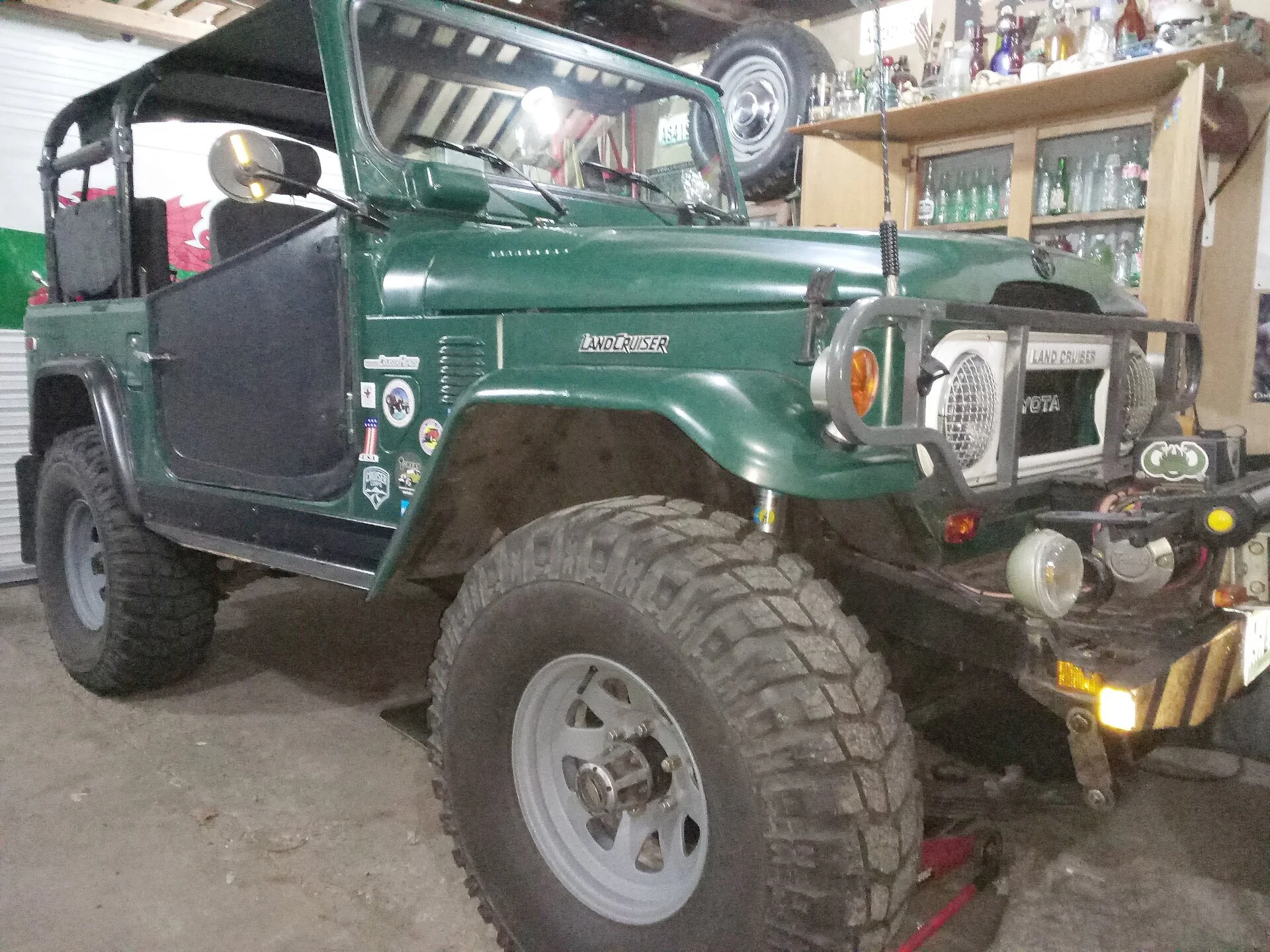

@Vulkyn you need to check out the axe and shovel bracket on this truck, maybe give you some ideas for yours.
They are damn cool. No idea how old they are.

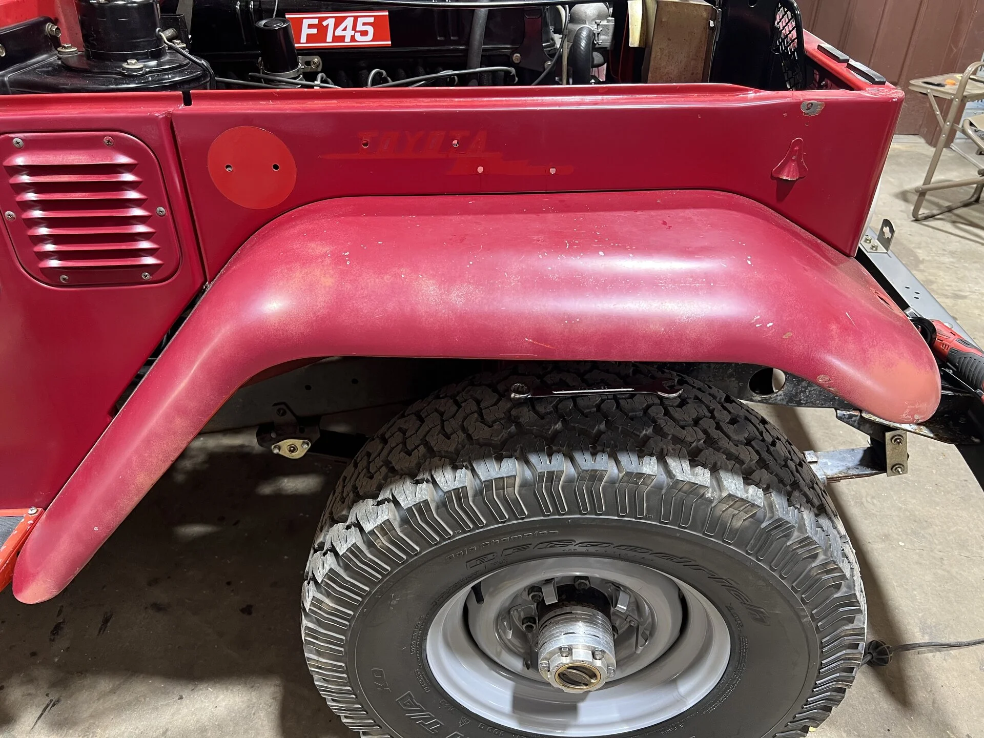

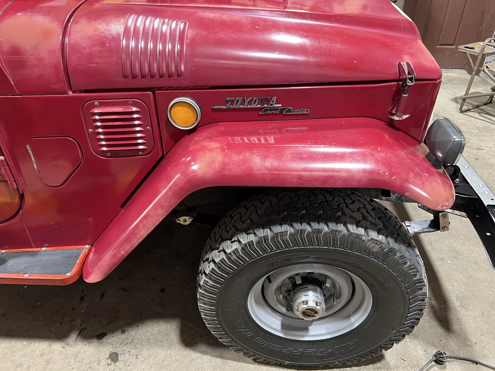

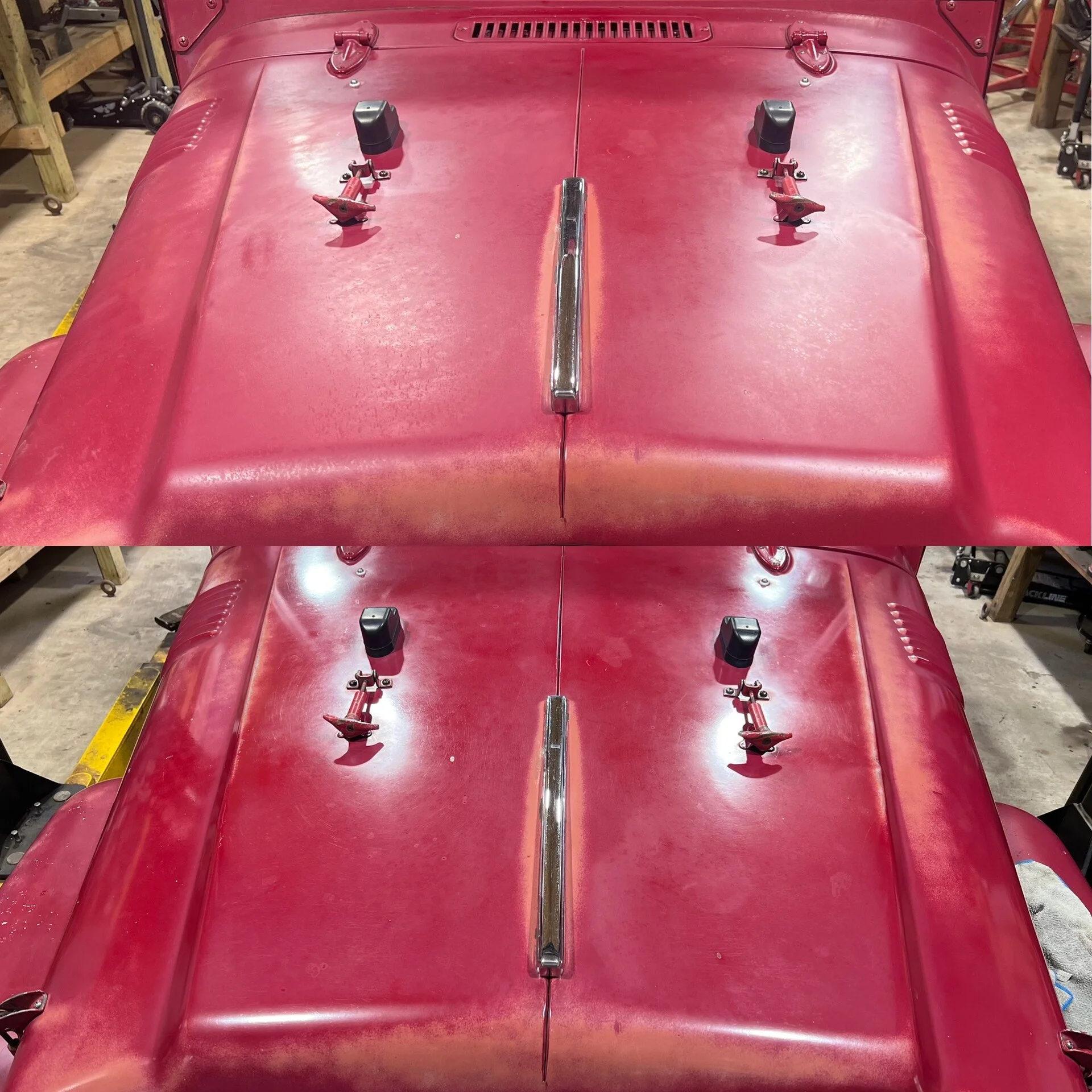

It's amazing how much that brought the color out!
Yeah absolutely, granted the photo hides a lot of the imperfections. I’m really happy with how this turned out. It honestly blows me away! Interestingly, this truck had been resprayed at least 25+ years ago, so I recovered a non factory paint job. I was nervous how the cheaper paint mind hold up.
