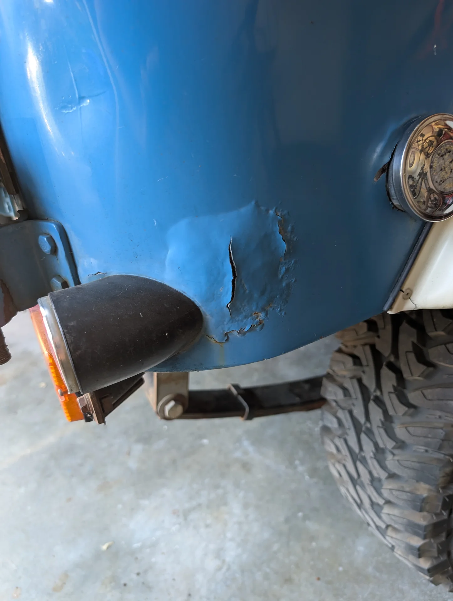

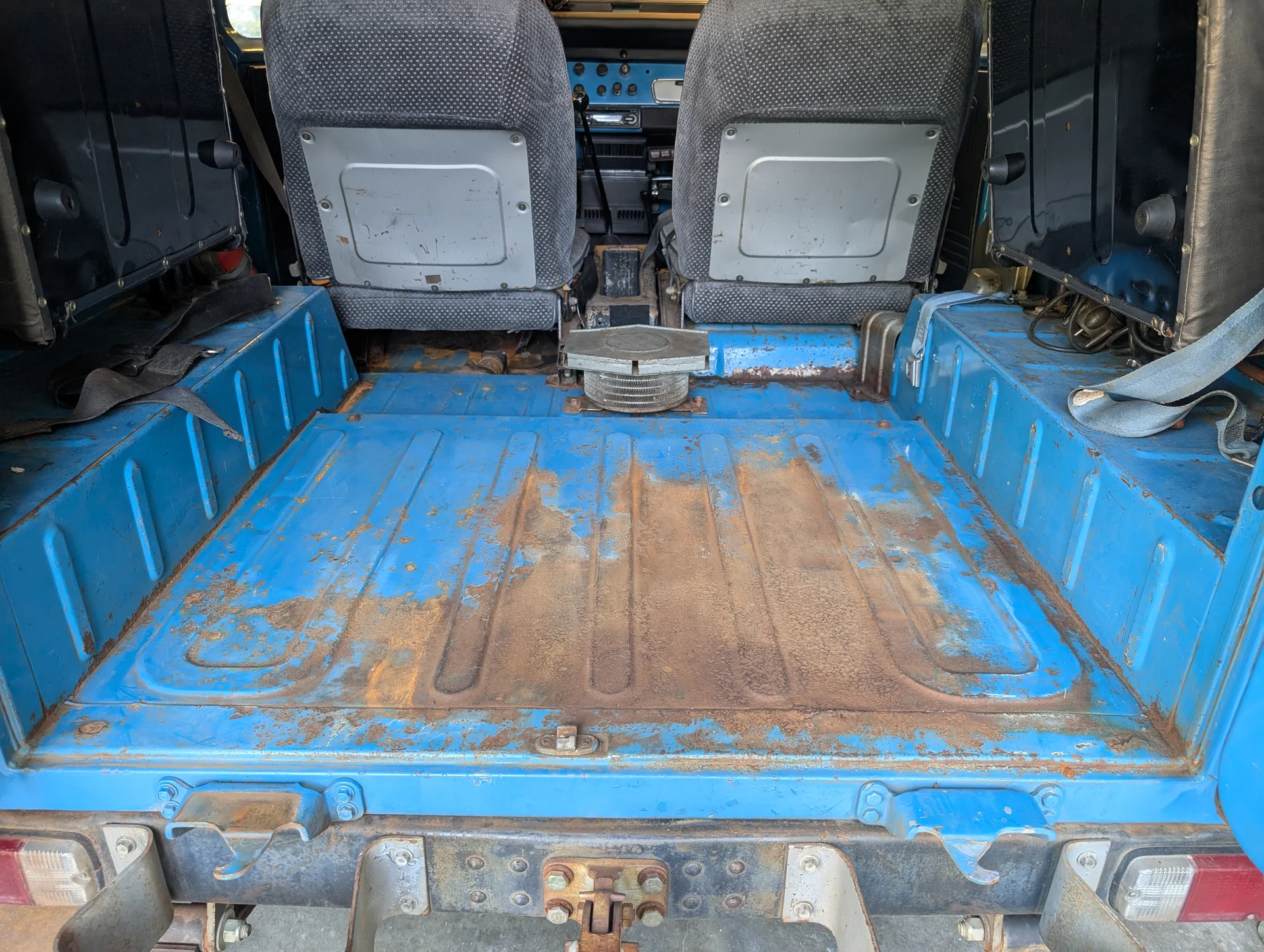

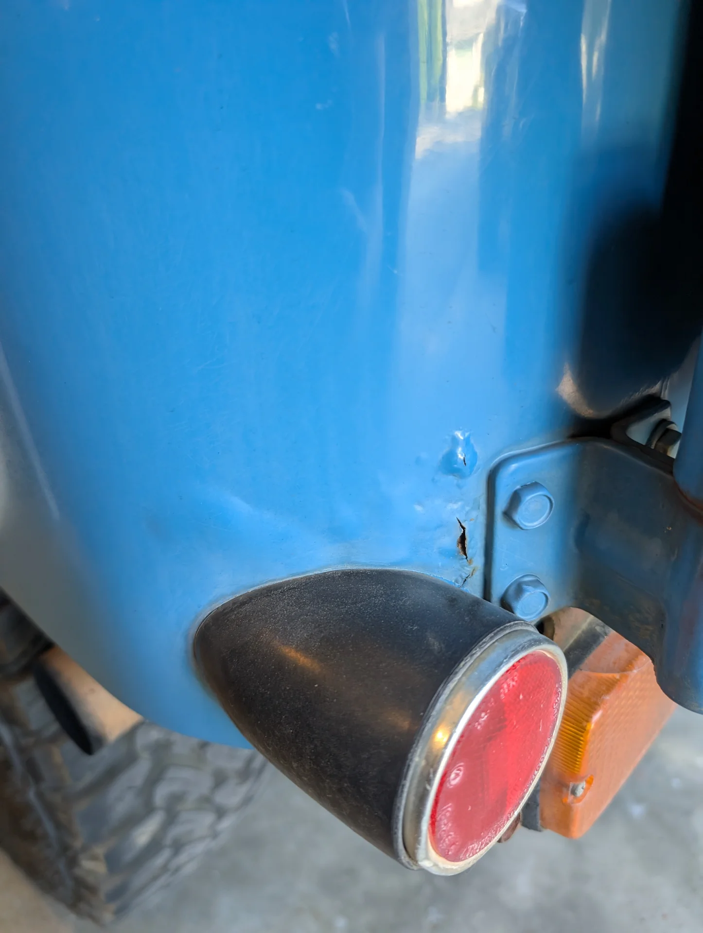

Thanks- I just got a '76 and am looking to clean out the interior and stop some surface rust from spreading. I can try to load some photos a bit later when I have the chance.
Here is what I am working with:
- worst: bubbles near the rear lights, and inside rear lower corners of hard top.
- mid: rear sill - some significant areas, but still seems solid
- surface: interior of tub floor.
I am hoping to preserve this rig as is, prevent further degradation, and take it back as much as possible to stock. Any input for how to proceed would be much appreciated!
I am fortunate that much of the paint is still there and good, and planning to try to restore with a clr wash in rough areas, but otherwise a wash and polish.
