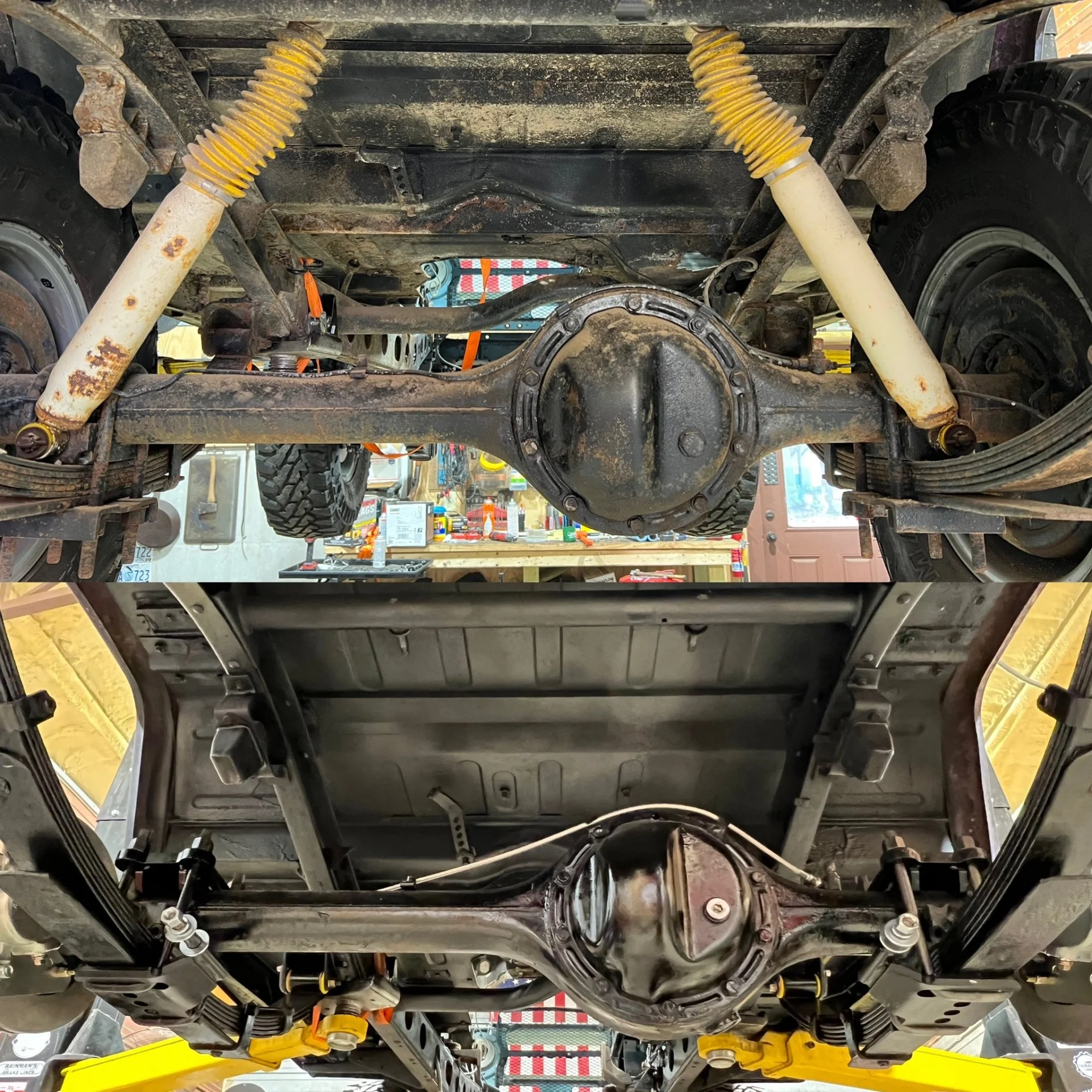

Underside I dry clean the frame and body as much as I can. Chipping mud out of the frame and using a air gun and vacuum
I then wash and scrub
Let it dry and then I either coat with undercoating or
Paint.
Once I finish all of my mechanicals I hose them with fluid film to get all the spots I missed
So you paint and also fluid film? I get that the film gets into places you missed, but you feel it also protects the newly painted surfaces?
Even on a newly painted underside this stuff gets all in the mounts and in the frame. On fresh paint it makes cleaning really easy.

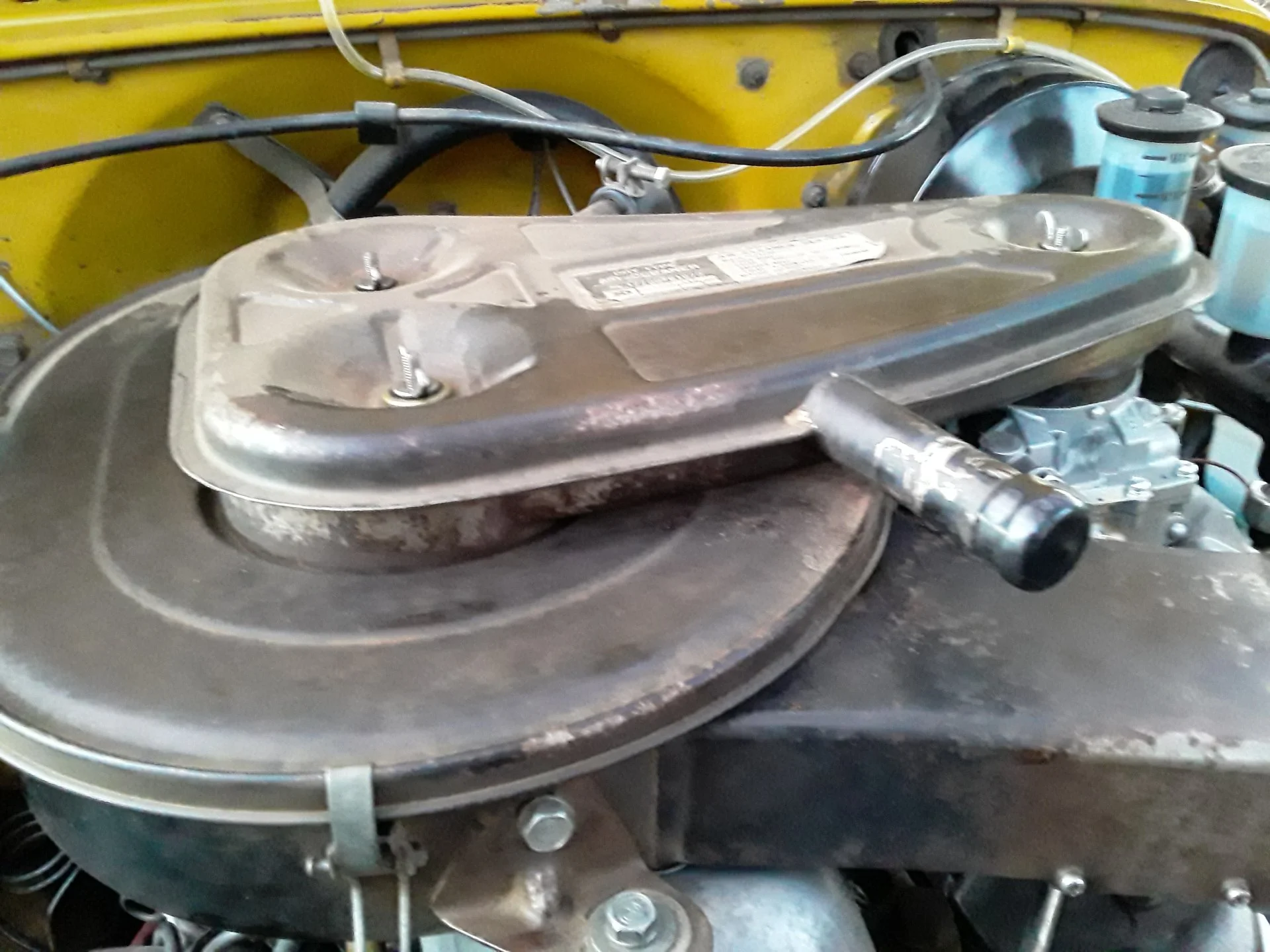

Steel wool and lanolin make for anything but a sheepish Cruiser. This time, I specifically used Boeshield (here, I'd prefer a thin white wax film over the dust magnet of the lanolin-based Fulid Film). This air cleaner assembly was like velcro catching all the lint off of a rag, but after getting the 0000 steel wool treatment, it easily wipes without catching rags, making it nice to maintain at an unrealistic level of cleanliness for something that is going to be exposed to an unfathomable amount of New Mexico clay and silt. I was amazed at the level of smoothness I was able to accomplish without removing too much paint and rust.

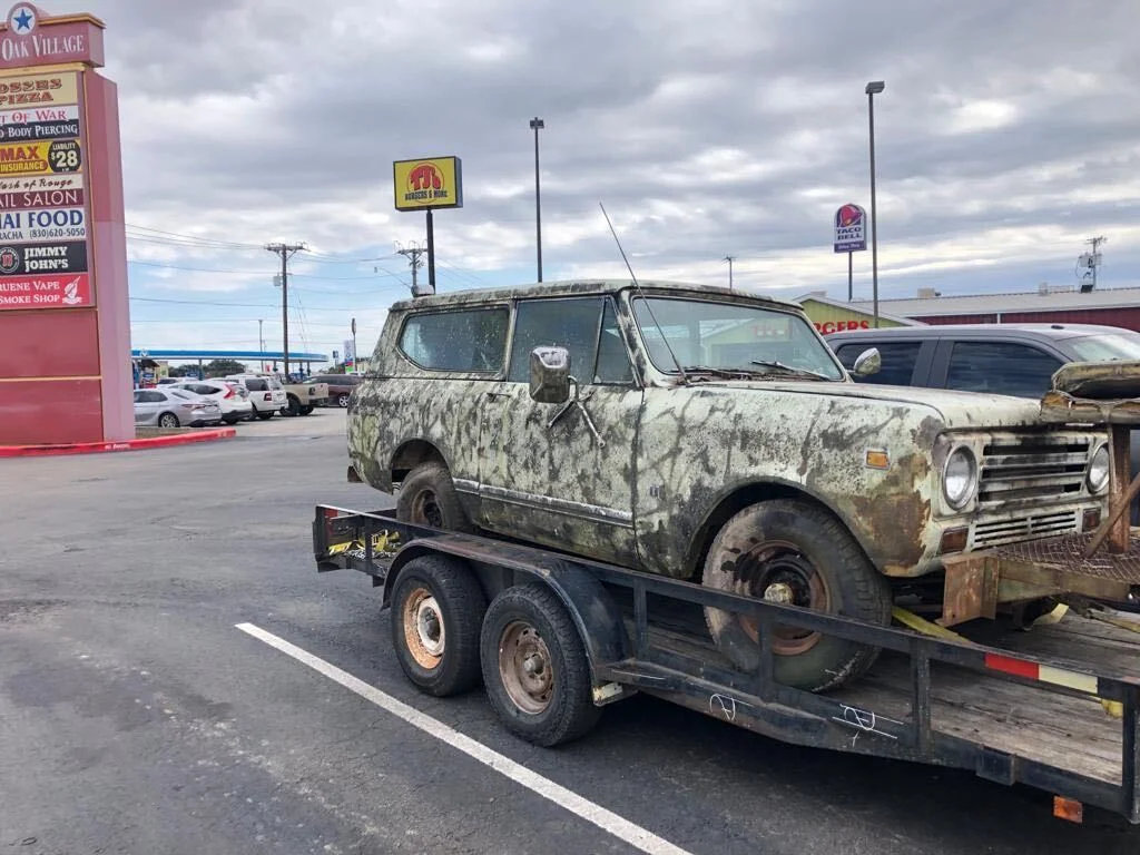

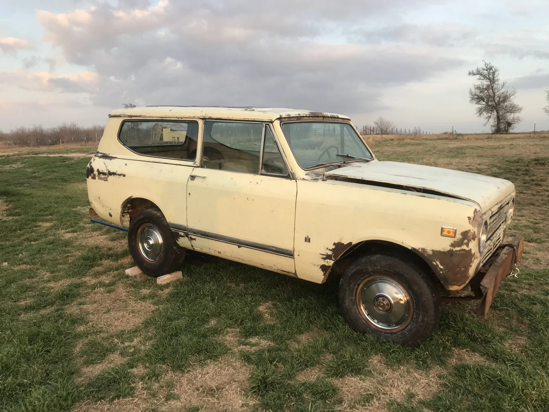

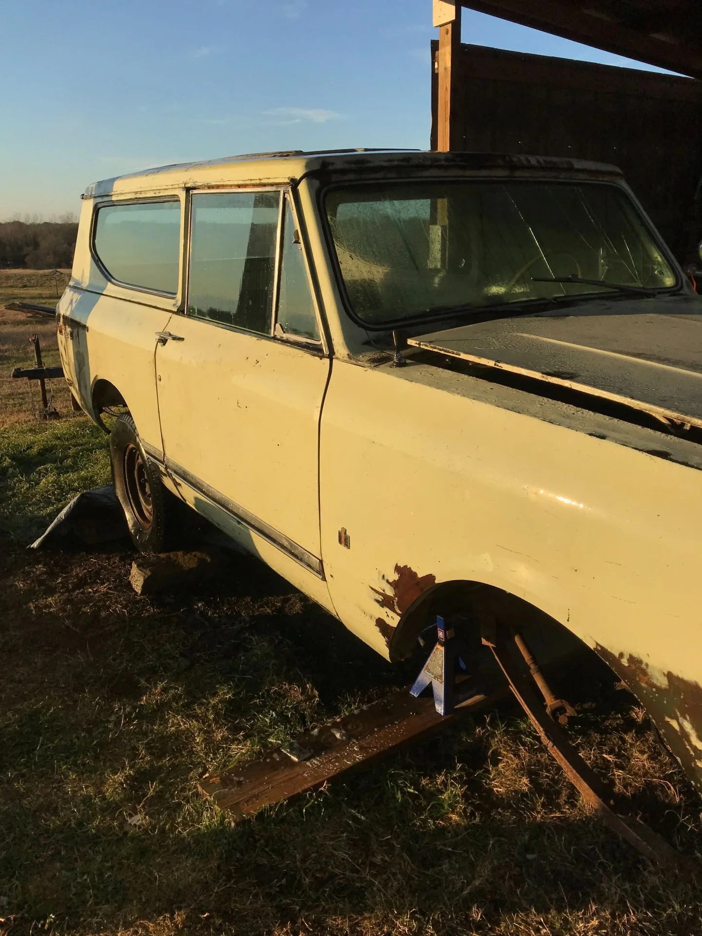

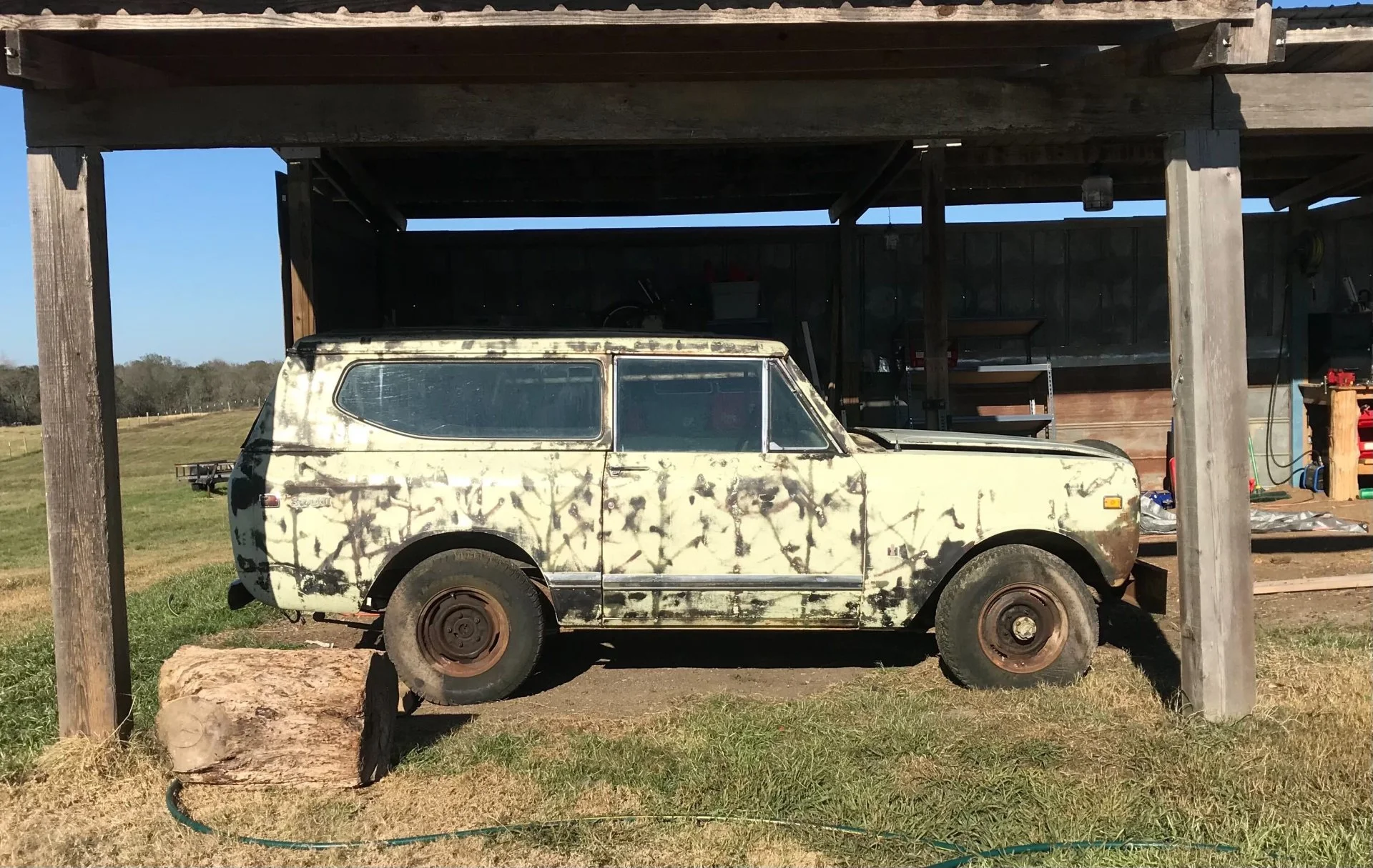

Not a cruiser, but hoping for a decent patina truck. This '71 Scout II was sitting for close to 20 years before I got it and all the grime shows! Other than the junk growing on the truck I also had to deal with the rough "mossy oak" paint job the PO added. Started with a CLR clean and goof off/lacquer thinner combo to remove the camo paint job. I have a few little spots to clean up before I finish with Boiled linseed oil, but this is already a heck of a lot better!

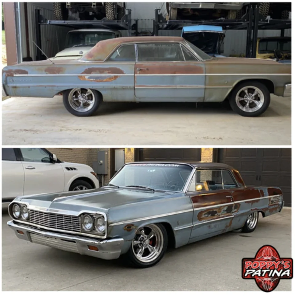

Thought I’d share - I came across an ad for Poppy’s Patina the other day. I have no affiliation with this co and have never tried it, but it seems relevant to preserving patina when there is rust. Apparently you can wipe it on? I’d never heard of it before and apologies if it’s been posted already.
Image taken from their site:
The "can use a catalyst but it's not necessary" makes me think it is an enamel clear coat of some sort.

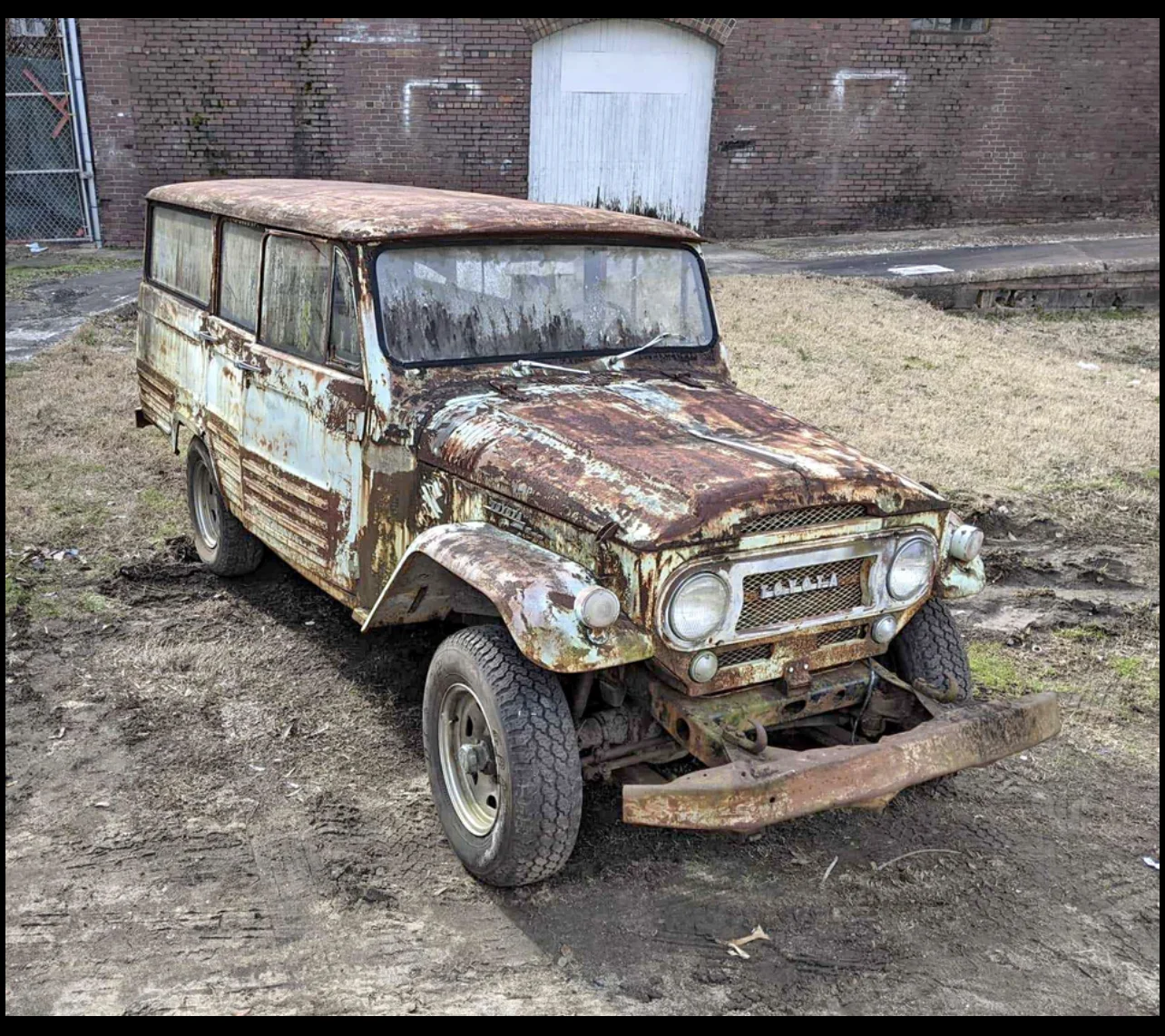

@wngrog Wondering if you've ever used high pressure water sprayer to lightly strip second coat of paint? Our 40 has a bad second paint layer over mostly good original paint. I've been able to remove some with a wet razor blade, but some paint is better adhered in places and I risk scratching the good paint. Would love to strip off the second layer to expose what's underneath. Any advice? (Apologies if I missed an earlier post.)
Pic of our rig:
@90WT try soaking in easy off oven cleaner, wait 5 minutes then use grey scotchbrite
Can also try graffiti remover, sit 5 minutes and high pressure water. Then try the oven cleaner after.
Have had good luck with EasyOff on my crappy primer job from previous owner.
