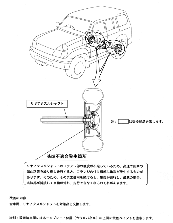

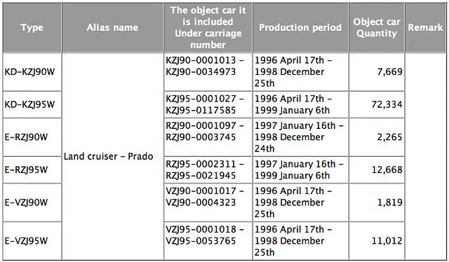

For those not familiar with the rear axle shaft recall issued earlier this year, I found this official communication from Toyota were exact vehicle IDs are specified:
http://toyota.jp/recall/2006/0516.html
(go to http://babelfish.altavista.com for a quick translation)
"...a crack may occur in the Prado's rear axle shaft if it is repeatedly driven on winding roads in the mountains at a high speed, it said, warning that a wheel may come off in the worst case."

I asked from Toyota about my KZJ90. And answer: "Due to the fact that your vehicle does belong to this recall, we kindly ask your to refer to your local TOYOTA dealer to change the necessary parts."
Let´s see how it goes...
Toyota Chile got back to me. They say that the Prados they imported are RZJ90L and the recall applies to RZJ90W models. The weird thing is that the person I spoke to claims that W stands for Japanese Domestic Market (which makes me doubt him) We all know that the L stands for Left hand drive, and this recall applied to many countries.
For the record: I 'm still not convinced.
