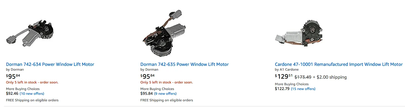

My driver window goes up and down fine but the motor makes a ton of noise when doing so. I took it all apart and nothing looks out of the ordinary, so I'm assuming its the motor part of the regulator going out. New ones are close to 300, has anyone tried out the Dorman? Thanks
Whenever mine get noisy or sluggish, I clean and lube the channels that the glass rides in. They always work like new afterwards. I'd give that a try first.
