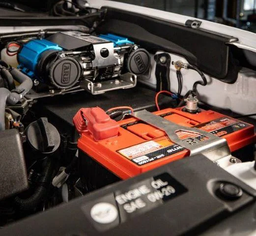

Let’s talk about power. No, not the kind of power Thor feels when he picks up Mjolnir? (hammer?), but it’s pretty damn close. Your mobile power supply is everything when you’re out on the road. If you’re not careful you can overload your battery set up with different accessories like phone chargers, light bars, refrigerators, winches, radios and much more. These accessories require power, and not just a little. While Group 31 Batteries seem to be all the rave here in the off-roading community, do you actually need one? Does it replace the need for a secondary battery?
Continue reading --> Power Couple 💞⚡ - https://www.ragofabrication.com/blogs/blog/power-couple-1
Single battery in my 2008 V8 SE. It takes care of winching with my 8274 and all the usual tasks. I have an arb fridge and I am in the process of installing a 100 watt solar panel on the roof to keep it happy when out in the hot desert.
I have a dual battery system using the Eaton 7622 ACR in my FJ62 and I am undecided as to whether it was really needed. I do a lot more winching with that truck so I guess it helps.
I think a single high quality battery (I love intimidator AGMs) will suffice for most needs.
