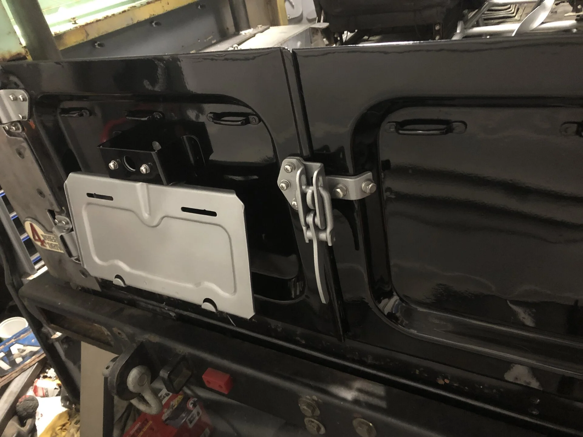

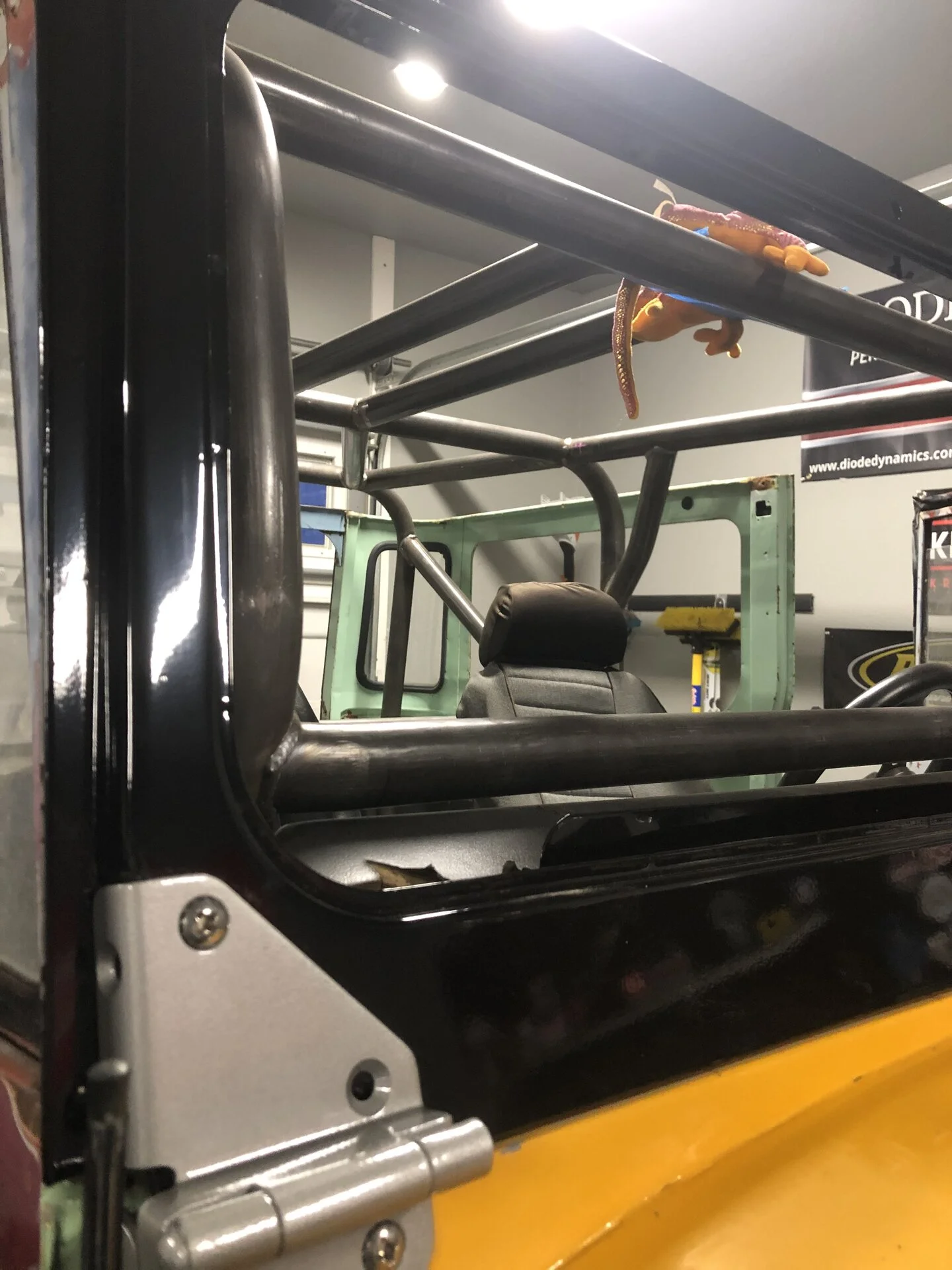

Here are a few pics of my 40 I have been Powder coating . As long as you do not have body work it turns out great. This is my Crawler so a few body imperfections does not really bother me that much . If I was doing a resto I would paint so you could get the body perfect .
