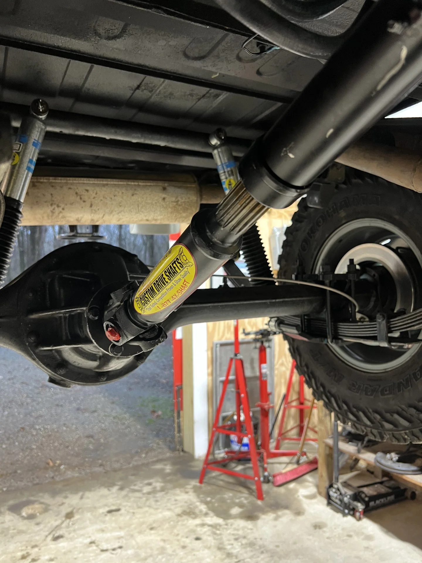

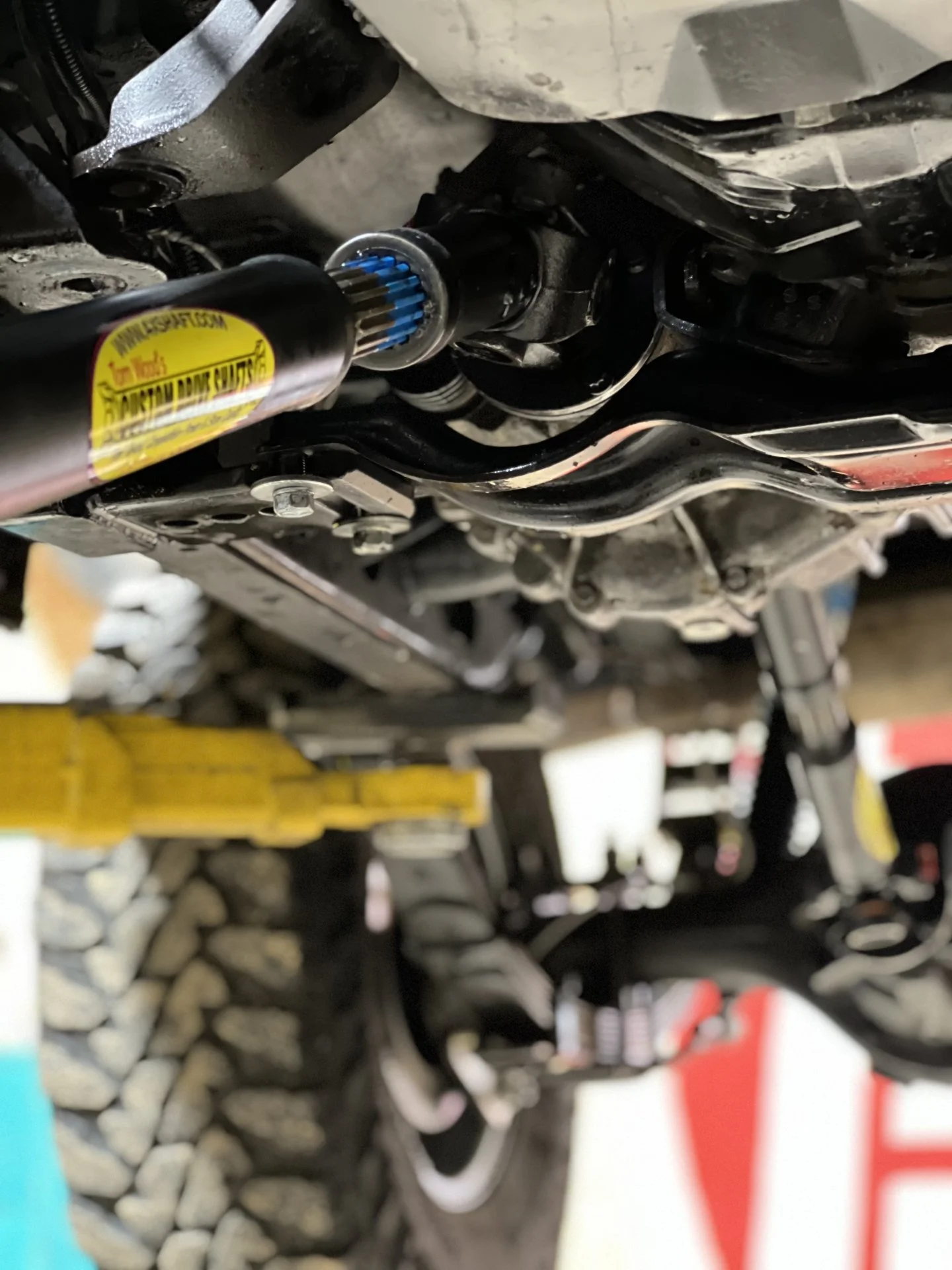

Tapping my foot for UPS to either deliver or cancel…..need those driveshafts. Wanna ride.

UPS showed up late last night. Weekend dude lost but he made it 💯🙌

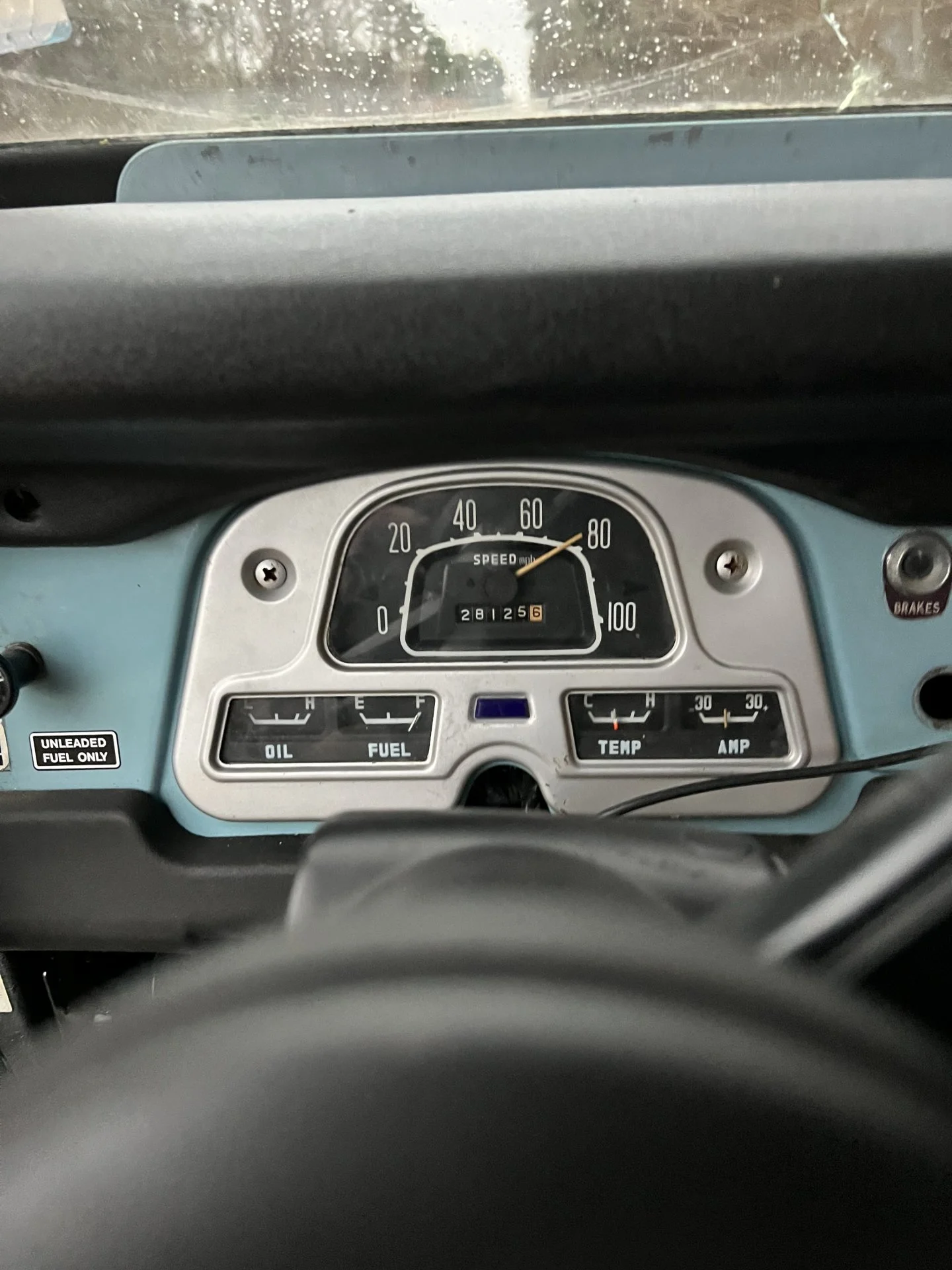

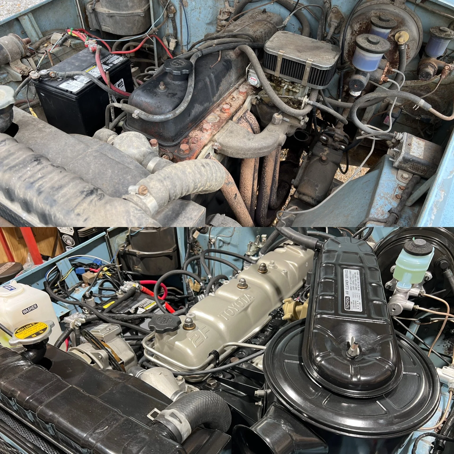

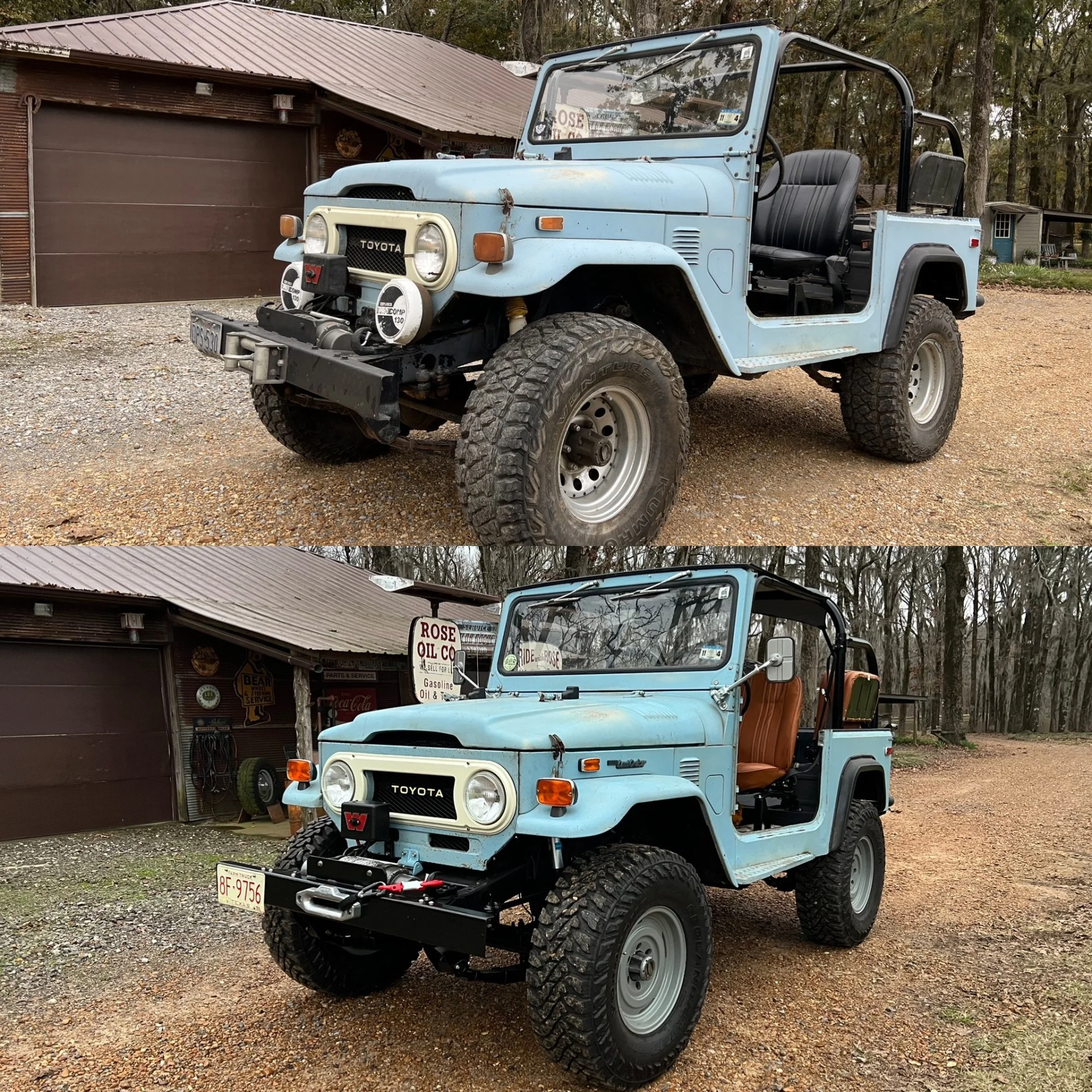

Because I love Before/After shots
Right at 300 hours labor in this truck. I’m glad the Mustard78 of @jomelo was here when they dropped this truck off so they could see a super nice 40 and say “make it like that”

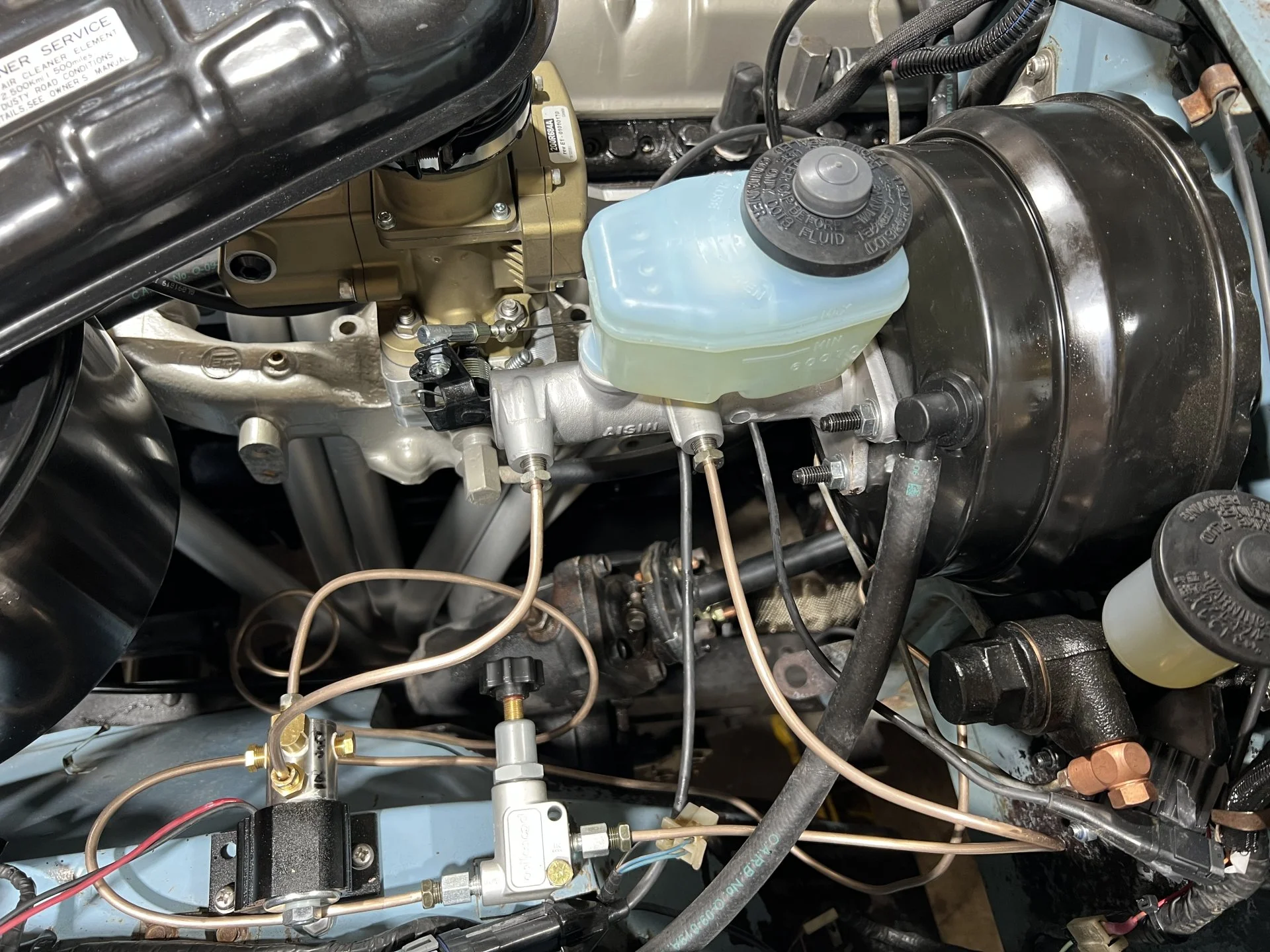

I did swap the brake lines to rear being closest to the master and front to the front of the truck.
Now, even with the Wilwood proportion valve all the way loose it’s locking the rear up first. Not sure if that matters but it was more even this morning before I swapped the lines.
Started on the line lock when I swapped the lines but I’ve run out of day. Tired.

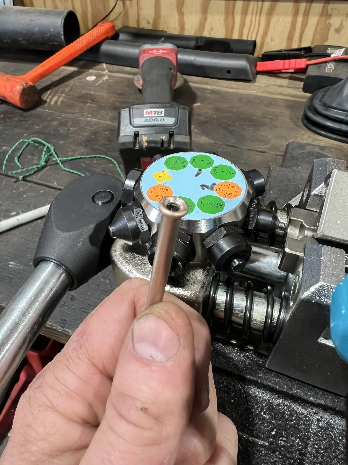

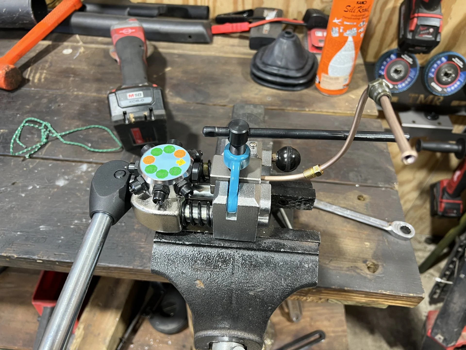

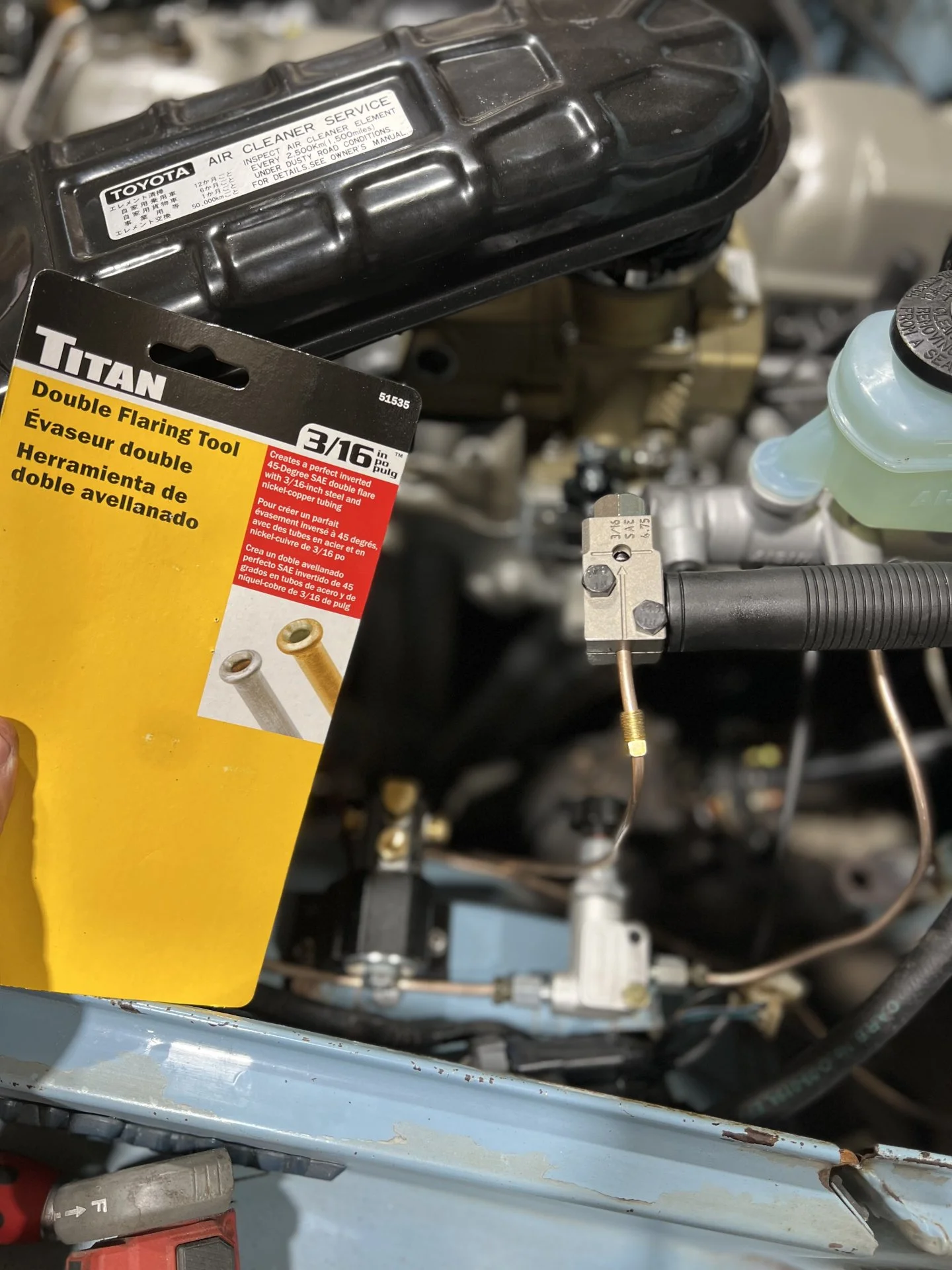

These brake line tools are so clutch.

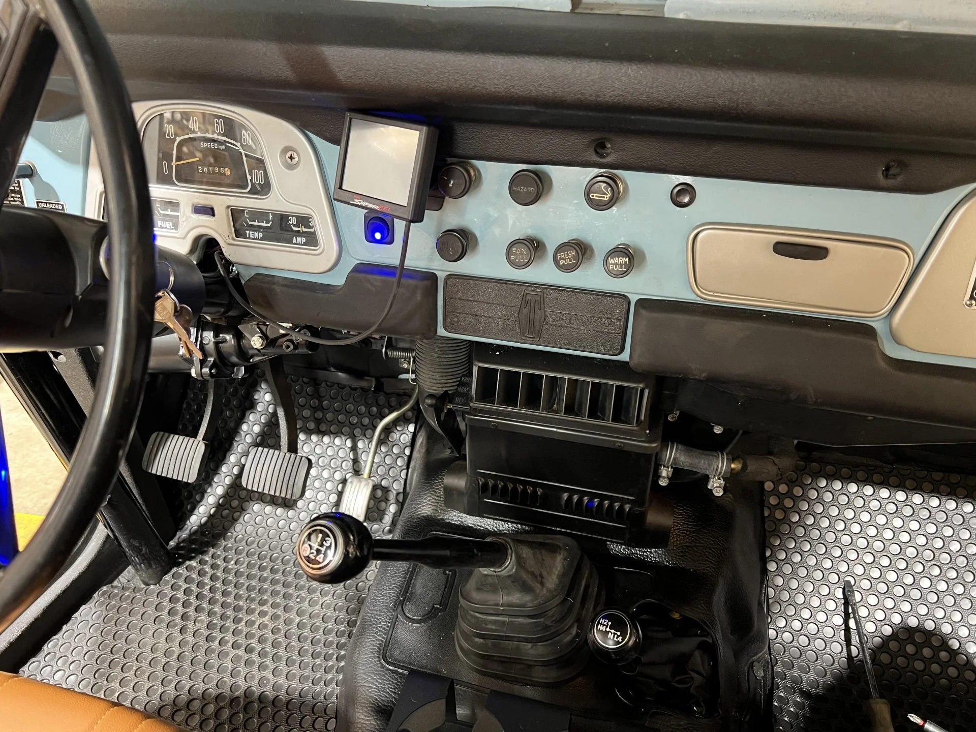

Sniper dealio mounted in a good spot. All systems go.
View attachment 2888883View attachment 2888885
Is that the line tool from Eastwood? Been eyeballin' that one.

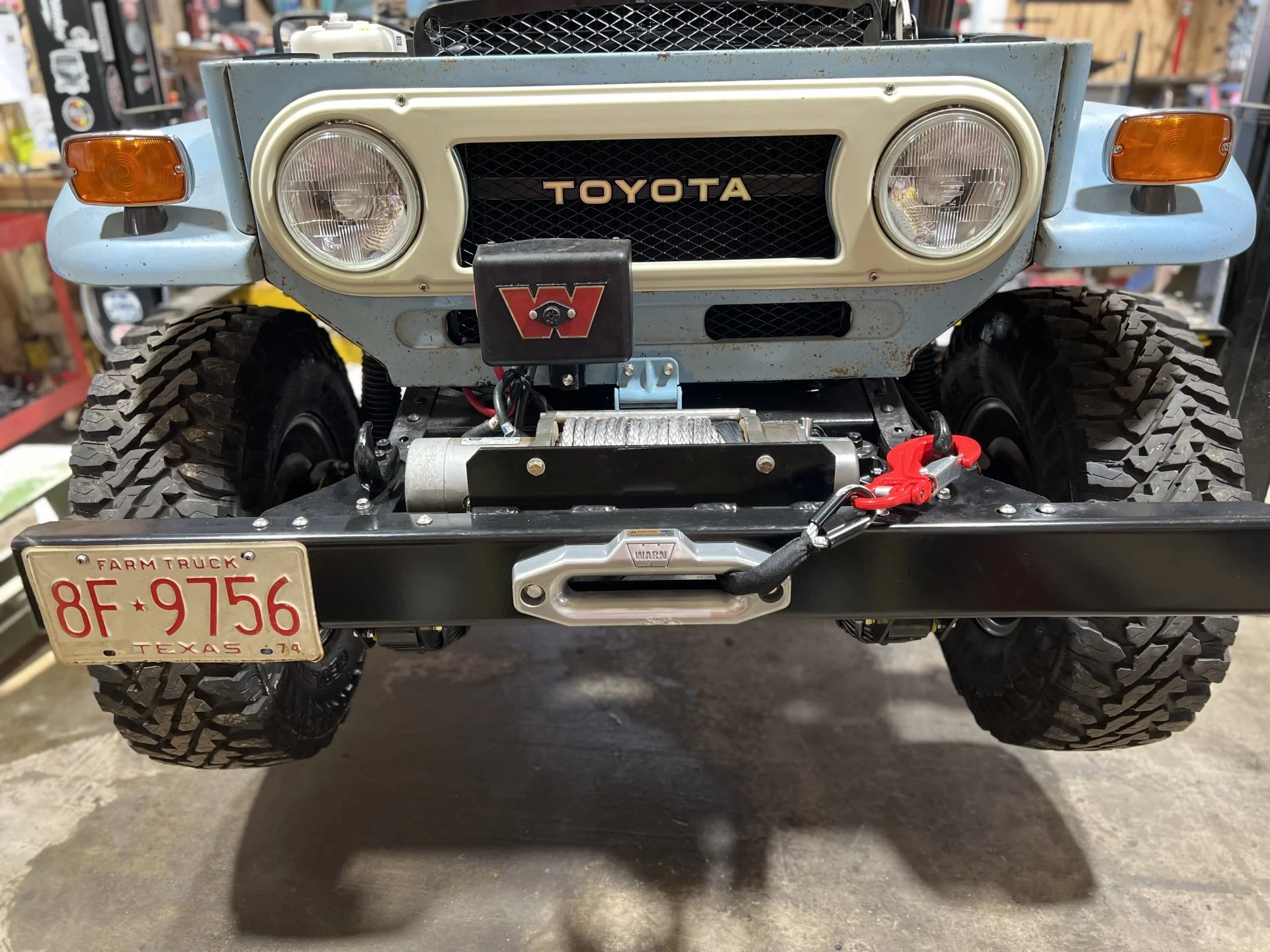

Nice build! Have you considered putting your Warn winch solenoid box under the hood? I am thinking about doing something like that.... as much as I like the look of an 8274, I hate how much of an airflow block they are.
I never have overheating issues with 40s with winches up there
Little stuff done today.
Line Lock installed.
