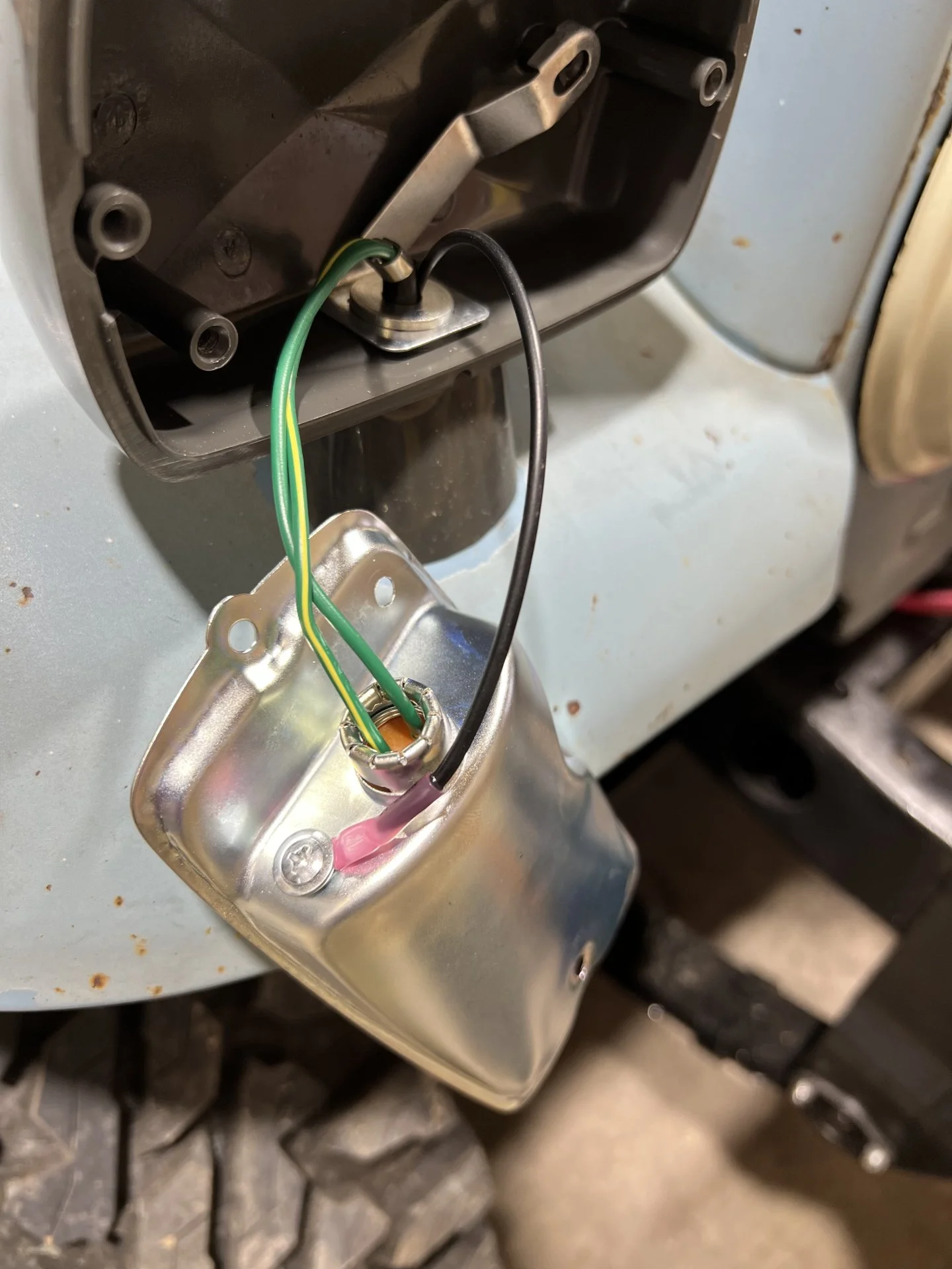

So I opened up each light and screwed a ground into each cover.
This has always been my go-to fix if all else fails but it did not work.

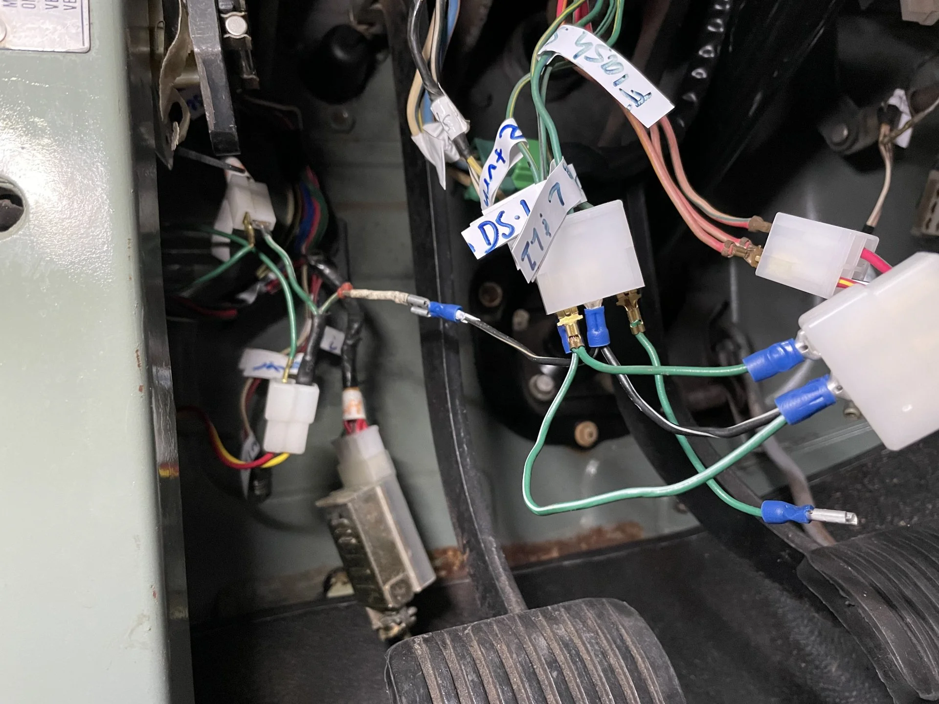

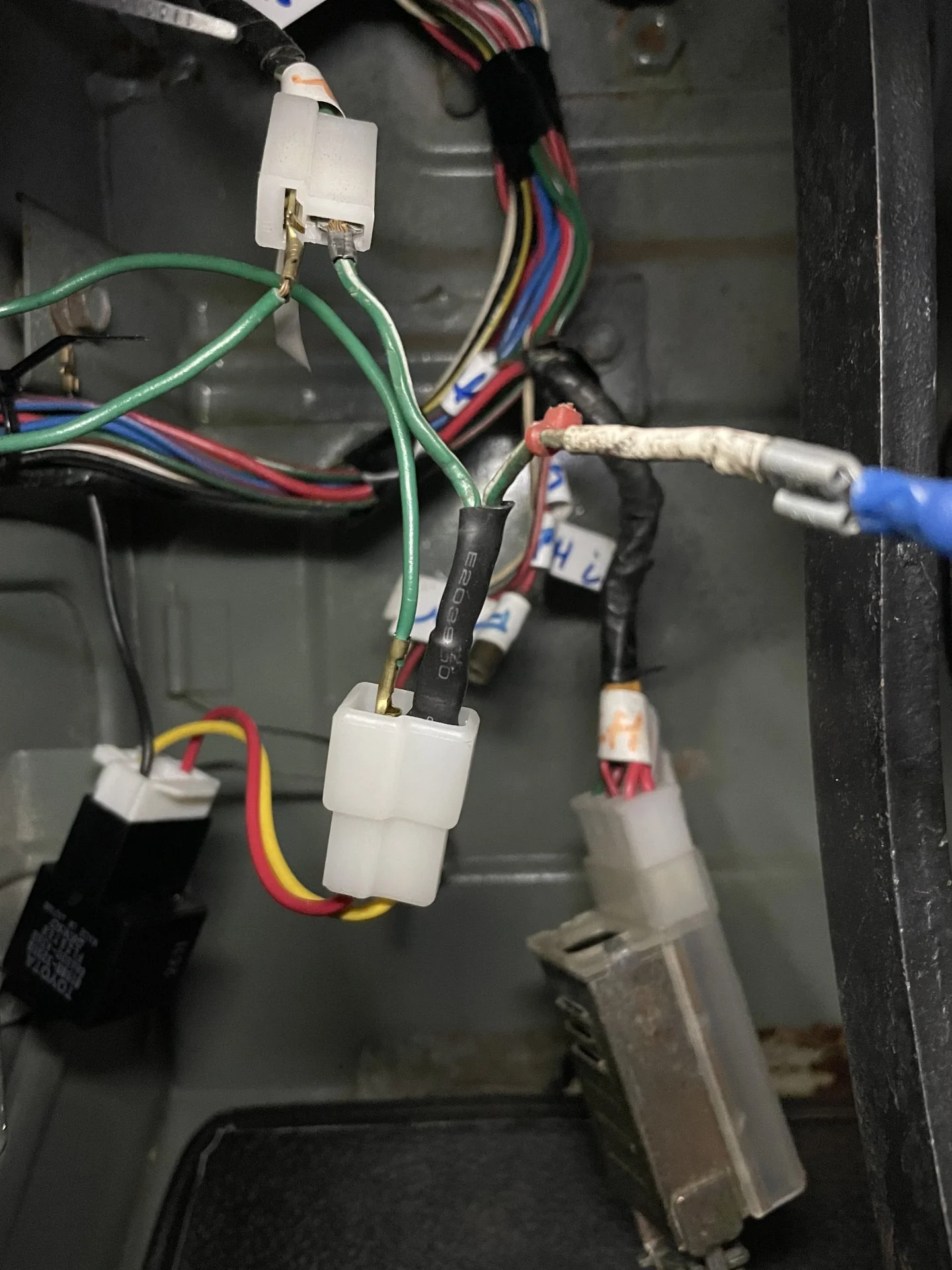

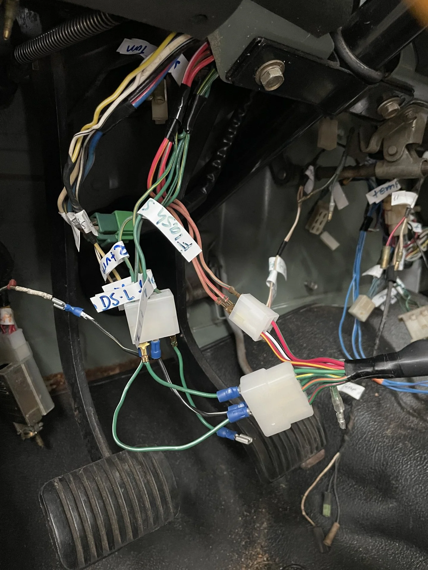

Since it’s kind of last resort phase with the blinkers this is what I had to go through with a severely hacked up harness - tracing wires and making jumpers to test - it took a while but everything works 100% now…I was at wits end several times. We mentioned the turn signal switch - don’t assume it lines up with the correct pins as mine didn’t. I bought a new improved flasher and had to wire that in but I don’t think my old one was bad
What a mess. I sure don’t want to make that. (You cleaned it nicely)
I’ve got a Dakota on order. He’s picking up tomorrow for test miles. I’ll add this to the “next time” list.
