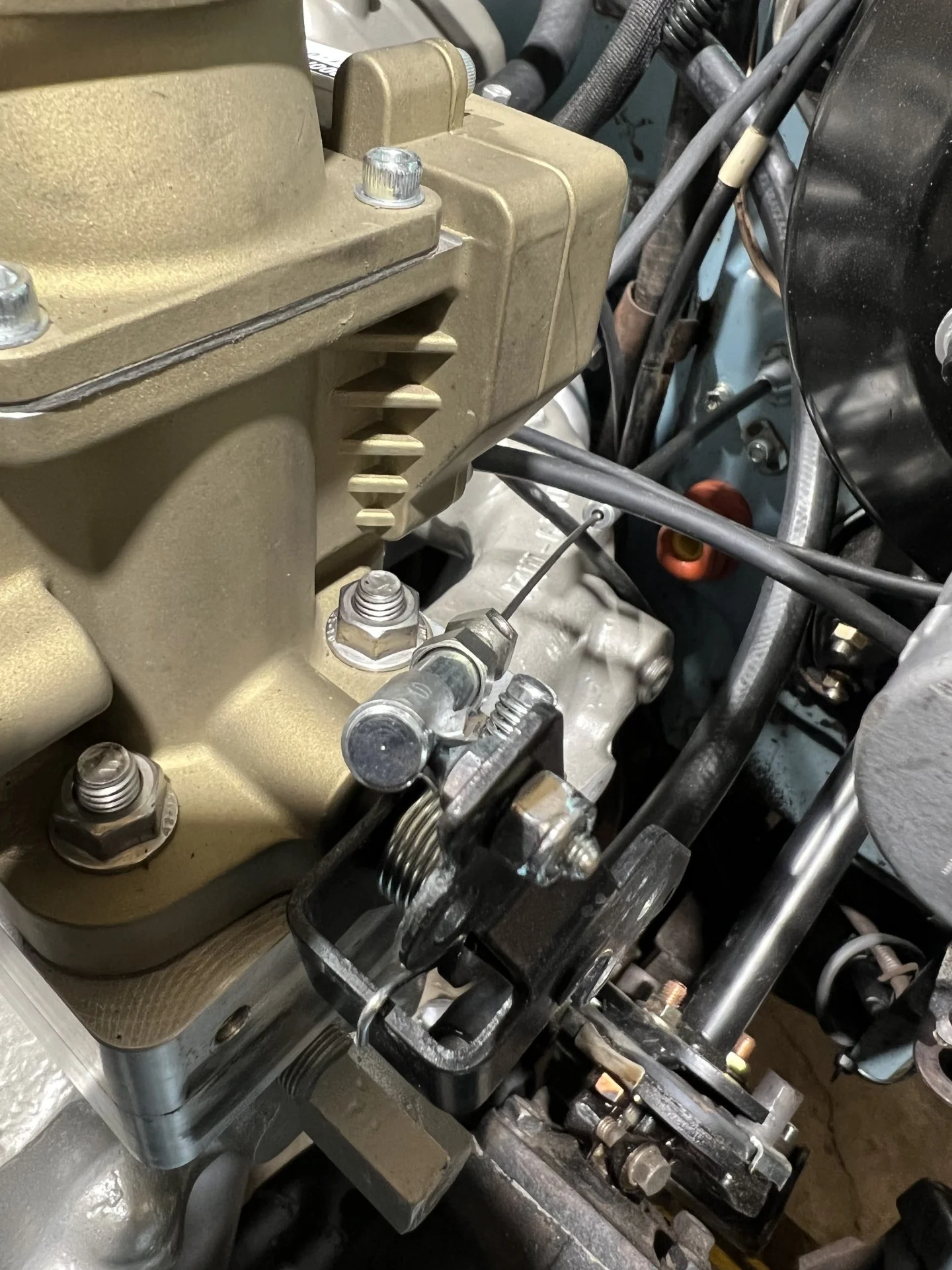

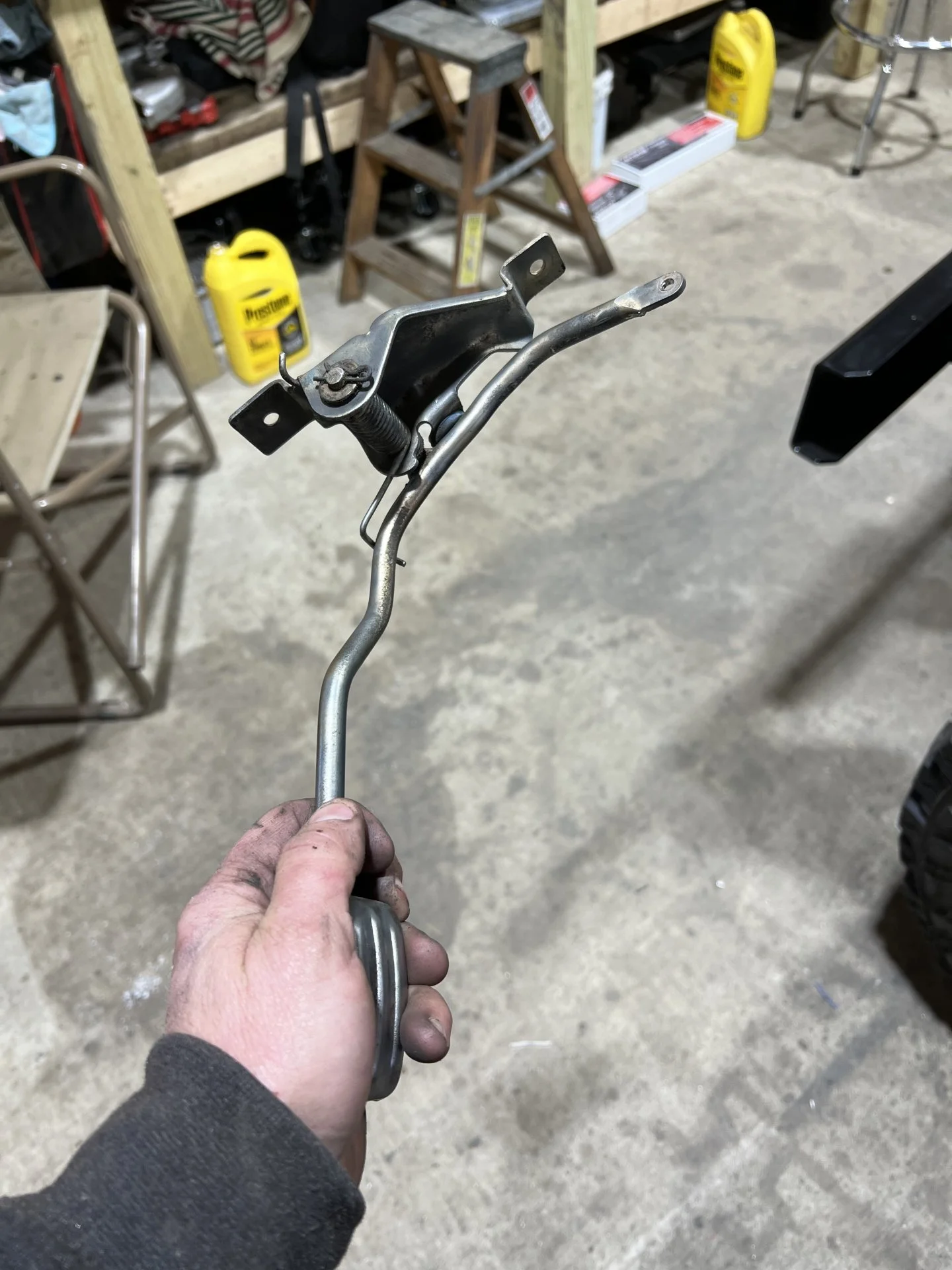

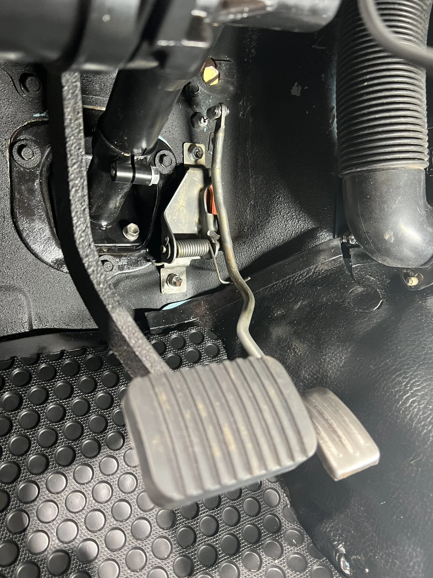

I got the pedal out of my 78 parts truck. Some maniac had jacked up the one in this truck for the Weber cable.
I’ve got it bent right and the knob drilled off for the Lokar cable.
Now the pressure to crank it is on.
Speaking of loud external fuel pumps. I just installed an Automotive A750 on the FJ45 in place of old Bosch and it is ridiculously loud. I will be putting in a much smaller pump this weekend. live and learn.

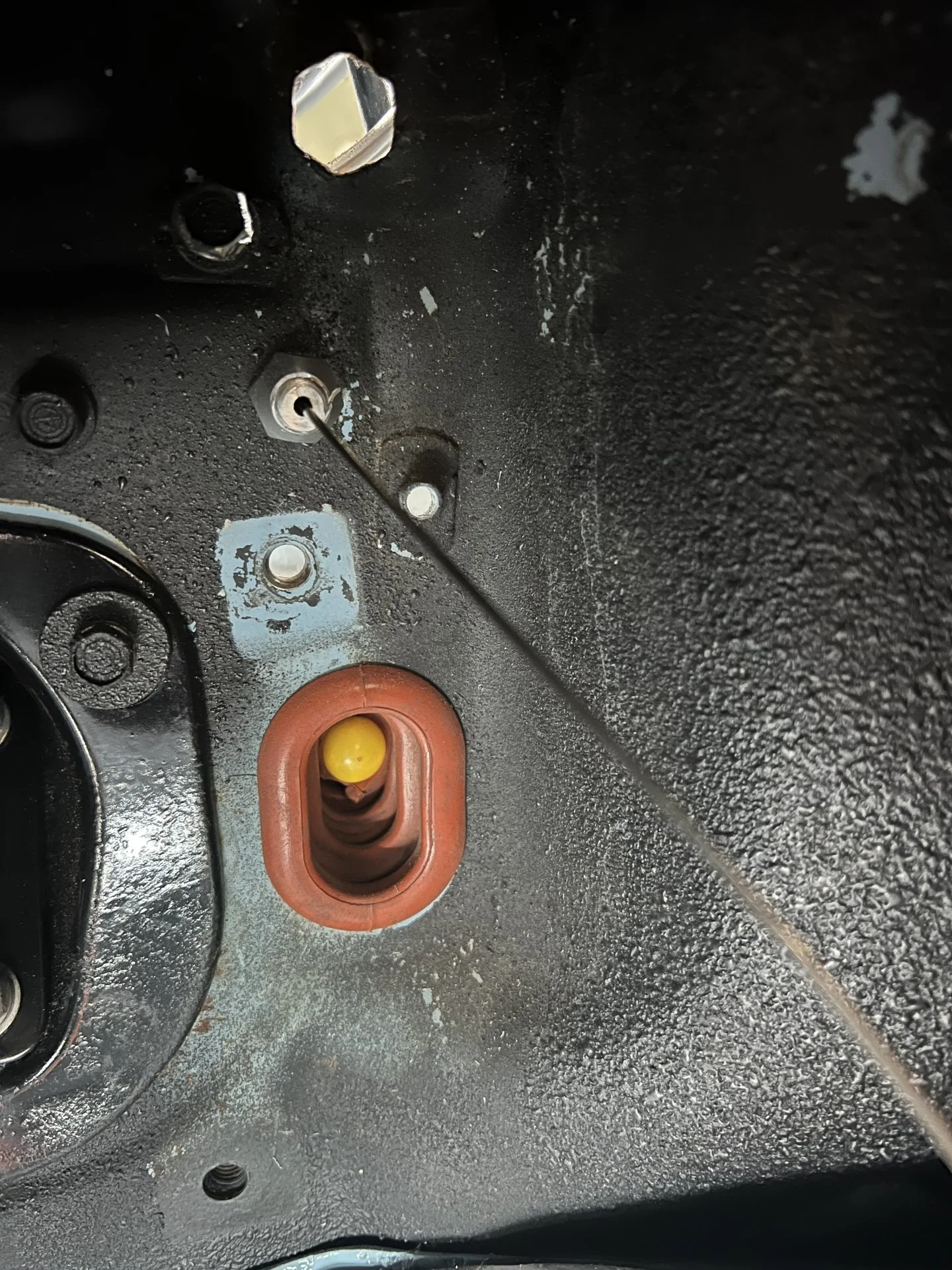

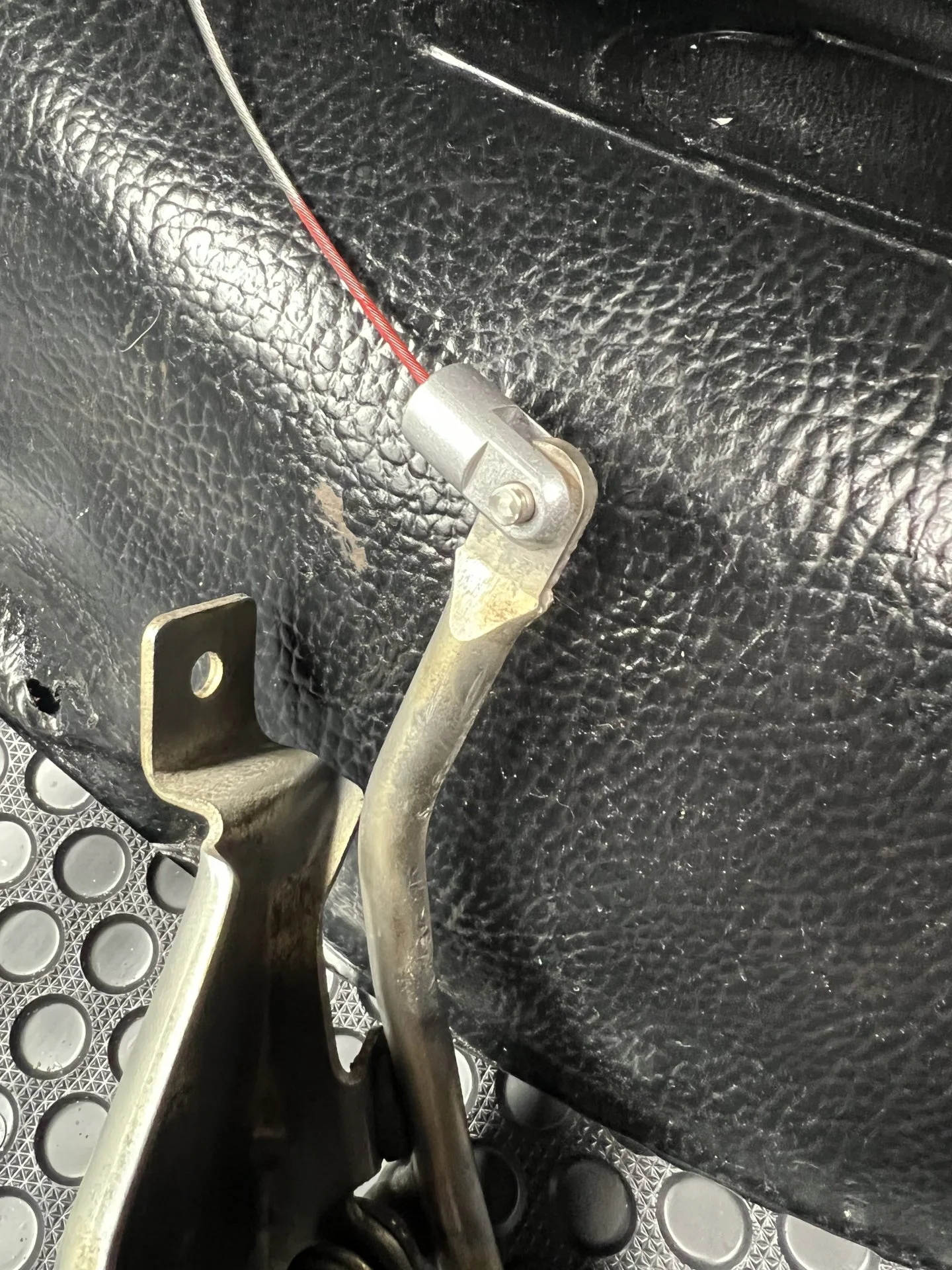

I’ve started doing a direct pull on the cables. It’s so easy I can’t believe I never thought of it before.
Main tip is make sure at wide open throttle your pedal is bottomed out so you are not pulling on the cable when the plates are 100% open.
