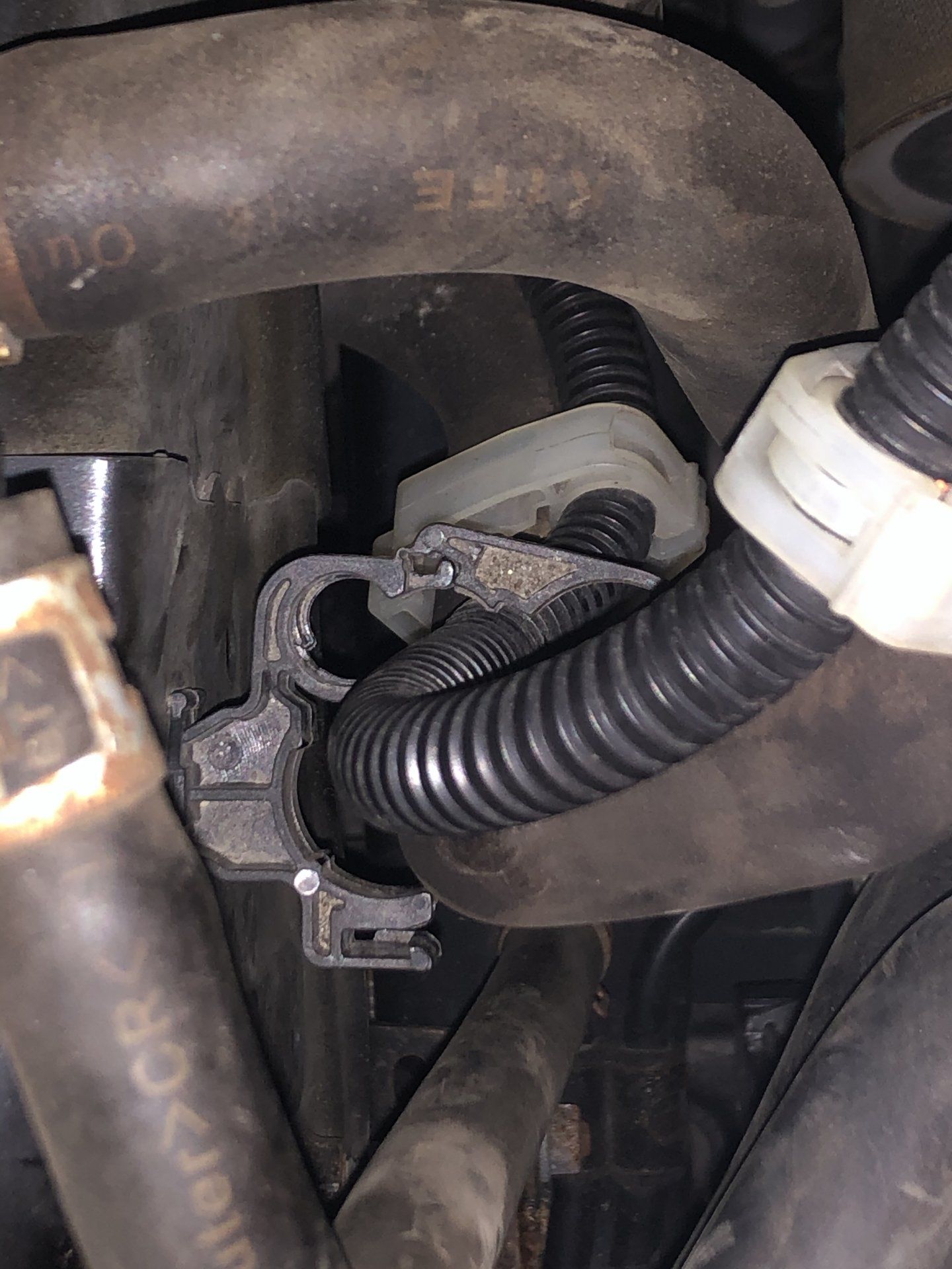

I certainly can't speak for others, but by unclipping the large cable bundle near the battery and shifting it to the side, I was able to slide the bolt forward enough to remove it, and replace it with a new one without taking out the battery. As they say YMMV.
