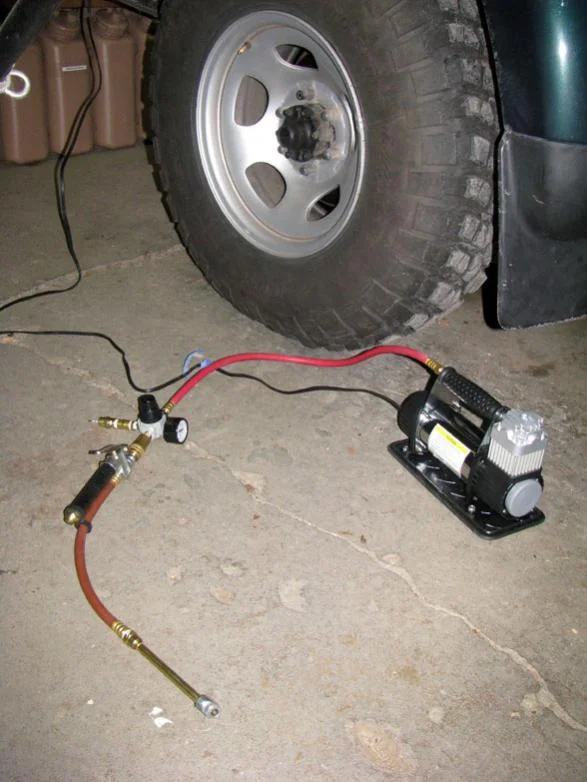

Lots of folks use Viair compressors. They make a nice one for around $200 complete with kit.
Then there is the HF knock-off, which is either very similar or identical, depending on who you ask. The differences some cited was in the quality of the accompanying kit, but the most important thing is the bag. On sale for $60 recently, I stripped the kit off (which some may do with the Viair's kit, too) and replaced it with new.
The coupler for the air hose was a tiny frail thing, as was the whip hose. I took em off and replaced with standard 1/4" components, upgraded the coil hose to the same, and added some plumbing. It all still fits in the supplied bag, making for a package that stows away neatly until needed.
The factory inflator is a bypass type that exhausts excess pressures from the system, since there is no storage tank. Instead, you need to make some provision for letting excess pressure out when not actually inflating or you risk damaging the pump. For my modded pump, I added a 125 psi Milton safety valve. It was the lowest pressure they had at the box store, I may go lower if I can find one. I also installed a small Milton regulator and a cheap HF pressure gauge. Works great, although I haven't timed it to see what it's capacity looks like in real world terms. These size compressors are generally considered the minimum needed if you're trying to air 33" tires. The ones in all-in-one packages are OK for passenger car tires and are indeed pretty feeble for the nominal size offroad tire.
I still need to get a lock-on air chuck for airing up after the trail (any recommendations out there?), but the inflator on it in the photo works great for topping up along the road.
