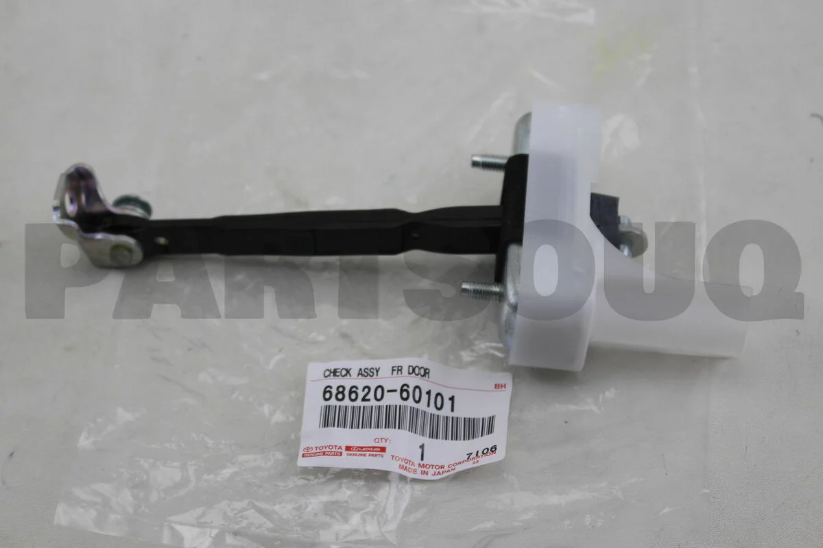

Replace your door check (i.e., limit strap). Mine went bad and exhibited the exact same symptoms as yours. Not a difficult job if you're somewhat handy. Remove door panel, remove speaker, secure door so it won't swing too far, remove door check, then reverse steps. Grease won't help, it's broken internally.
$78 with free shipping right now.

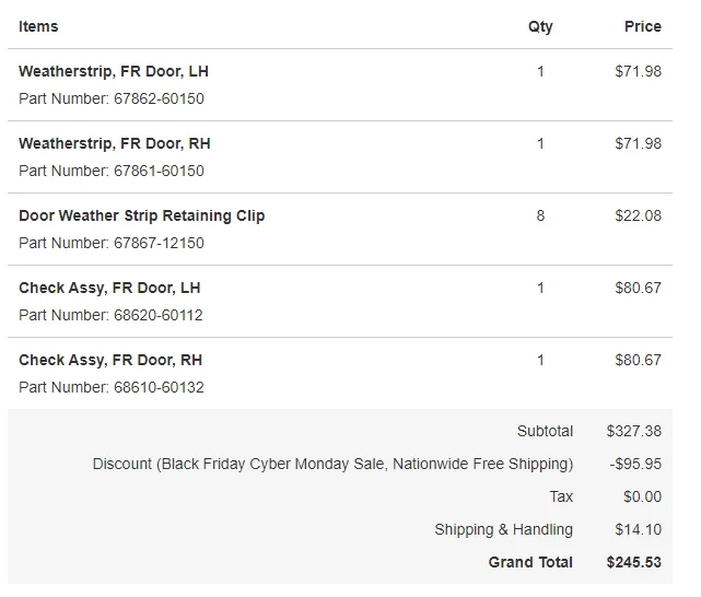

Ordered parts to resolve this and went with new front door seals as well. Ended up scoring massively by combining the black friday sale with Lewis Toyota of Topeka's usual discounts. For reference the door limit strap part numbers are below.
