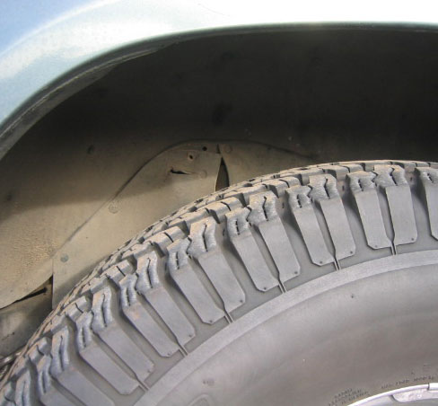

I did get some better views at the undercarriage though.
If it turns out that noise is just a flapping fenderwall thinger, I'm gonna be TEED OFF :mad: (and kinda relieved)
Is this pin supposed to stick out like that? :confused:
Hopefully the Truckwerks guys will have some info for me soon.
Don't think you have to worry about that flap making a noise. Mine is hanging like yours and I have no sounds.
it's not the flappythingy, and not the pin.
