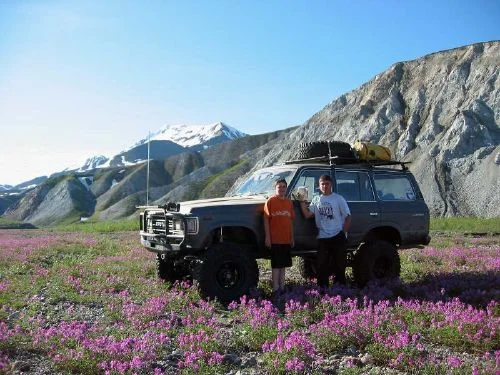

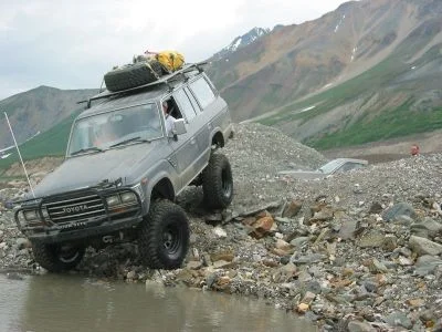

Here are a couple. Not really great pics for hight info but here ya go. SOA W/ OME 2.5 lift. SOA W/2.5 springs wil lNOT give you enough room for 39 boggers unless you get crazy with the saws all. You will prolly need a combo of things to make it work eg: lift springs, body lift and crazy saws all work. What engine are you going to run to turn those tires?

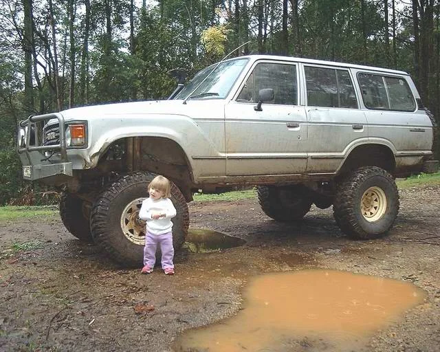

Here's mine before I lowered it by de-arching the springs. SOA with OME HD 2.5" lift kit. Really nice ride but a little too tall for me, especially when off-camber. In the pictures are 35x12.5 tires on 10" rims. You can fit 37's with this combination, but for 39's, you'll have to do some trimming, I agree. I'm not a fan of body lifts, but that may also get you a little extra height.

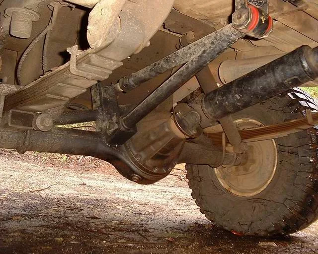

Here's another one that shows some of the rear clearance afforded by the big lift:

You really want to use flat springs for the best articulation, u can gain lift with longer shakles or liftblocks or betterstill longer springs.
38'S fit pretty easy on a spoa if done right, did somebody say they cut there fenders??
Not necessary.

He indicated that he wanted to run 39 boggers, that's why I said he would need a combo of lift springs, cut fenders and body lift.
As far as running 38's with trail gear? it can be done with narrow tires but not with 12.5" or 13.5" wide tires w/o help.

quick question: is your pinion getting enough lube? and are you getting a vibration with your pinion set up like that? seems like the u-joints would not vibrate each other out like they are suppose to?
Agree. Your pinion is pointed too high!! If you have a double-cardigan D-line, your pinion should be poinint directly at the t-case, aka parallel to the driveline.
I had my pinion rotated up too high and had to knock it back down. It was giving me a vibration and groan. Now its back to the stock postion with no vib or groan.

You can weld a second fill plug bung at a higher level on the cover to bring your lube level up. I have just parked on a bank next to the garage and over filled my diffs. A lot of lube seems to get thrown and slung around in ther so depending on the steepness of the pinion angle they seem to get lubed pretty well. I only have about 12,000 miles on my thirds with 4:88's but have not had any problems to date. Due to the amount of deep water crossings i do I change my lube very frequently so that may help too.
As far as the slip joint on the DS. I have double cardens at the TC front and rear, so my slip joint is down. If you dont have Double cardens then most people run the slip joint up, although some run it down, beleiving that it allows moisture to escape.
