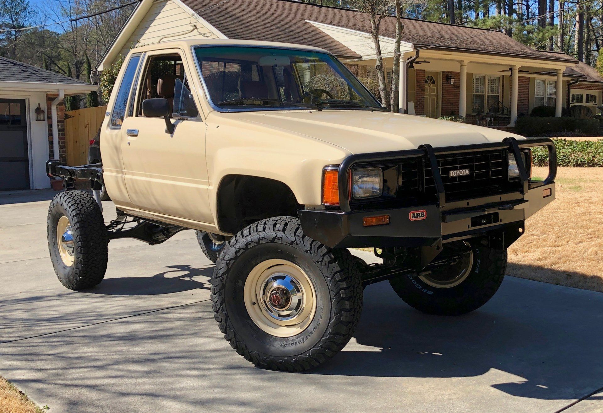

Bumper and lights yesterday. Really down to the bed now.

Looking great!
