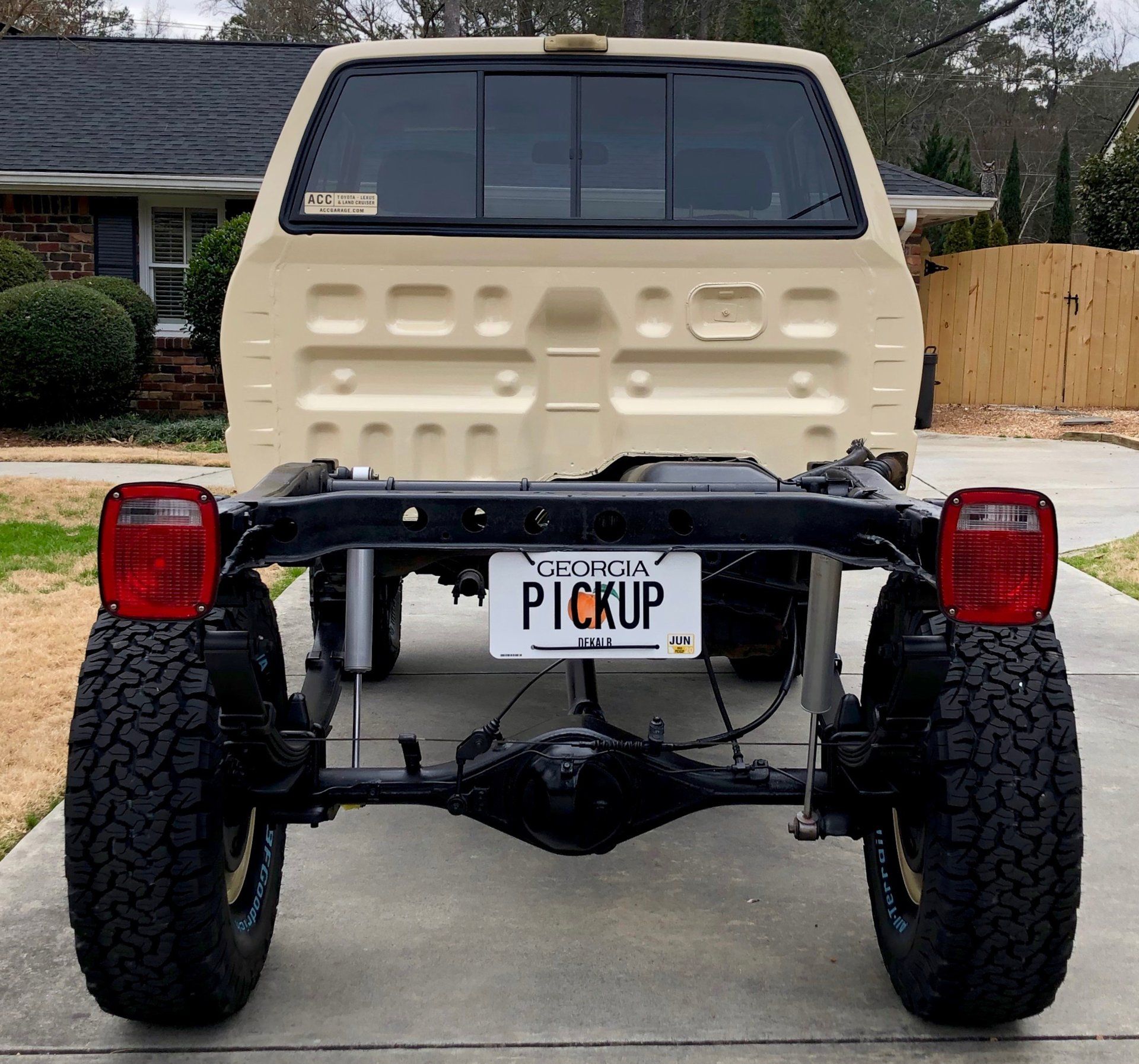

Build Picked up a Pickup

@toyotaboy80 that is awesome! I love that truck. Two questions: 1. You okay if I steal some ideas from that trayback? 2. Would you post or PM me a couple more shots - side profile. Thanks!

@Manhattan... can steal some ideas... I don't claim intellectual property of the flat deck ;) I'll PM you some photos soon.
