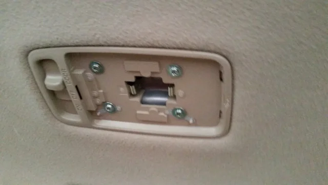

Mine looks like this...thus my confusion reigns surpreme as I can't see how that LED connector fits this...though I'm in a 2000 ...
take the panel with the adapter. Squeeze the ends of the adapter together insert into the hole in the middle there and then take off the backing tape and just press that over top of it. It will stick to the 4 screws. You can insert one end of the adapter in the hole push and insert then it will expand back out making contact with the other metal post. before you press the panel with the tape on check it comes on. you might have to connect the panel to the adapter I can't remember if it comes connected to the adapter or not
Ok, thanks, I appreciate the confirmation. I had a problem with that the first time and it could well be that one panel was bad, but it felt sort of awkward trying it so a) I could have done it wrong b) there were other issues involved. I'm going to give it another shot and I'll report back.

No problem... Also if it doesn't come on flip the connector and try the opposite way. I cant remember is that adapter is sensitive to the neg / pos
sides some of the LED bulbs are so if it doesn't work the first thing to do is generally flip them and try again.
