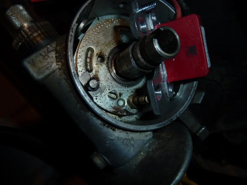

Ordered a Pertronix electronic ignition and tried to install it but I can't see how it will fit in the distributor. Seems to be the wrong part, I called Pertronix twice to verify the PN based on the distributor PN prior to placing the order, but as I say I can't see how this will install. The holes just don't line up.
Normally they utilize one screw and a pin to hold them in, kinda like the points. Rarely you will have to modify things. I think there is a problem with the application, unless heavy mods are req'd to install that particular model.
