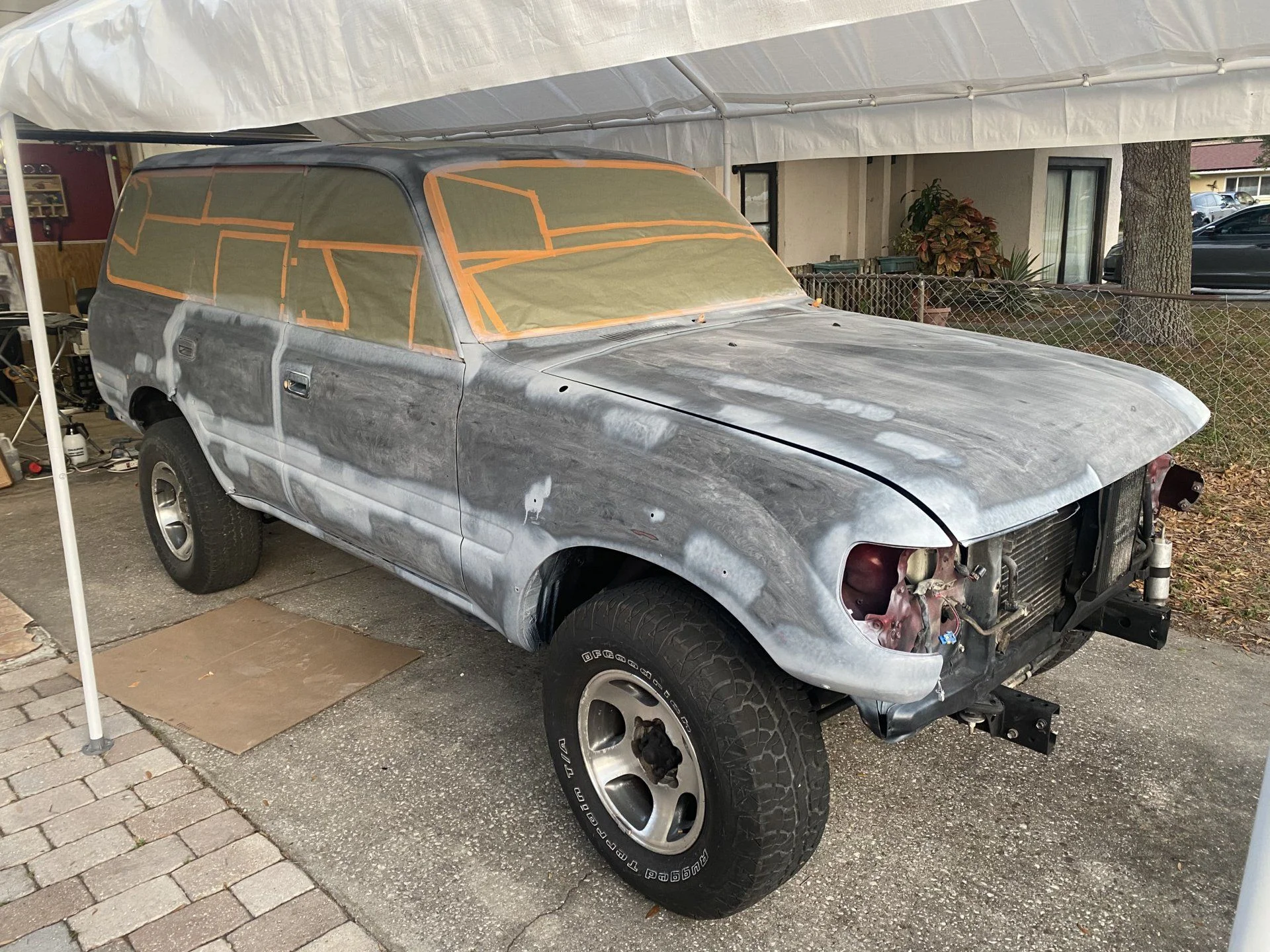

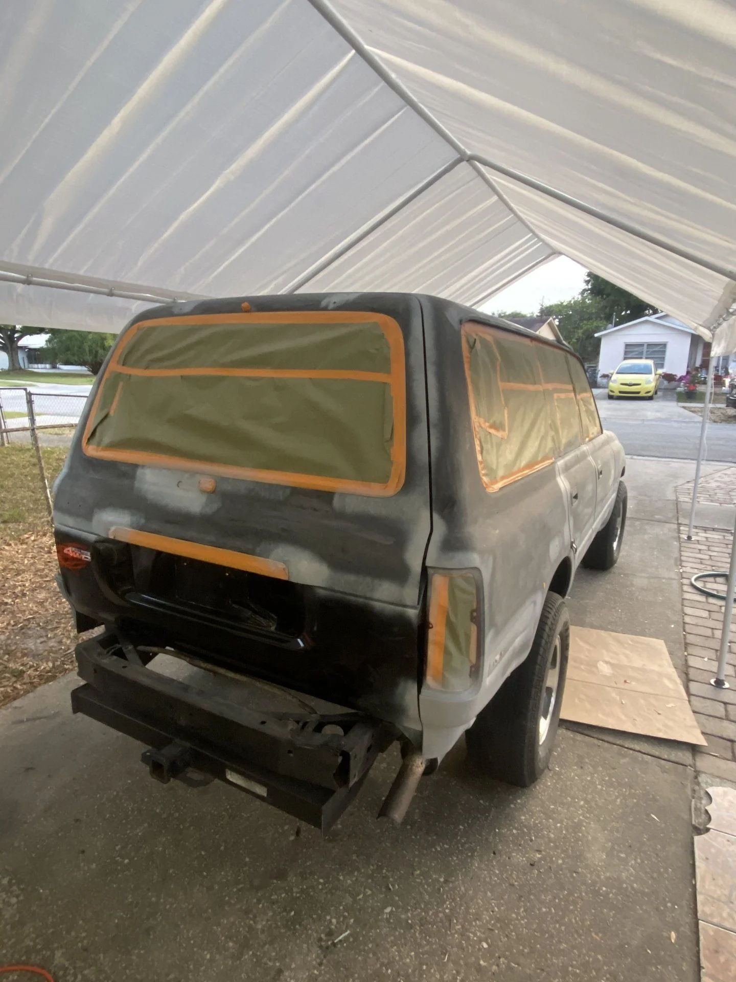

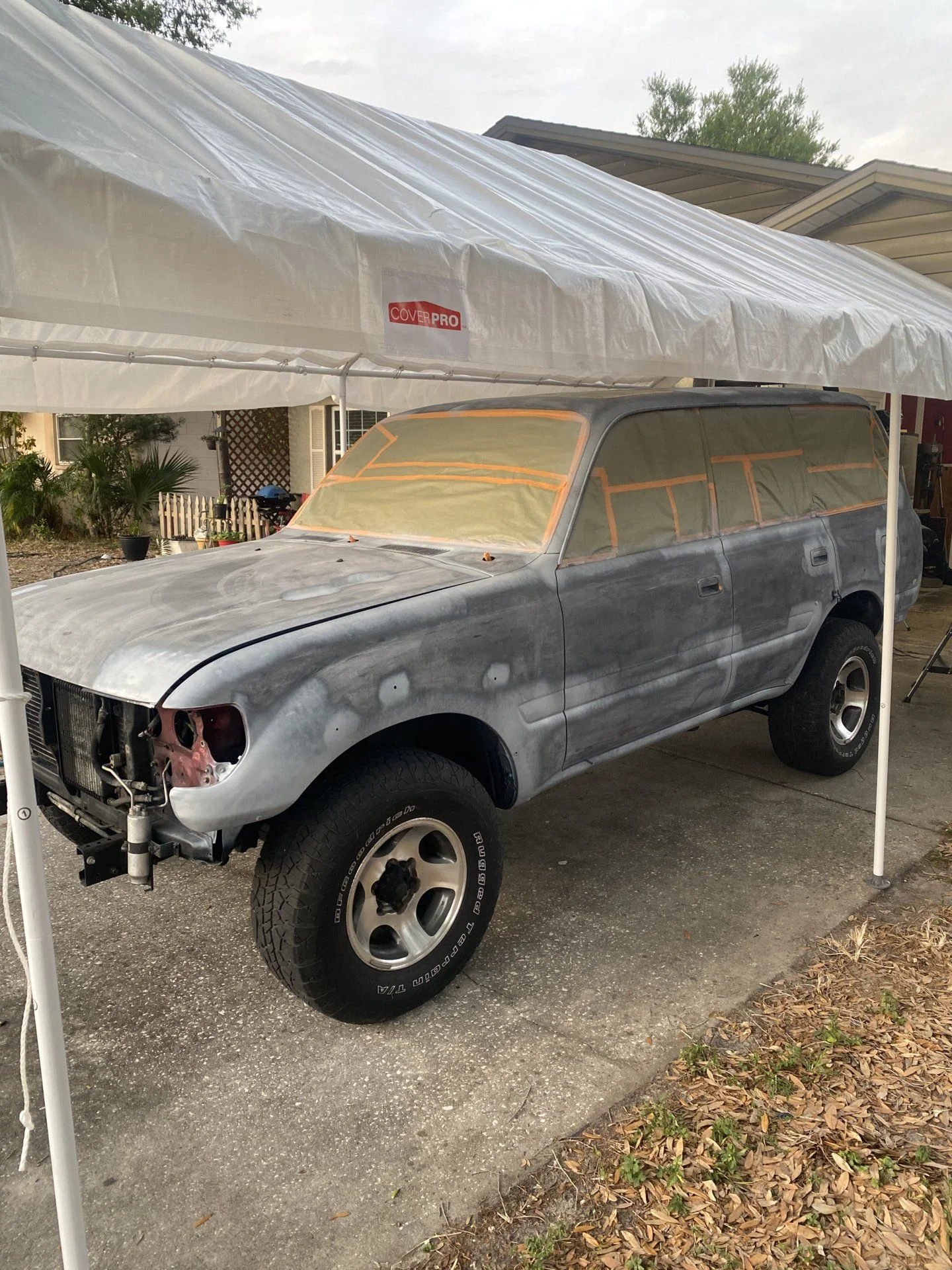

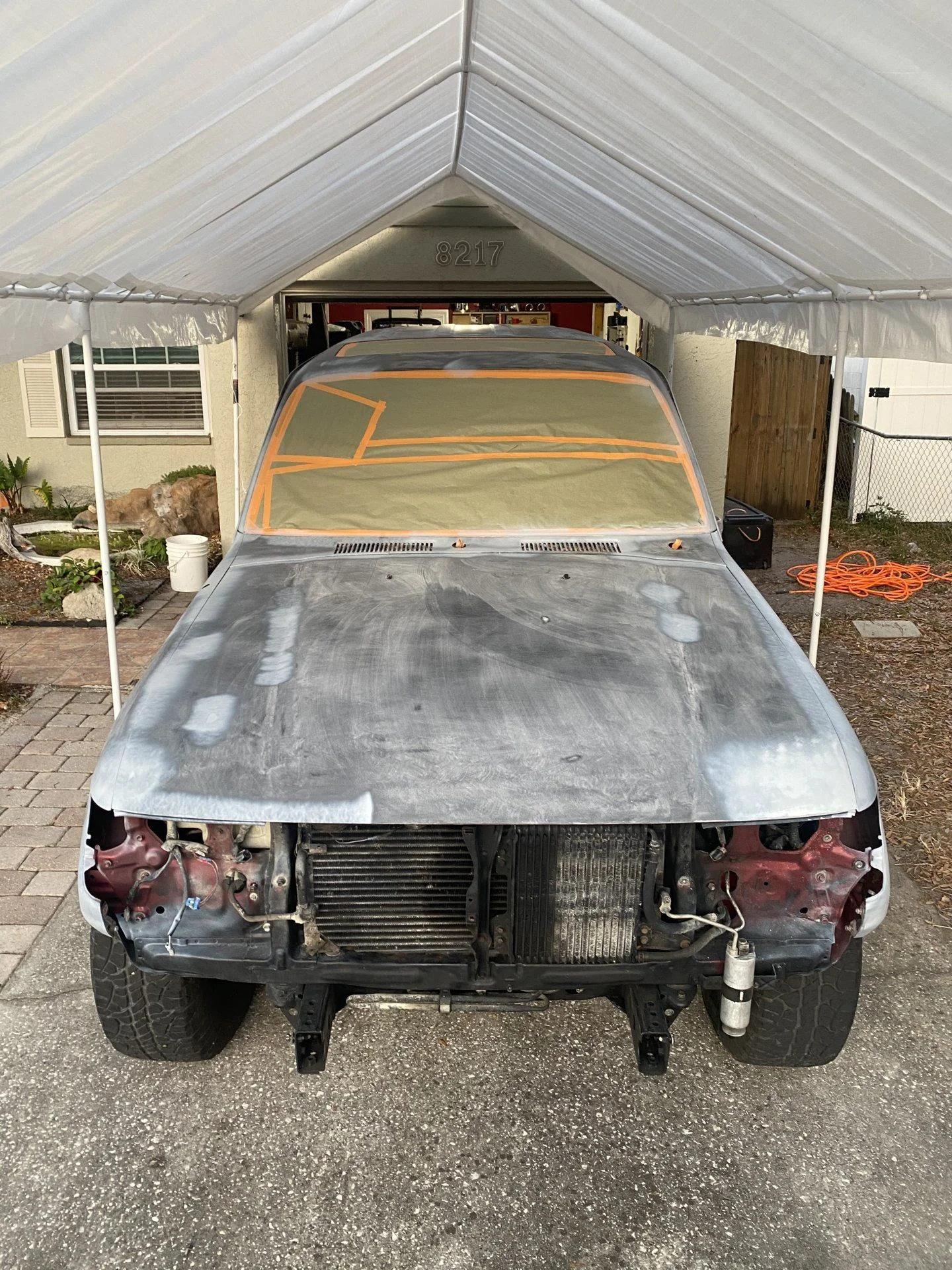

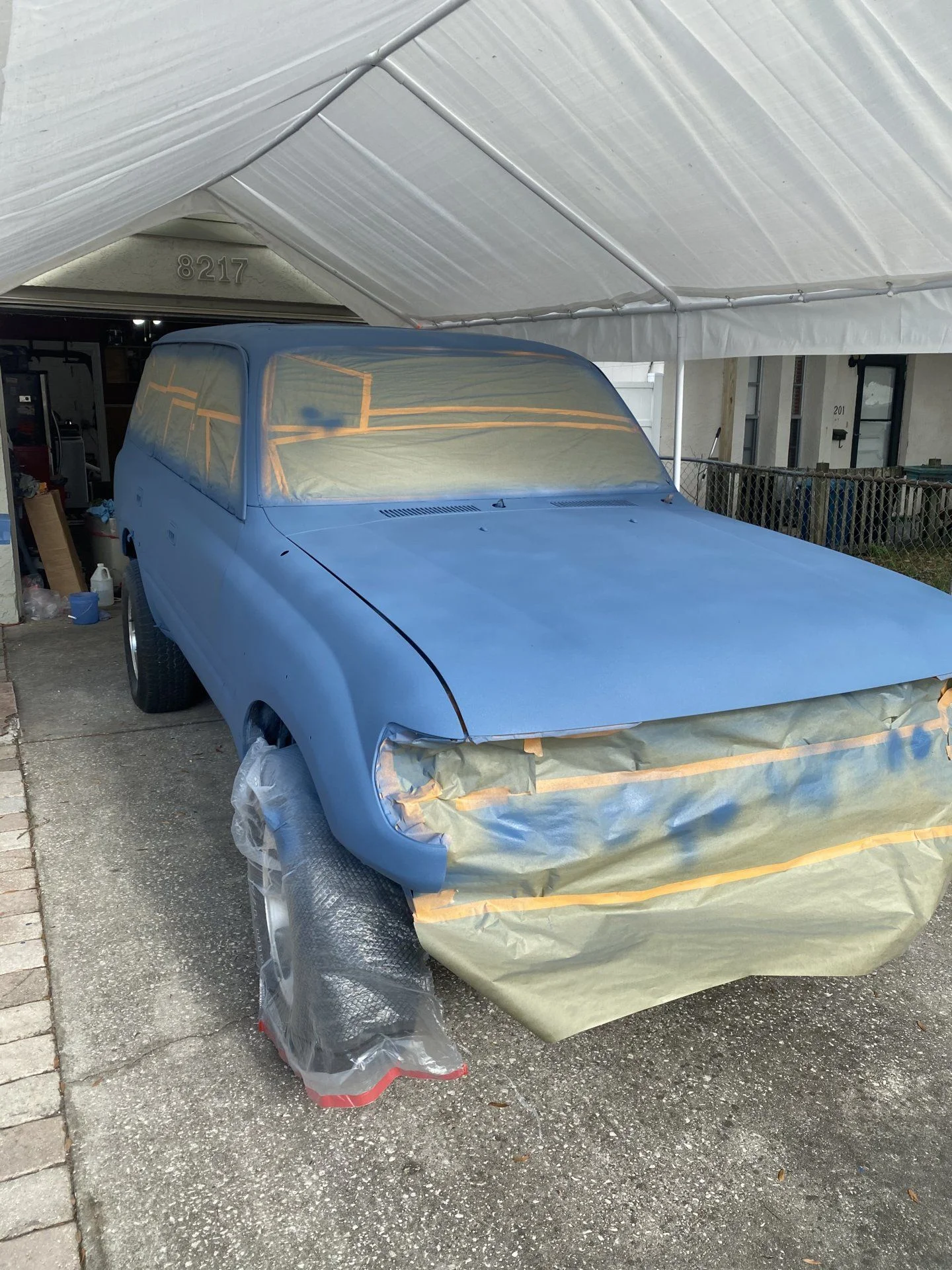

bought 94 fzj 80. have been taking a part got new paint on it working on stripping interior. So my question I’m asking. I found someone selling a 97 80 series. Cheap prize. mine needs some parts. So figure buying this a good idea considering what parts cost for this thing? In addition how much of interior can be swapped. Like dash and all? And help I’d appreciate be for I jump on it. The photos are of mine now
