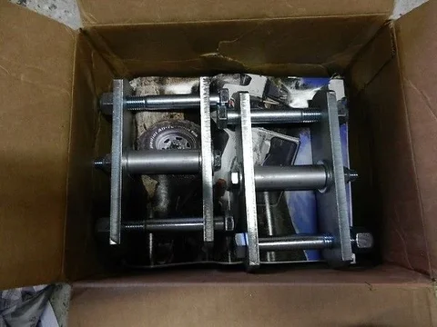

I have a couple questions on parts...before you tell me to search mud, I have...extensively. The questions below are what I have left after doing that. :) First, I need some help figuring out what brand these shackles are....I have searched online and looked all over them and they aren't stamped with any names. Does anyone recognize them?
My current shackles are too short (rubbing on the frame) but these are too long (recommendations on what I should sell them for too). Any recommendations on good brands of shackles? Greasable vs non-greasable? I need at most a 4 inch (bolt to bolt) size as I don't want much more lift than what I have already. I also need new bushings....good brands?

No idea on the shackles, if they are parts that came with the truck i'd suggest asking Brad
I sent him a msg but he is on an extended bike trip...thought I'd ask just to see if someone recognized them.

I think those shackles came from FJ parts - you should be able to sell for about 65 percent of the new price + or _ 10 percent if they are new or in excellent condition
http://www.fjparts.com/suspension-shackles-c-32_110.html

Also, I need some help on deciding which shackles to go with. There are a ton! My springs are HFS 4 inch. I also need bushings-will the size be different since I don't have stock springs and shackles or are bushings all the same 2 sizes?

Not sure on shackles but the bushings should all be the same.
Al. I do not think the HFS springs and the frame bushings are the same size. Besides all she needs are the frame bushings. 8 to be exact .

What do those shackles you have sitting there measure eye to eye ?

Darin, the shackles are 5 1/4 eye to eye, way bigger than those 4 inch ones you told me to stay at. Should I do greasable or no?

To me it does not make one to me greaseable or not. The newer trend is going that way though.
