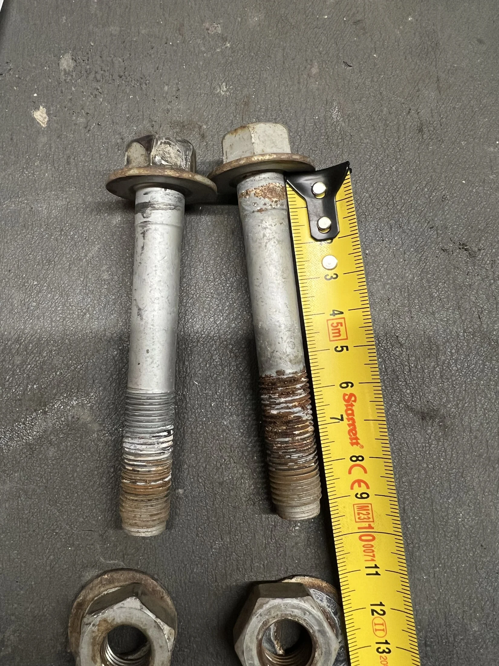

I am uninstalling a set of Trail Tailor rear lower control arm skids and returning to stock. I'm pretty sure the Trail Tailor skids came with their own hardware.
In my shop, I found a set of nut/bolts that might be what I removed from my stock 2016 200 series land cruiser.
I'm looking for verification so I can clean up and reuse these rather than buying new (and likely expensive) hardware.
What I found is M14x1.5 x 90-ish.
Do these seem like they might be 200 series rear lower control arm front nut and bolts?
I have had lots of Toyotas, so these could just as easily be something from a Tundra, Tacoma, 80 series, 100 series or earlier 200 series.
Thanks in advance!
Looks like the part numbers are: (For reference, it's the same parts for the upper and lower control arms on both ends of each)
90105-14186 - Bolt
90201-14035 - Washer
90170-14029 - Nut
From the picture it looks pretty similar. From Partsouq, about $6/side, and from USA Toyota dealers a little over $10 per side unless you catch it on 25% off sale.
I'd say from the part number the part is definitely m14x1.25. And possibly 86mm long? That's pretty close to your measured 90mm. Also, maybe the Toyota measured length doesn't count the centering guide at the end of the bolt. The guide posted on mud about decrypting bolt part numbers is difficult to understand. So, I could be reading too much into the part number.
Since it's the same part number on the upper control arms, you could pull one of those and compare to your bolt in hand.
