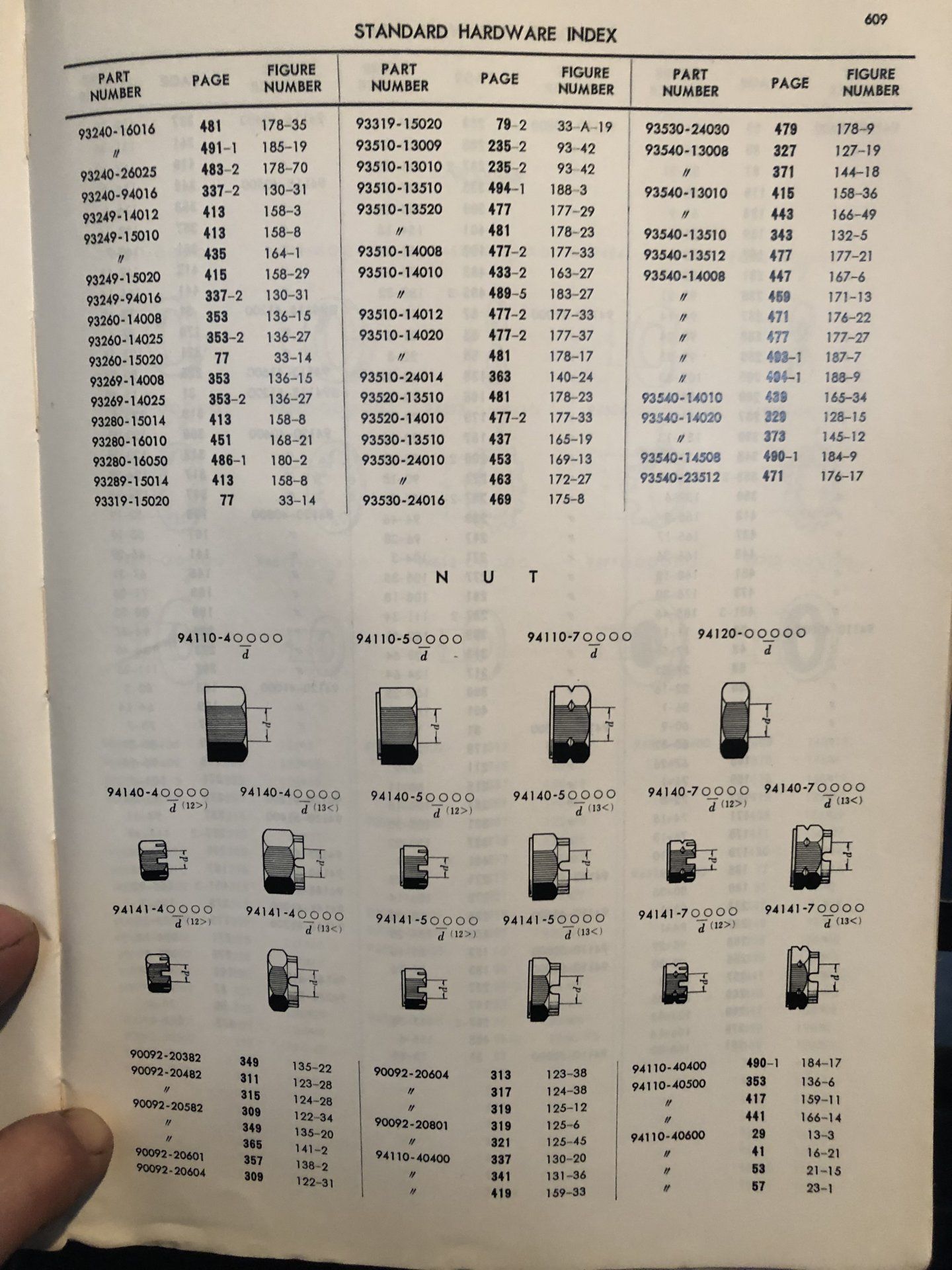

Did the pics of the bolt type pages from the manual get deleted or was it in another thread?
Jeez, glad I visited the 60 forum today, -that is info the 80 crowd is going to want at some point too, if not already having faced the certain NLA parts we have / 80 platform.
I’ll add them here as well.
