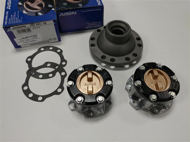

FWIW... AISIN's look a bit cleaner on an 80 :D
Cruiser Outfitters
Can you run those hubs with wheel spacers? I have the shi**y AVM hubs (waiting for one to explode) on now with 1.5" spacer on Tundra wheels.
Yes If the wheels clear the drive plate they will clear with hubs AVM or Aisin
