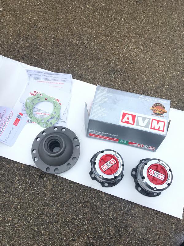

Another thing with the AVM's I noticed that the hub flange is iirc 2mm thinner than the factory one. I didn't realize this until after I stripped a handful of new oem studs.. So I run two washers and I still can't reach 26#tq on them as they have that 'feel' like the threads are about to let go.
Any input guys?
Get aisins. They aren't super expensive.
They've always been something I have planned on getting. I just wasn't sure if these were characteristics of being Part-timed or the cheap hubs.
I had no knowledge of AVM quality until I took them off my BJ40. They basically fell apart in my hand. Since AVM does come in a part time package from some places it does qualify for part time on the cheap. You can always find a set of used Aisin that can be rebuilt easily.
