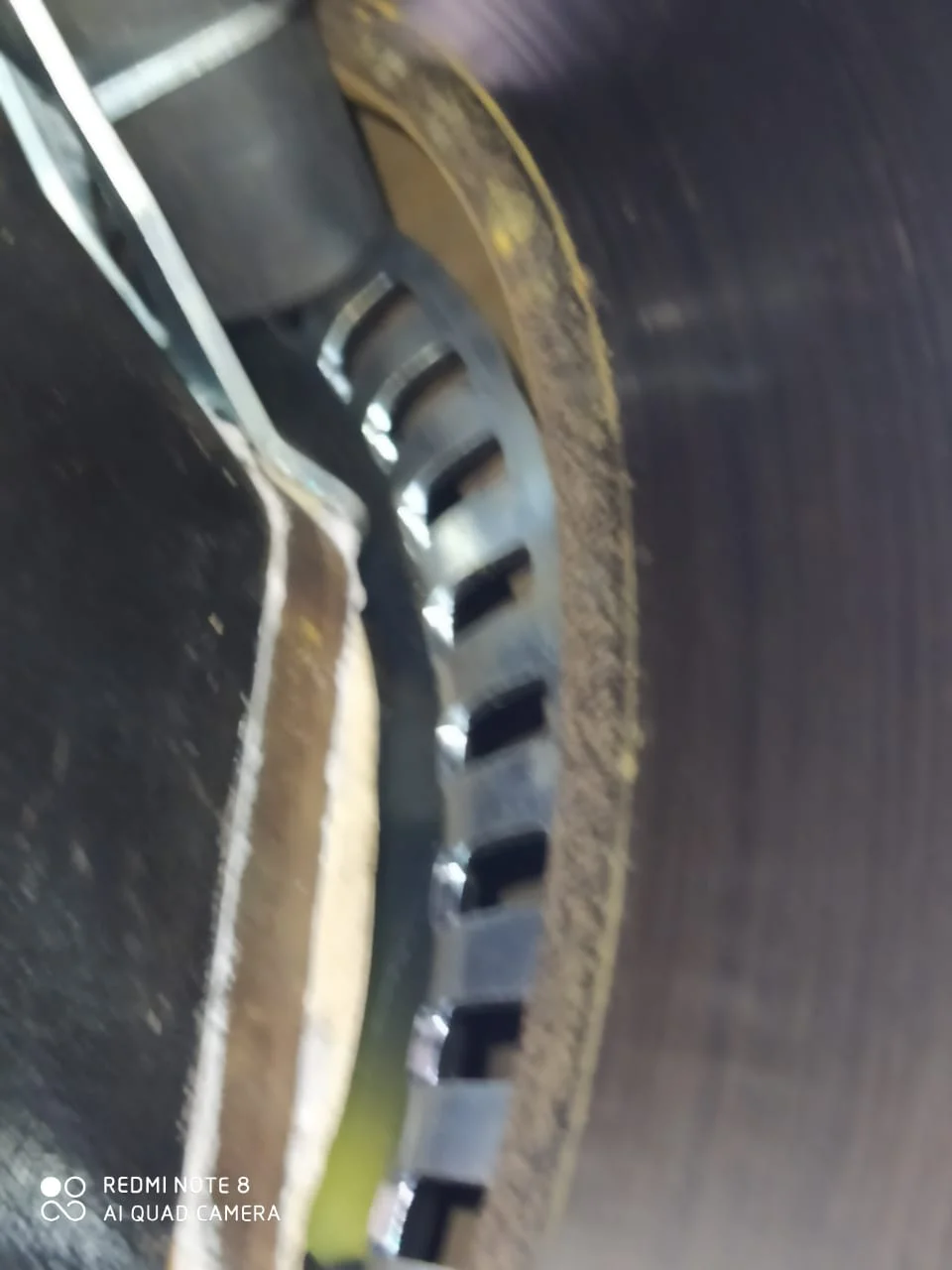

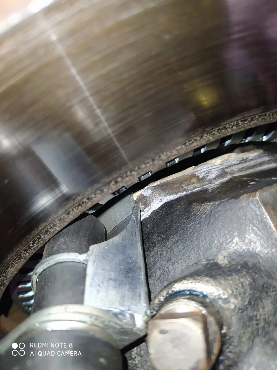

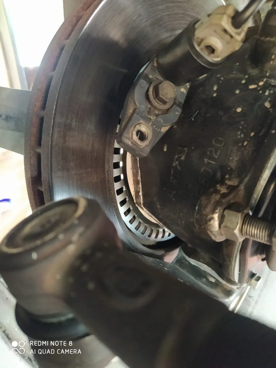

I got a 1998 HDJ80 with a part time conversion (H151F transmission with part time HF2A part time T-case), I wanted ABS back so installed the Marks 4wd ABS relocation kit... still got ABS light On and Speedometer stop working (it was working perfectly before ABS relocation, also tested the VSS on another 80, it's good).
any advice?
